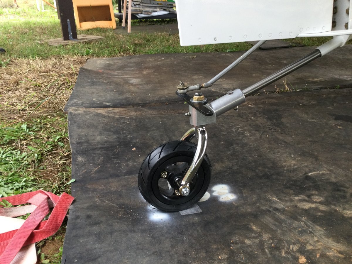

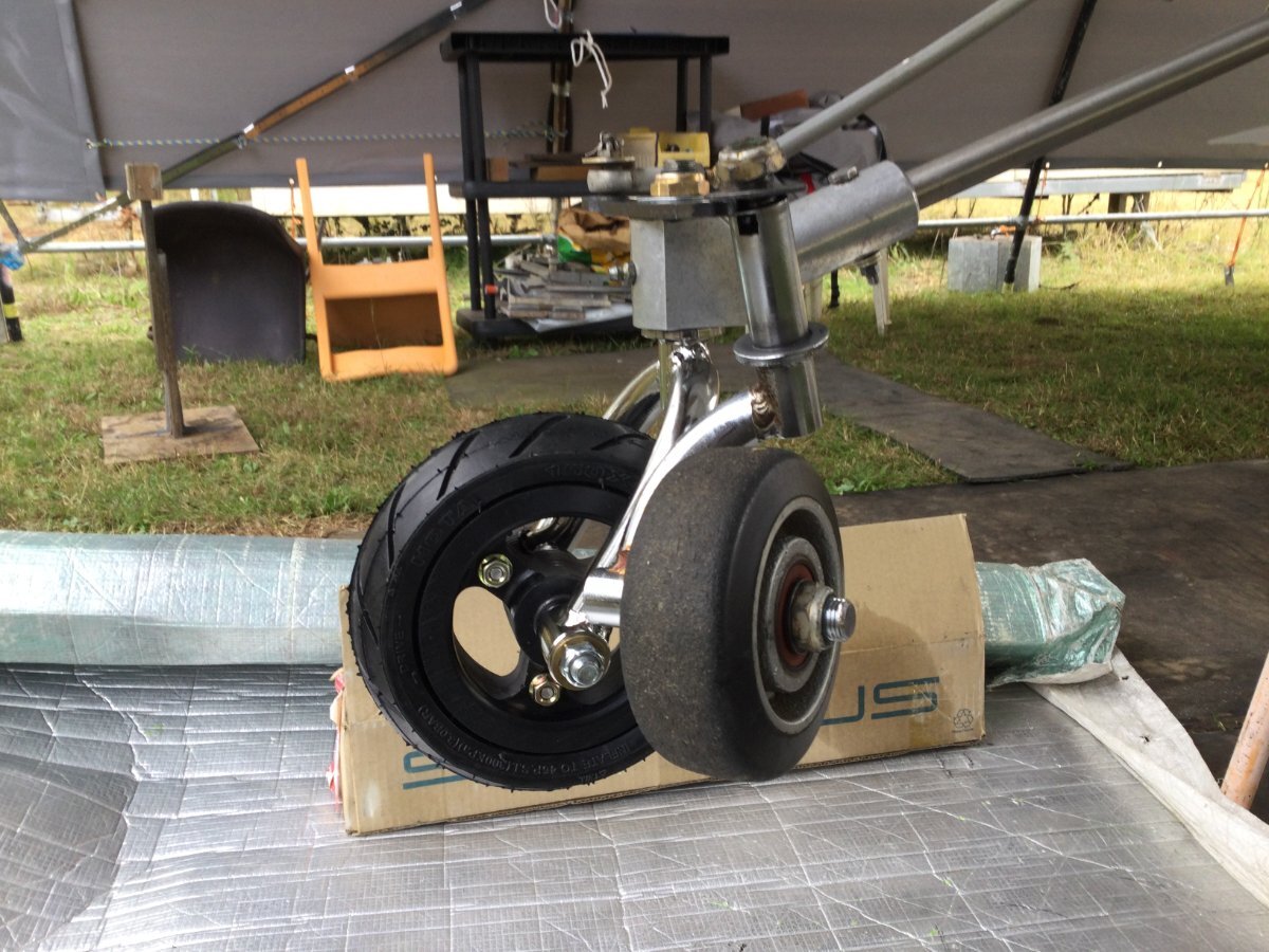

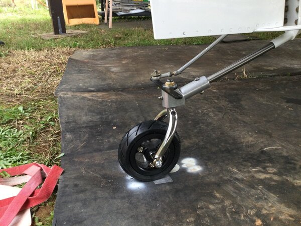

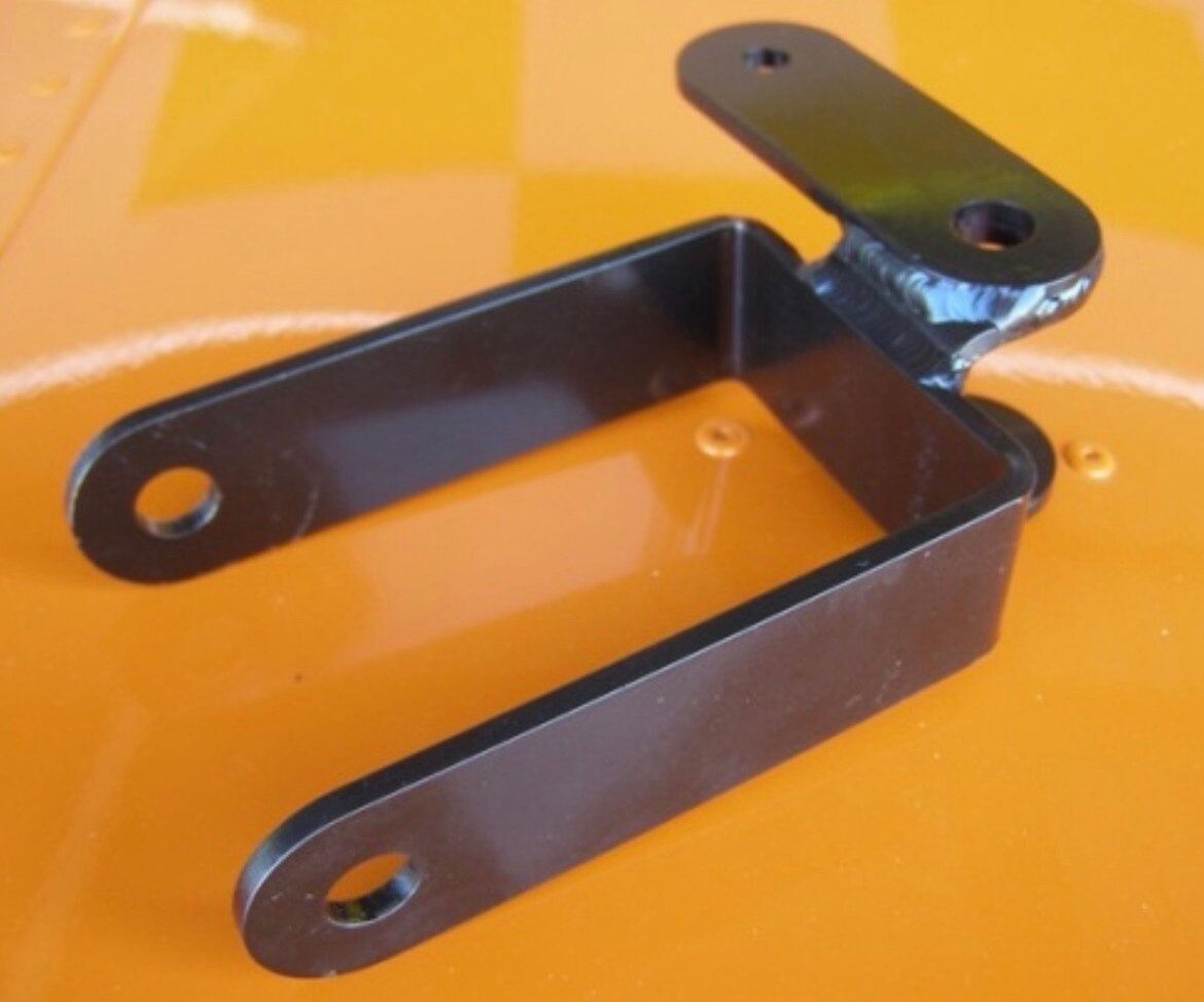

rodgerc Posted 12 hours ago Posted 12 hours ago I replaced the Sonex wheel with the Vans RV (solid) wheel and a bracket that was supplied by Kip Laurie (see photo) at the time. During building I had ditched the Sonex push-rod for an aluminium version with a couple of rod ends. The wheel and bracket swap had negligible impact on weight and moment. Peter Anson’s bracket has been subject to FEA and validated in application. 2
skippydiesel Posted 11 hours ago Author Posted 11 hours ago Thanks Rodgerc, My Sonex has a custom tail wheel "head" ie the API swiveling fork fits into it. The head is delivering the correct caster angle. This means that I am stuck with the API forks, the only alternative being replacing the whole" kit & caboodle" - expensive & unnecessary, as its only the tail wheel diameter that concerns me. Just done a rough estimate of 4'-6' weight - Seems likly that the an Anson wheel, mated to the API 6" fork, would be lighter than the current 4" API solid wheel/fork assembly. 😈 1
