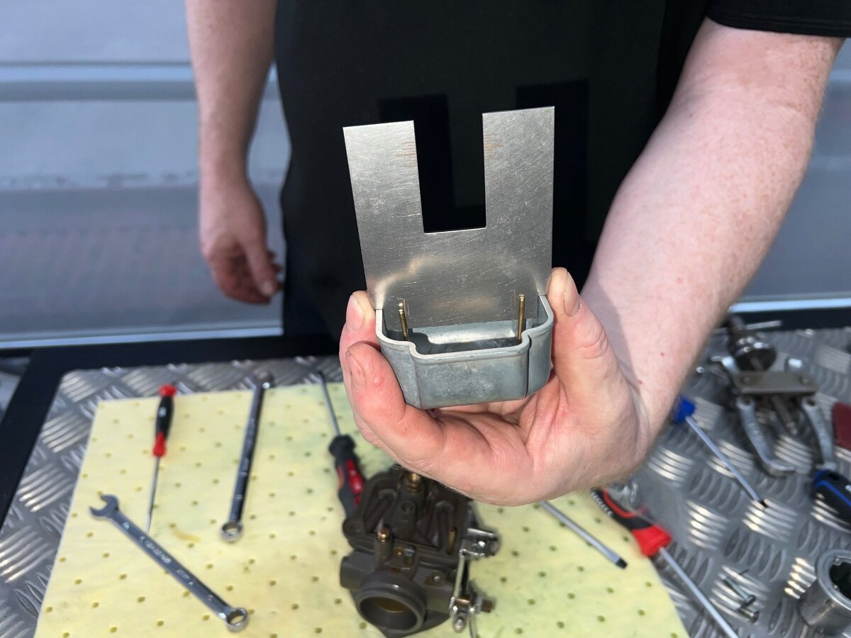

Blueadventures Posted 17 hours ago Author Posted 17 hours ago For info this is a gauge tool to check 914 carb bowl is not warped bent, showing pins ate vertical. 3 3
