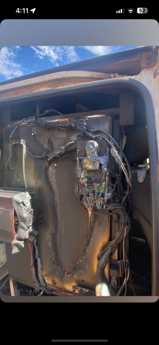

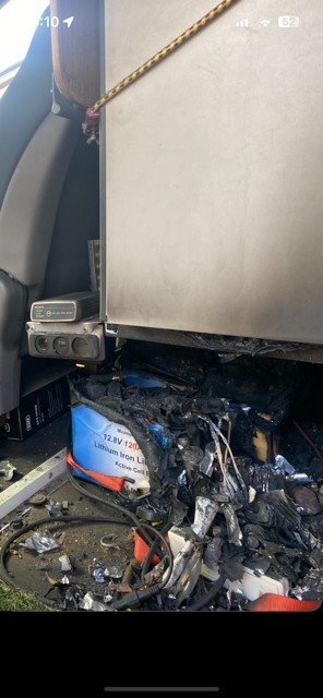

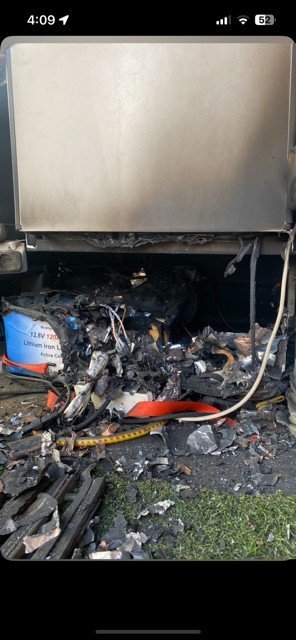

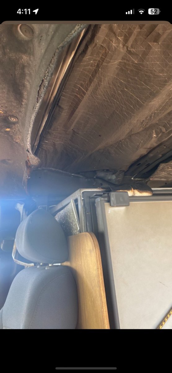

Moneybox Posted yesterday at 09:03 AM Posted yesterday at 09:03 AM I'm told these LiFePO4 batteries are as safe as they get. They don't come cheap but then what does when you are after quality? Luckily I wasn't flying along when this happened. This is my Hyundai camper. Fortunately it was parked and fully closed at the time so the fire could only exist until all the internal oxygen had been consumed. The tempered glass survived the inferno but not much inside did. There was virtually nothing close to the two Solar King batteries to support combustion but the intense heat reached to roof that has thermal insulation. Do you really want to share your confined space with these type of batteries when several thousand feet above the earth. Even your parachute may have gone up in the inferno. My camper had been parked outside the mechanical workshop near Wongan Hills for the last week. If I'd been sleeping in there I most likely wouldn't be discussing this now. 1 1 2

KRviator Posted 15 hours ago Posted 15 hours ago That's the first instance I've read or seen about a LiFePo4 battery having an issue. I used a Shorai successfully for several years in the RV and only replaced it with a SLA after not being able to get a lithium in Aus at the time - and am installing a pair of EarthX 1600's to replace the original (single) Concorde in the new project. Did the fire actually start within the battery? I ask as it the damage looks confined to only one end and it doesn't appear to have bulged outwards or anything suggesting it might have been a victim, not the cause of, the fire. 1 1
Thruster88 Posted 15 hours ago Posted 15 hours ago The earth X battery has two fire proof vent tubes that are plumbed to the out side of the aircraft. Moneybox, is it possible there was a fault in the wiring or solar regulator etc? Certified aircraft have a two piece master switch that disconnects the battery AND alternator from ALL wiring in the event of smoke in the cockpit. Sport aircraft, not so much. 2 1
Moneybox Posted 13 hours ago Author Posted 13 hours ago 2 hours ago, Thruster88 said: The earth X battery has two fire proof vent tubes that are plumbed to the out side of the aircraft. Moneybox, is it possible there was a fault in the wiring or solar regulator etc? Certified aircraft have a two piece master switch that disconnects the battery AND alternator from ALL wiring in the event of smoke in the cockpit. Sport aircraft, not so much. Yes quite possibly an electrical fault even though the vehicle had been stationary for a week but it’s the result that is more important.
Moneybox Posted 12 hours ago Author Posted 12 hours ago 2 hours ago, KRviator said: That's the first instance I've read or seen about a LiFePo4 battery having an issue. I used a Shorai successfully for several years in the RV and only replaced it with a SLA after not being able to get a lithium in Aus at the time - and am installing a pair of EarthX 1600's to replace the original (single) Concorde in the new project. Did the fire actually start within the battery? I ask as it the damage looks confined to only one end and it doesn't appear to have bulged outwards or anything suggesting it might have been a victim, not the cause of, the fire. I haven’t seen the vehicle yet but the only flammable item close is/was a portapotty and I doubt it exploded first. 1
