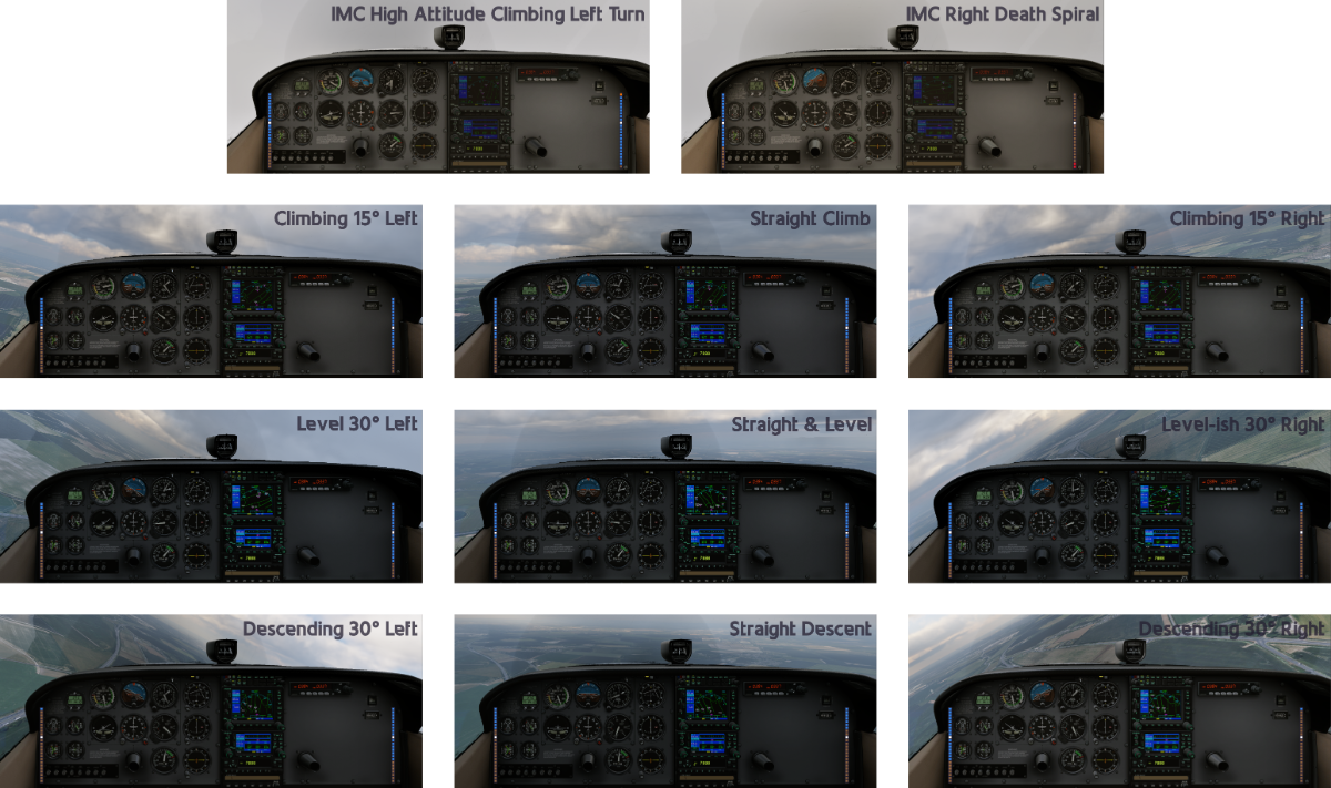

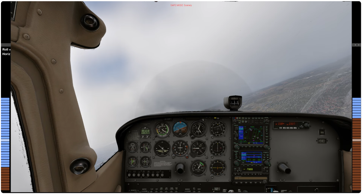

michaeljtbrooks Posted November 1 Posted November 1 Is this avionics idea actually worth pursuing or is it just daft? https://www.youtube.com/watch?v=PyHr998dvpo I'm a (fairly mediocre) student pilot learning to fly a C152 for fun, but I also tinker a lot with electronics. I'm surprised at the number of accident reports in GA each year where spatial disorientation was a primary factor (10-30 a year). That makes me think that there are many more close calls we don't know about. My background is in Medicine, so I'm aware that the most powerful sensory cue for humans to determine orientation is peripheral vision. Central vision (staring directly at the attitude indicator) needs some conscious processing for you to figure out attitude. I found some papers about research NASA did in the 1980s and 1990s which demonstrated that projecting a faint gyro-mounted laser line onto the instrument panel reduced spatial disorientation in IMC / night because pilots could see it in their peripheral vision. So I was thinking of prototyping a much cheaper equivalent using colour changing LEDs and a modern silicon gyro chip. You'd stick the strips vertically onto the left and right of your instrument panel, or onto the windscreen pillars, so it's subconsciously feeding you an impression of your attitude without you having to look directly at it. If someone was selling such a thing at a reasonable price, that helped prevent spatial disorientation and was easy to install, would you buy it? 1 3

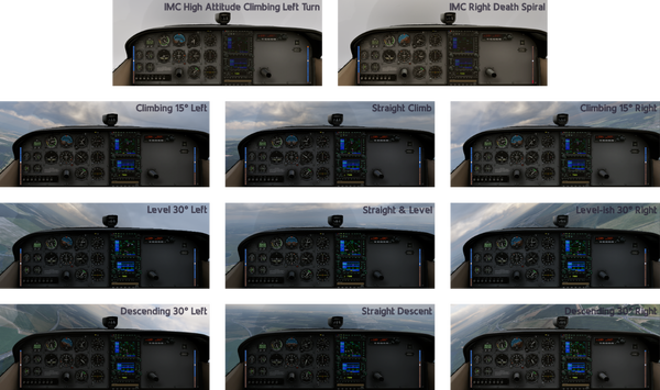

skippydiesel Posted November 1 Posted November 1 Hi Michael, Great idea - hope it works & can be applied. I thought that for the most part "peripheral vision" is unconscious. When I am flaring to land, I look straight ahead (conscious input) but am judging airspeed & position primarily by peripheral vision (unconscious). If this is true (???) then your orientation strips need to be much further apart - not in the main field of view, as illustrated😈 1 1
BurnieM Posted November 1 Posted November 1 (edited) This sim has an attitude indicator. Like all instruments you need to learn to use it. Why re-invent the wheel ? I believe in Australia we do only 2 hours on instruments for PPL. I was reading an article the other day that suggested you need 10 hours instrument practise to develop a basic understanding. Note this is not IFR training just keeping yourself alive in inadvertant VFR into IMC. Some would argue that getting into this circumstance is a failure of your VFR piloting skills. Edited November 1 by BurnieM 3

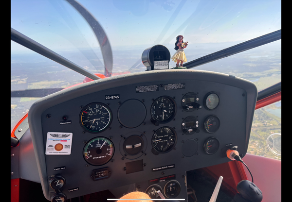

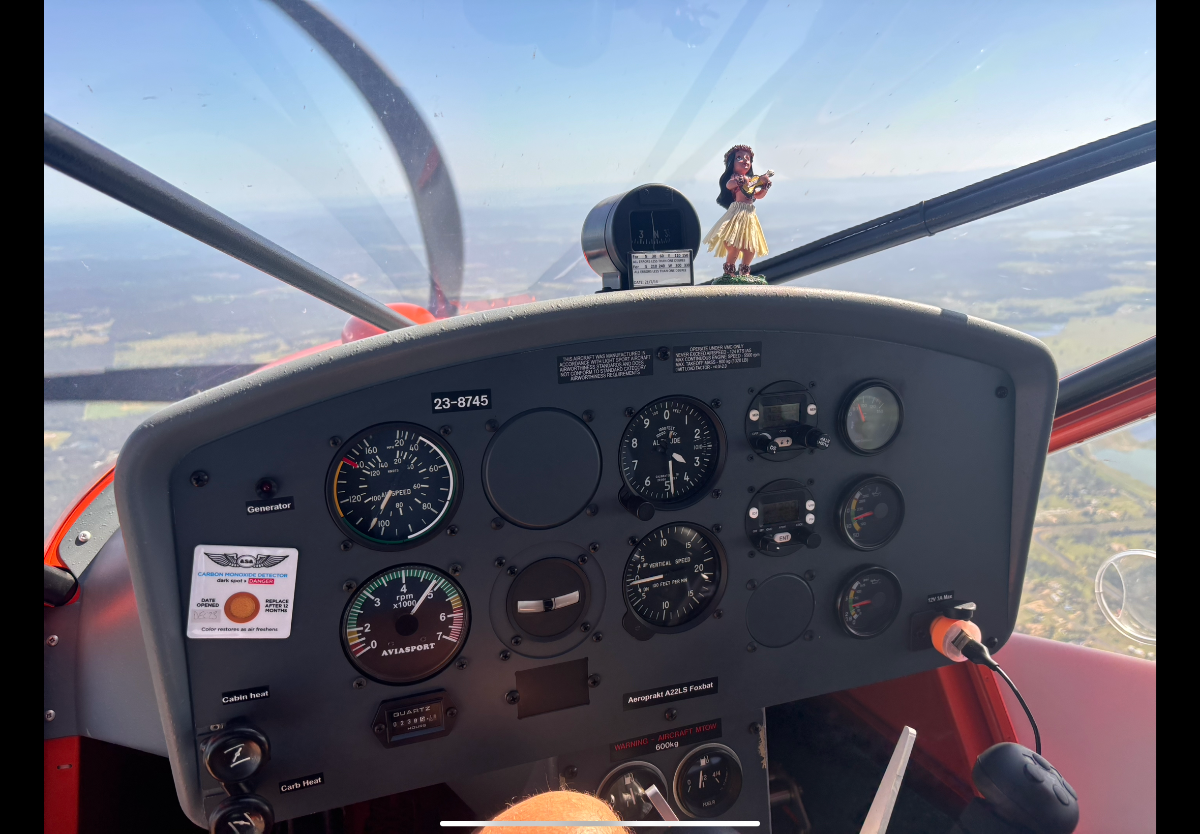

Bennyboy320 Posted November 2 Posted November 2 As a retired airline examiner & instrument rating examiner with over 18,000 hours I still can’t understand why this has to come up every few months, simple airmanship & a sense of self preservation should keep you on the ground during marginal VMC conditions or a diversion if airborne. This is my instrument panel which I deliberately chose when purchasing my Foxbat, not an attitude indicator insight. Continued flight in marginal conditions equates to a DEAD MAN WALKING. 8 1 3

onetrack Posted November 2 Posted November 2 Benny, please let us know the critical attitude information that the Hula girl provides? Is it all related to the level of skirt sway?? 😄 4 1
KRviator Posted November 2 Posted November 2 19 minutes ago, Bennyboy320 said: As a retired airline examiner & instrument rating examiner with over 18,000 hours I still can’t understand why this has to come up every few months, simple airmanship & a sense of self preservation should keep you on the ground during marginal VMC conditions or a diversion if airborne. This is my instrument panel which I deliberately chose when purchasing my Foxbat, not an attitude indicator insight. Continued flight in marginal conditions equates to a DEAD MAN WALKING. I agree, but people still get caught out. I would rather tip the odds in my favour where possible. I did an AFR a couple years ago and when the instructor asked "What would you do if you flew into cloud?" I pressed the CWS button on the stick, sat back, crossed my arms and said "That!"...then explained what I'd done and why. The autopilot can do a far better job than I ever could, we're wings level, and now I've got time to think rather than spending precious brainpower on keeping wings level in an unexpected situation. VFR into IMC continues to kill people year-on-year, no matter how much CAsA/FAA/instructors preach "stay on the ground", so anything that helps you survive if you're foolish enough to get caught is a good thing. 3 1

rgmwa Posted November 2 Posted November 2 (edited) 40 minutes ago, onetrack said: Benny, please let us know the critical attitude information that the Hula girl provides? Is it all related to the level of skirt sway?? 😄 When the skirt’s over her head the plane is upside down. Simple, but effective and requires no batteries or gyros. Edited November 2 by rgmwa 1 5 1
facthunter Posted November 2 Posted November 2 Wouldn't happen in a barrel roll or Loop. THAT is SO WRONG rgmwa. Nev 1
rgmwa Posted November 2 Posted November 2 I agree, Nev. But if it is over her head you might reliably conclude that all is not well. 5
michaeljtbrooks Posted November 2 Author Posted November 2 Thanks for the feedback on the idea, sounds like it might have legs so I'll move onto a physical prototype. I've noted the concerns about drift. There are a couple of 9-DoF PCB module packages which include magnetometers and are pretty drift resistant (e.g. BNO085). Cheap enough to give it a go and see how it stands up. For those asking "what's wrong with the primary attitude indicator": Nothing for what it was designed for (deducing roll and pitch when instrument scanning). The issue is that you have to be looking at it, and your brain doesn't automatically turn information presented to your fovea into orientation, it takes conscious processing to do that. Your brain can however turn signals from the peripheral vision into sense of orientation without conscious processing. So this idea is not intended to replace proper instrument scanning or to replace the AI, it's intended to project a sense of the horizon to the edges of your vision. An example use case of this is where someone diverts their gaze such as looking down at Foreflight on their iPad, or fiddling with the radios. They're more likely to ignore false vestibular cues and retain a sense of their orientation if there's something that looks like a horizon out the edge of their vision. In case anyone is concerned about the safety aspects of me building and testing this: I'm going to speak to one of the aero club's instrument rated instructors to see if he's game to try this out. I'd suggest he tests first in VFR then only if it feels ok test again in marginal VFR, then finally in IMC. I'll put in an easy to access "off" switch in case it proves to be a distraction or throws off incorrect cues. 6 1
