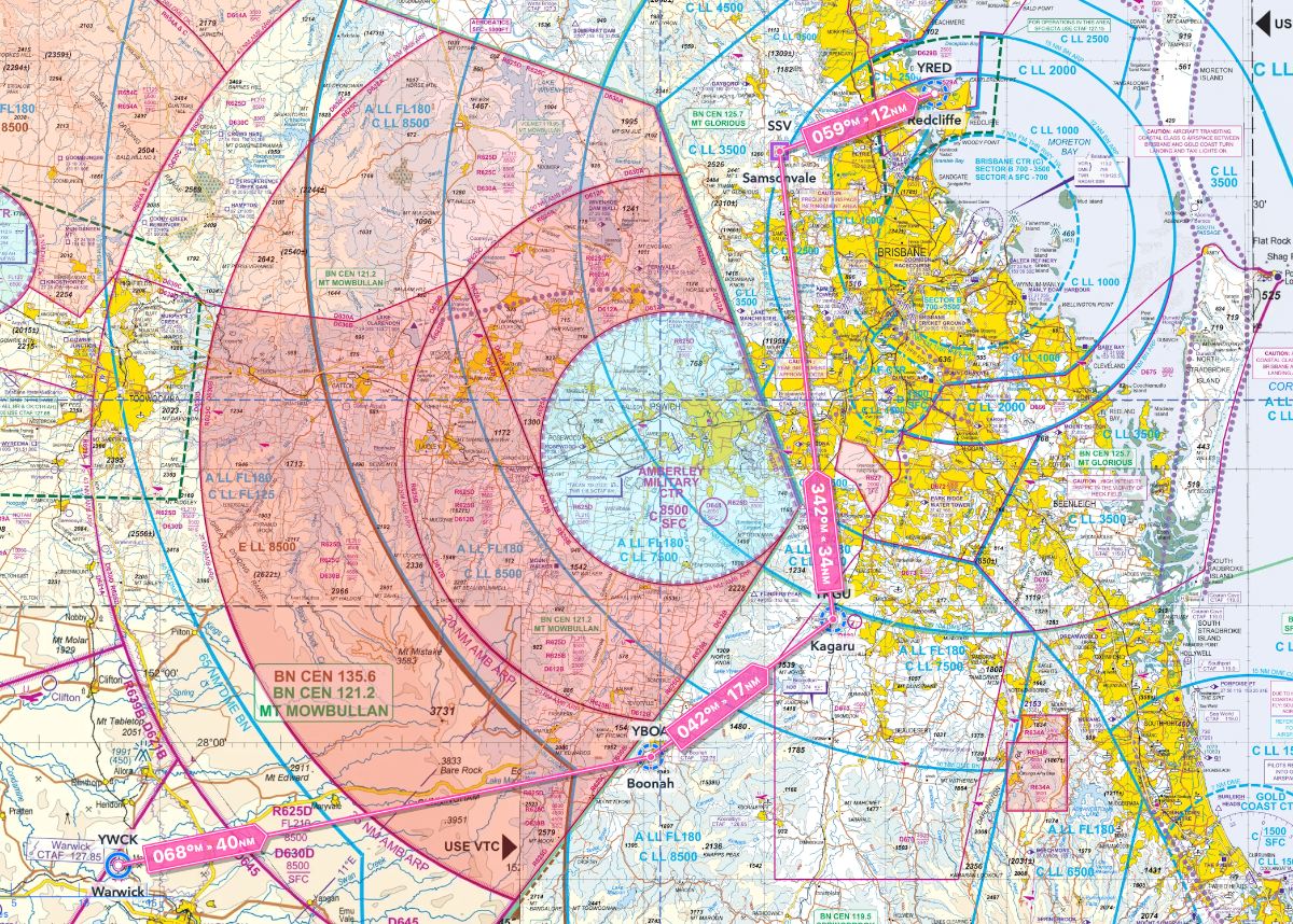

Garfly Posted 3 hours ago Posted 3 hours ago A route like this is often used between Warwick and Redcliffe; threading a path between Amberley and YBBN. CLICK FOR FULL REZ. 1
