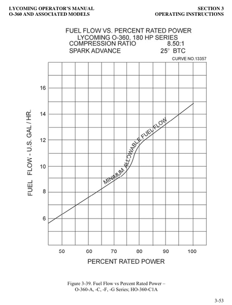

Lean of Peak is not the way to go if you want engine reliability in the long term. AVGAS has 2 Octane ratings  The higher One for  RICH and the Other for LEAN,  The  BIG radials ran on avgas 130-145.There's one as 100-130. I doubt these days you can get the Higher ones at all. All those motors will have to run De-Rated. ( with Less Boost).  The DC-6b Had an onboard Ignition analyser (under a hood) for the P&W R2800's for the Flight engineer to Monitor. The Constellation Often referred to as the Consternation and the Boeing strato Cruiser were Notorious for Engines being shut down in Flight. They were the Big Wrights which were  also fitted to the Neptunes. Nev
I fly at peak EGT, but always at  <= 70% of max fuel flow . Usually at 65% ~ 8.1 gph.
..chambers and valves look good. (mostly ULP98)
Lycoming have a chart. for lean, you need to stay below the kink , IE <= ~ 72%
many people fly peak EGT at 75%... probably the limit, especially if its hot..
