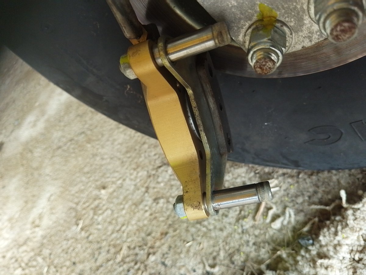

danny_galaga Posted June 16, 2025 Posted June 16, 2025 I figured the engine section is the best place to ask My plane has matco ph-8 disk brakes. The right one is getting much hotter than the left one. Have to add extra herbs after landing to taxi. And much harder to push back into the hangar. It looked a bit glazed, so I was hoping maybe it's suffering from a positive feedback loop whereby the more it overheats, the more glazed it becomes. The more glazed the hotter it gets. I took the caliper off, and de glazed with wet and dry and water. Also touched up the pads with wet and dry on a flat surface. The system is comically simple, and everything thing seems to moving. Pressing the brake pedal gently showed the piston moving. The caliper sliding thing slides. I'm at a loss! If I don't hear of any easier things to try by tomorrow, I'll swap left caliper for right (they are symmetrical) and see if the problem follows it.

danny_galaga Posted June 18, 2025 Author Posted June 18, 2025 solved! I think 😄 Another pilot in the hangar asked what the grease on the sliding pins on the caliper looked like. But when I took the right one off a few days ago it was clean as a whistle and I just assumed that's how they are. But I shouldn't be surprised with this kit. He said any similar brakes he's ever worked on always had a thin smear of grease. I happened to have some anti seize grease which seems ideal for this job. Did both calipers. Two landings and a taxi back to the hangar gave me a much more respectable 35 ish degrees, both brakes with ambient of about 18° Will try the park brake tomorrow. I wanted to keep potential multiple issues separate.
skippydiesel Posted June 18, 2025 Posted June 18, 2025 Grease & brakes are not usually compatible - always a first time. If going down the slipy track, I suggest using a high temperature lubricant, like graphite, rather than an oil based lubricant.😈
BrendAn Posted June 18, 2025 Posted June 18, 2025 1 hour ago, danny_galaga said: solved! I think 😄 Another pilot in the hangar asked what the grease on the sliding pins on the caliper looked like. But when I took the right one off a few days ago it was clean as a whistle and I just assumed that's how they are. But I shouldn't be surprised with this kit. He said any similar brakes he's ever worked on always had a thin smear of grease. I happened to have some anti seize grease which seems ideal for this job. Did both calipers. Two landings and a taxi back to the hangar gave me a much more respectable 35 ish degrees, both brakes with ambient of about 18° Will try the park brake tomorrow. I wanted to keep potential multiple issues separate. you threw us off at the start when u said the calipers were sliding ok. antisieze is fine. it has a high temp tolerance . 2
