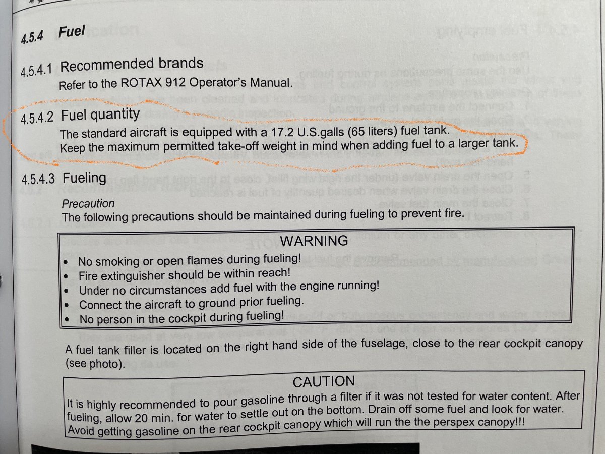

Moneybox Posted February 10, 2025 Posted February 10, 2025 Interpret this as you wish. I take this as allowing me to install a larger tank as long as I alter the load W&B label as instructed elsewhere in the manual.
skippydiesel Posted February 10, 2025 Posted February 10, 2025 While its important you understand the principal, the main objective is passing your exam - don't start introducing variables, like altering the empty W&B. KISS principal! As far as 4.5.2.2 goes - likly a poor Czech to English interpretation OR a larger fuel tank was/is an optional order. As for installing adjustable position load rails, no need, KISS again - Know your Max weight for the location, weigh the stuff, heavy items as far forward in the baggage area as you can (if no passenger, on that seat), lighter stuff aft. When you have your Certificate, you can then ponder W&B loading 😈 1

rgmwa Posted February 10, 2025 Posted February 10, 2025 1 hour ago, Moneybox said: Interpret this as you wish. I take this as allowing me to install a larger tank as long as I alter the load W&B label as instructed elsewhere in the manual. I think they mean make sure the total weight doesn't exceed 600 kg MTOW (for LSA), but obviously also keep the C of G within the acceptable range. They could have worded it better.
Moneybox Posted February 10, 2025 Posted February 10, 2025 33 minutes ago, rgmwa said: I think they mean make sure the total weight doesn't exceed 600 kg MTOW (for LSA), but obviously also keep the C of G within the acceptable range. They could have worded it better. Maybe but why mention adding fuel to a larger tank if that option doesn't exist? 1

rgmwa Posted February 10, 2025 Posted February 10, 2025 1 hour ago, Moneybox said: Maybe but why mention adding fuel to a larger tank if that option doesn't exist? The option for adding more fuel exists. As I read it, all they are saying is keep everything within the weight (and balance) limits. 1 1
Blueadventures Posted February 10, 2025 Posted February 10, 2025 3 hours ago, Moneybox said: Interpret this as you wish. I take this as allowing me to install a larger tank as long as I alter the load W&B label as instructed elsewhere in the manual. Looks like there was an option for a larger factory tank and the document was a general print version. Maybe worth contacting an agent or factory in Europe and they may have details of your aircraft build. 1
djpacro Posted February 10, 2025 Posted February 10, 2025 1 hour ago, Moneybox said: Maybe but why mention adding fuel to a larger tank if that option doesn't exist? Perhaps there is a factory option and an associated flight manual supplement? I believe that you have a 24 series registration "FACTORY BUILT TYPE ACCEPTED 95.55" which obliges you to follow specific rules about any modifications to the aeroplane OR .... not.

Red Posted February 10, 2025 Posted February 10, 2025 Just now, Red said: Not necessarily, there are different specs in different countries and even between models and years. It also comes down to your regulations, for instance in the UK the difference between a factory Eurostar microlight and Light aircraft previously came down to whether or not a backup electric fuel pump is fitted (the weight was that close. You need to contact whoever oversees airworthiness regulation and the aircraft maker.
Moneybox Posted February 10, 2025 Posted February 10, 2025 5 hours ago, djpacro said: Perhaps there is a factory option and an associated flight manual supplement? I believe that you have a 24 series registration "FACTORY BUILT TYPE ACCEPTED 95.55" which obliges you to follow specific rules about any modifications to the aeroplane OR .... not. Yes that’s true however in the service manual for this particular aircraft it gives me instructions to reweigh the plane after any additional weight or accessories are fitted. Then it says I should reprint and fix a new W&B placard. From my point of view it’s saying, go ahead and do it but do it right.
Red Posted February 10, 2025 Posted February 10, 2025 That doesnt mean put as much weight in as you want as long as you weigh it and stick a placard up, obviously it has a ZFW and MTOW that must be adhered to 1
djpacro Posted February 10, 2025 Posted February 10, 2025 6 hours ago, Moneybox said: .... any additional weight or accessories are fitted. .... From my point of view it’s saying, go ahead and do it but do it right. and doing "it", the approval of a change, "right" for a "factory built type accepted" aircraft, especially an LSA is where all the work is 1
Moneybox Posted February 10, 2025 Posted February 10, 2025 3 hours ago, Red said: That doesnt mean put as much weight in as you want as long as you weigh it and stick a placard up, obviously it has a ZFW and MTOW that must be adhered to How I love acronyms This is the first time I’ve heard of Zero Fuel Weight. Yes of course these weights a balances apply but it appears to me that the written data supplied with the plane gives some latitude for alterations to be made while still staying within legal limits. As I stated earlier this plane is going to registration unmodified however if I need more fuel to cover the cover the long distances between airports out here it looks like the option might be there to add it. The same plane, same fuselage, engine and control surfaces is carrying twice the fuel in later models however the MTOW is up from 550kg to 600kg.

BurnieM Posted February 10, 2025 Posted February 10, 2025 As a factory built aircraft would the factory approve an increase in the size of the single tank ? Possibly they would approve the wing tanks if you fitted the later model wings but now the cost is getting right up there. Looks like you can carry fuel in portable tanks/cans as long as it is non-commercial and no passengers. Not suggesting this is a good idea. Anybody care to comment. 1
