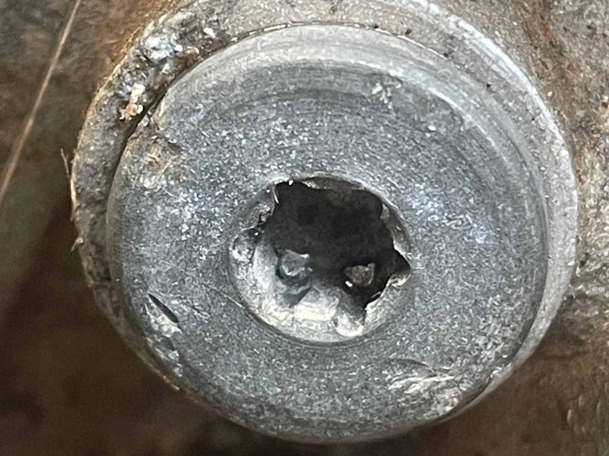

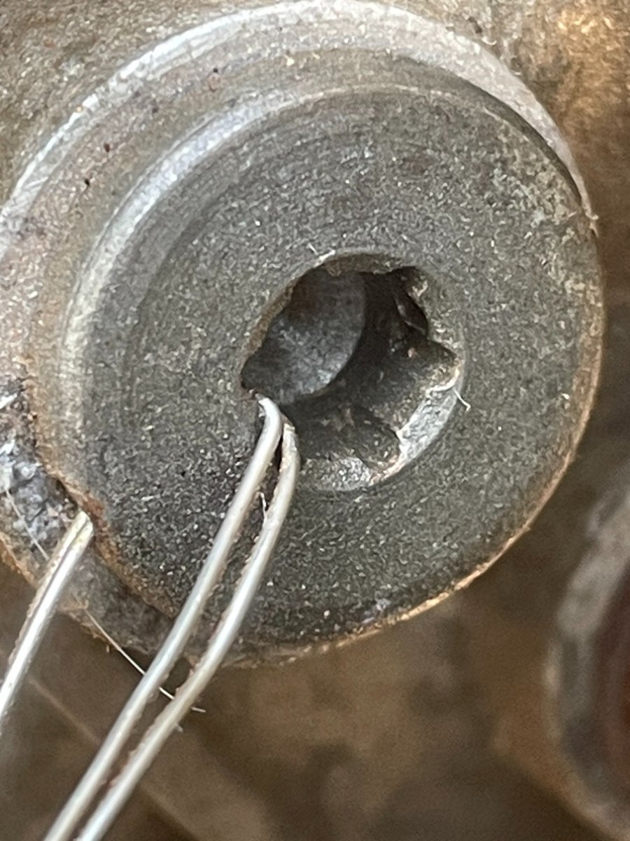

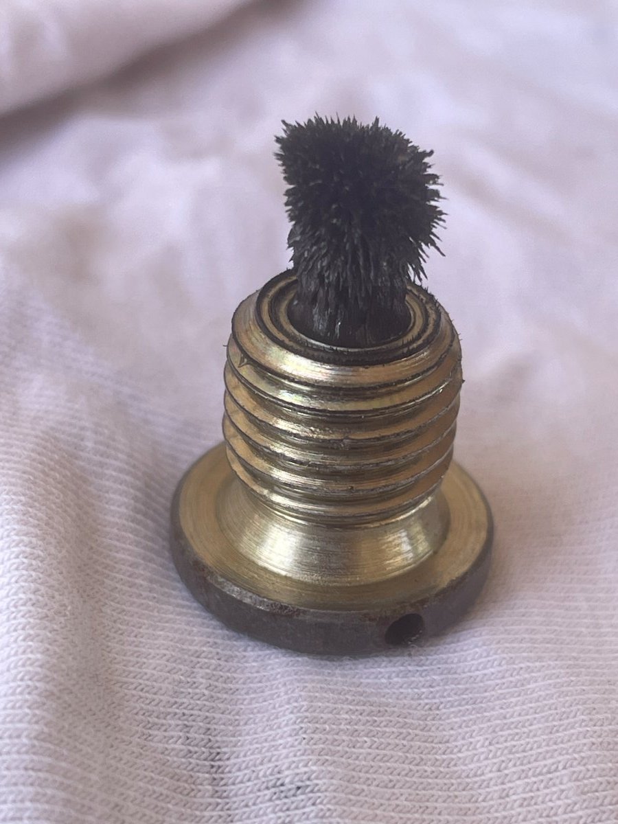

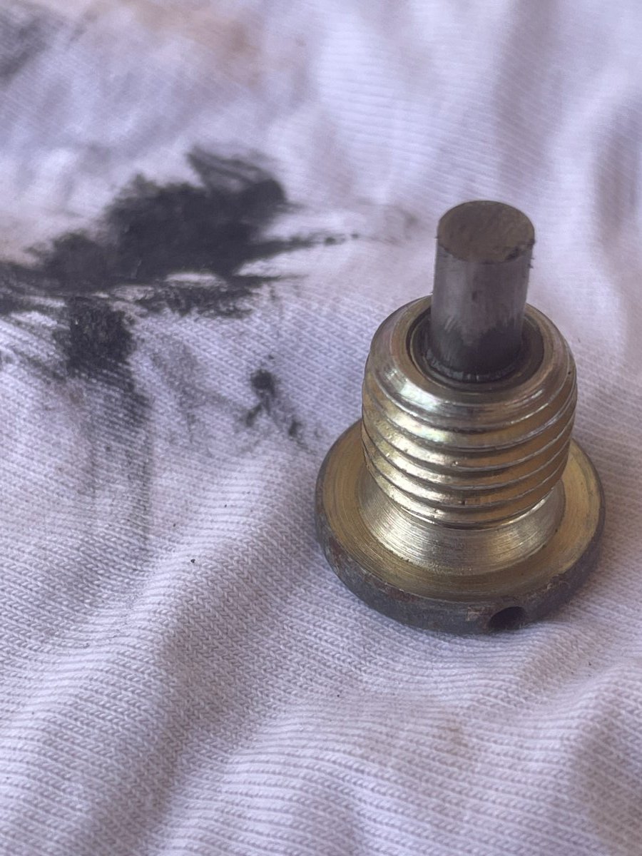

Moneybox Posted January 23, 2025 Posted January 23, 2025 Ok I've looked at that. The reason they strip is that it's a lousy Torx with no grip. When you tap the Torx key in it deepens to grooves and gives you a bit better chance of loosening it. It's a bit furry but looks worse than it really is, nothing like 3mm which is the limit. There are no lumpy bits. It was just like a paste so I'm not concerned about that. We'll see next time 😉 And guys, I'd appreciate all those instructions before I fit the exhaust 🤣 2

Blueadventures Posted January 23, 2025 Author Posted January 23, 2025 8 minutes ago, Moneybox said: Ok I've looked at that. The reason they strip is that it's a lousy Torx with no grip. When you tap the Torx key in it deepens to grooves and gives you a bit better chance of loosening it. It's a bit furry but looks worse than it really is, nothing like 3mm which is the limit. There are no lumpy bits. It was just like a paste so I'm not concerned about that. We'll see next time 😉 And guys, I'd appreciate all those instructions before I fit the exhaust 🤣 Well done, may never have been taken out. May be do an oil change at 15 - 20 hours and recheck plug then. Glad it came out for you. I've never put a copper washer under them or seen such. Cheers. 1 1
facthunter Posted January 23, 2025 Posted January 23, 2025 I would not like to see it keep shedding steel. Keep checking it. The oil is doing a big job in there. Nev 2
Moneybox Posted January 23, 2025 Posted January 23, 2025 (edited) 12 minutes ago, facthunter said: I would not like to see it keep shedding steel. Keep checking it. The oil is doing a big job in there. Nev Any magnetic plug will collect fine particles over time and I have no idea how long its been there. The paper from the oil filter was clean, not a fragment of metal or anything else I could see. Some of these engines had a faulty propeller shaft that would shed metal. This one is not amongst those serial numbers so I'm happy to wait for the next inspection after its done some work. I didn't fit a washer, nor did I over tighten it. Edited January 23, 2025 by Moneybox 1
facthunter Posted January 23, 2025 Posted January 23, 2025 They only collect steel Particles. It should not keep happening . The magnets are good as indicators of WEAR of CERTAIN parts. and also remove the particles from circulation Nev 1

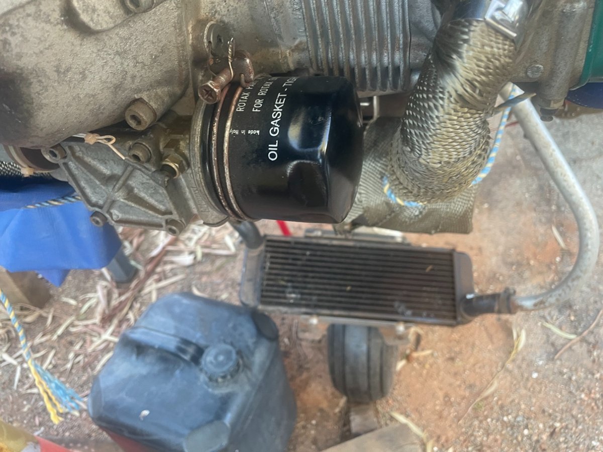

Red Posted January 23, 2025 Posted January 23, 2025 (edited) On 22/01/2025 at 10:59 AM, Moneybox said: I was pleasantly surprised when my 30mm SS exhaust tube and flex turned up in the post this morning. Now I think I have clearance to remove the oil filter too. How could they produce a fault like that and continue to manufacture it until a couple of years later they come out with a new exhaust system. That hose on the radiator comes too close when its in place (another bulletin) so I have some tubular insulation on the way for that as well. MB, that looks like a very old type of Rotax filter that was changed many years ago to a slightly taller type..check it 825016 Is the current part number (Replaces 825012) Edited January 23, 2025 by Red
Moneybox Posted January 23, 2025 Posted January 23, 2025 (edited) 1 hour ago, Red said: MB, that looks like a very old type of Rotax filter that was changed many years ago to a slightly taller type..check it 825016 Is the current part number (Replaces 825012) Recently purchased from Bert Flood. I'll take a look in the morning. Just took a look at the invoice. I got two x 825016. Perhaps it's just the extra clearance I've given it with the remodeled exhaust pipe on No.2. I shouldn't have to move the pipe next oil change. Edited January 23, 2025 by Moneybox
Moneybox Posted January 23, 2025 Posted January 23, 2025 The filter looks a bit grubby but that's because I gave everything a good coat of ACF50 to help with things like that hose clamp on the filter. It mightn't look good but everything has an oily film that will probably give it a bit of corrosion protection. 1
