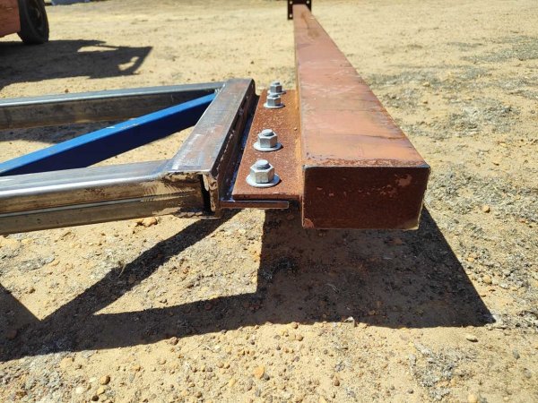

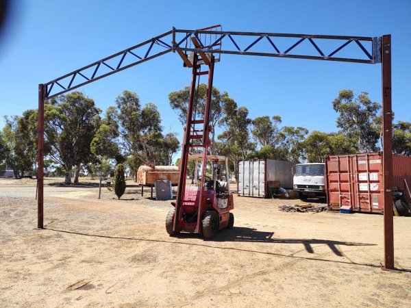

BrendAn Posted February 4, 2025 Posted February 4, 2025 6 hours ago, onetrack said: Steel is horribly expensive today, and shed kit suppliers and builders don't care what they charge, they have more work than they can poke a stick at. If the Cue Council is agreeable to the construction of a used shed, then picking up a dismantled shed or used shed frame can be an attractive option. The sheds built from lipped channel are flimsy, they will buckle up in a willy-willy. Go for portal-frame structural steel. I'm currently building an 8M x 12M x 4M shed using modified portal frames made from structural steel, that came from a powerhouse at Koolyanobbing. Stratco want $25,000 for a shed that size, made from pressed metal. I'll do it for less than half that figure and that includes buying all new Z-purlins and girts and new Colorbond sheeting. I found a young bloke in Darlington who does draughting, structural design and council planning, and he's knocking up the plans for the shed, doing the structural calculations, and drawing up all the paperwork for the council, so I can get a building permit. You have to do all this yourself in W.A. today, there was a big change in 2012 as regards building construction permits and procedures. Before 2012, you submitted plans, and the council had to do all the assessments, now YOU have to provide all the engineering certificates, calculations, etc, so the council just has to check it all out on the submitted paperwork and then approve or reject the submission. It reduces the amount of work the council has to do, and throws it all on your shoulders. There's a FB page called "Best Sheds of W.A.", but it's set up by a shed builder who specialises in pressed-metal sheds, and all the followers want the cheapest pressed-metal shed they can get. But the group is full of useful information and contacts. Log into Facebook WWW.FACEBOOK.COM Log into Facebook to start sharing and connecting with your friends, family, and people you know. The wreckage photos shows what happens to pressed-metal sheds, when a decent storm comes through. It can be pretty devastating. that frame you made was a ripper. nice and strong. the collapsed shed looks like my garden shed about a week after i assembled it. 2

Blueadventures Posted February 4, 2025 Posted February 4, 2025 12 hours ago, onetrack said: Steel is horribly expensive today, and shed kit suppliers and builders don't care what they charge, they have more work than they can poke a stick at. If the Cue Council is agreeable to the construction of a used shed, then picking up a dismantled shed or used shed frame can be an attractive option. The sheds built from lipped channel are flimsy, they will buckle up in a willy-willy. Go for portal-frame structural steel. I'm currently building an 8M x 12M x 4M shed using modified portal frames made from structural steel, that came from a powerhouse at Koolyanobbing. Stratco want $25,000 for a shed that size, made from pressed metal. I'll do it for less than half that figure and that includes buying all new Z-purlins and girts and new Colorbond sheeting. I found a young bloke in Darlington who does draughting, structural design and council planning, and he's knocking up the plans for the shed, doing the structural calculations, and drawing up all the paperwork for the council, so I can get a building permit. You have to do all this yourself in W.A. today, there was a big change in 2012 as regards building construction permits and procedures. Before 2012, you submitted plans, and the council had to do all the assessments, now YOU have to provide all the engineering certificates, calculations, etc, so the council just has to check it all out on the submitted paperwork and then approve or reject the submission. It reduces the amount of work the council has to do, and throws it all on your shoulders. There's a FB page called "Best Sheds of W.A.", but it's set up by a shed builder who specialises in pressed-metal sheds, and all the followers want the cheapest pressed-metal shed they can get. But the group is full of useful information and contacts. Log into Facebook WWW.FACEBOOK.COM Log into Facebook to start sharing and connecting with your friends, family, and people you know. The wreckage photos shows what happens to pressed-metal sheds, when a decent storm comes through. It can be pretty devastating. No fly straps or cross bracing that we have in North Queensland for cyclone rating. Cross bracing would have helped stop it falling back. 1

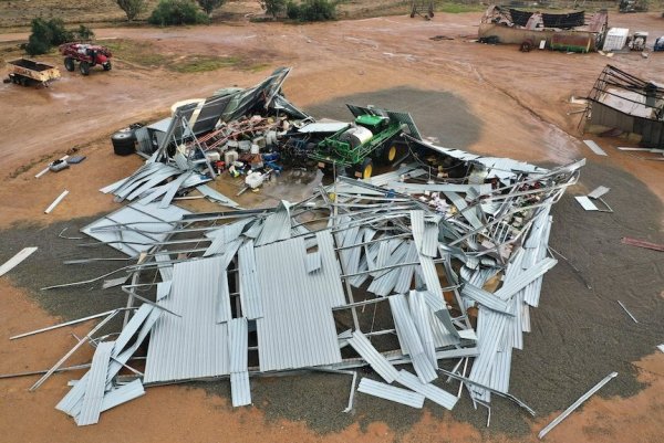

onetrack Posted February 5, 2025 Posted February 5, 2025 (edited) Marty, note the total lack of cross-bracing in the walls and roof of the shed you linked to. In addition, there's a serious lack of bracing at the apex of the rafters, and at the knee joints with the columns. These are critical areas that come under heavy load with wind gusts. Add in the fact that the lipped C-channel sections in the frame are notorious for twisting and thus losing inherent strength - and that this has to be addressed by using braces between the frame and purlins and girts - but the shed shows none of that style of frame bracing. The minimum requirement for knee bracing - Here is improved knee bracing - and also showing rafter bracing to the purlins to prevent twist - but this design still lacks adequate apex bracing, to my mind. Edited February 5, 2025 by onetrack 1

Blueadventures Posted February 5, 2025 Posted February 5, 2025 4 hours ago, onetrack said: Marty, note the total lack of cross-bracing in the walls and roof of the shed you linked to. In addition, there's a serious lack of bracing at the apex of the rafters, and at the knee joints with the columns. These are critical areas that come under heavy load with wind gusts. Add in the fact that the lipped C-channel sections in the frame are notorious for twisting and thus losing inherent strength - and that this has to be addressed by using braces between the frame and purlins and girts - but the shed shows none of that style of frame bracing. The minimum requirement for knee bracing - Here is improved knee bracing - and also showing rafter bracing to the purlins to prevent twist - but this design still lacks adequate apex bracing, to my mind. The rafter bracing is what I referred to as Fly straps and the back side space on both sides would be cross braced and also the front ones, 1
