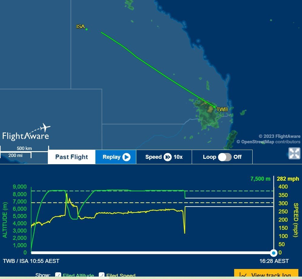

rankamateur Posted November 4, 2023 Posted November 4, 2023 Given that it was doing 223 knots at 28050 ft in a straight line then suddenly decelerated less than 100 knots while losing 4000 feet doesn't seem like normal fire monitoring activity. It had a return flight to Townsville logged for later that afternoon. 1 3

rankamateur Posted November 5, 2023 Posted November 5, 2023 (edited) 5 hours ago, facthunter said: It looks as though it's had an "UPSET" earlier in the Fight that exceeded a lot of limits and resulted in total failure later (as well it would). Nev Its logged speed was over 260knots but it didn't seem to exceed 223 in the later part of its final flight. Are you suggesting that it was limping to its destination? Edited November 5, 2023 by rankamateur Correction 1 1

rankamateur Posted November 6, 2023 Posted November 6, 2023 19 hours ago, facthunter said: Strong possibility. Any plane subject to severe overload or a hard landing has to have inspections of relevant parts of the structure. or get a permit to fly (No pax) to a place where it can be done. You'd have to be very lucky to get one for that AIRCRAFT in those circumstances Limping might not be the best word as it flew normal speed and levels till something happened. Nev The something happened north of Dulacca much nearer to Toowoomba than to Mount Isa, which may have been a better place to limp to. While they reacted to the something, they maintained near perfect track while losing a whole heap of altitude and airspeed rising over 300 knots. 2
facthunter Posted November 6, 2023 Posted November 6, 2023 The speed will be projected speed along track NOT airspeed which we are used to seeing. A near vertical dive would register low as you don't progress along the surface much. Nev 3

rankamateur Posted November 6, 2023 Posted November 6, 2023 11 minutes ago, facthunter said: The speed will be projected speed along track NOT airspeed which we are used to seeing. A near vertical dive would register low as you don't progress along the surface much. Nev So 313 knots projected on the flight radar track may have been two and a half times that given the sudden altitude loss that is accompanied? That being the case, why would you fly on for your destination rather than divert to Roma or return to Toowoomba? 1 1
facthunter Posted November 6, 2023 Posted November 6, 2023 I don't wish to speculate on that but I'm sure we're not the only ones to notice it. . The 2 1/2 times would be too far to endure structurally. I'd go with significantly more but not enough to break it at that stage obviously as it continued on after that. Nev 1 1
Thruster88 Posted November 6, 2023 Posted November 6, 2023 On 05/11/2023 at 11:06 AM, facthunter said: It looks as though it's had an "UPSET" earlier in the Fight that exceeded a lot of limits and resulted in total failure later (as well it would). Nev The first descent and climb back to altitude was very obviously under control. The data shows at the end a gradual reduction of speed while maintaining altitude and track perfectly over a minute or two. Aircraft on autopilot with a reduction of power in one or both engines, a stall most likely but why? 2

KRviator Posted November 6, 2023 Posted November 6, 2023 13 hours ago, Thruster88 said: The first descent and climb back to altitude was very obviously under control. The data shows at the end a gradual reduction of speed while maintaining altitude and track perfectly over a minute or two. Aircraft on autopilot with a reduction of power in one or both engines, a stall most likely but why? That first descent had me wondering too, but -HPY had the same vertical profile in a very similar geographic area a week earlier on a TWB-ISA flight, so it was intentional both times. Once we could be forgiven for linking it to the accident, but not twice. Here's the accident flight: And here's a week earlier - same area, same descent, albeit not quite as quick. 3
