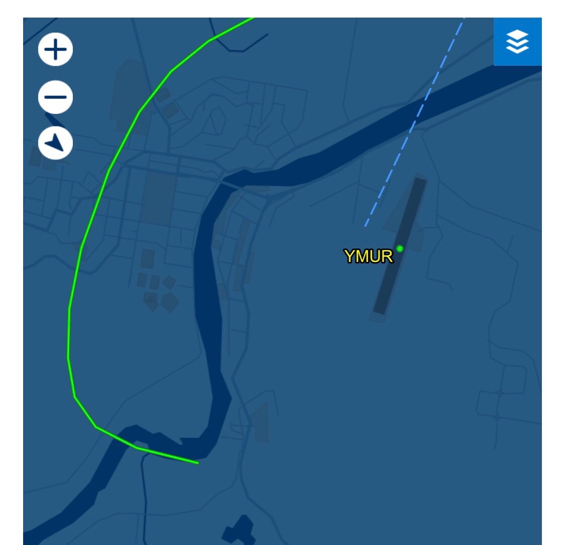

RFguy Posted October 15, 2023 Posted October 15, 2023 how good is the ADSB coverage in the region at ground level- is this the termination of flight, or just the ADSB coverage limitation ? glen
Area-51 Posted October 15, 2023 Posted October 15, 2023 (edited) 32 minutes ago, RFguy said: how good is the ADSB coverage in the region at ground level- is this the termination of flight, or just the ADSB coverage limitation ? glen Flat flood plains all the way to coolangatta. ADSB registers on the ground at YMUR, Tygalgah is just north of YMUR though. So must of happened on climb out Edited October 15, 2023 by Area-51

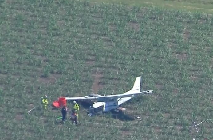

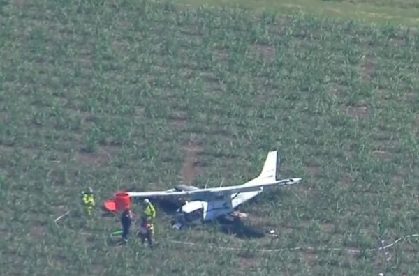

red750 Posted October 17, 2023 Author Posted October 17, 2023 A photo from the Facebnook page of Aviation 24/7 which posts photos of aircraft accidents from around the world. Listed as Tygalgah accident.
Thruster88 Posted October 17, 2023 Posted October 17, 2023 A very short skid mark thru the crop, quite a hard hit. Don't think that one will fly again.
facthunter Posted October 17, 2023 Posted October 17, 2023 We don't know how strong the wind was. They usually invert in such circumstances. Nev
