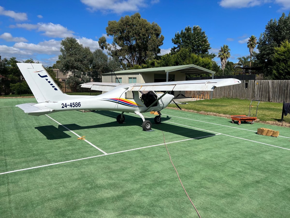

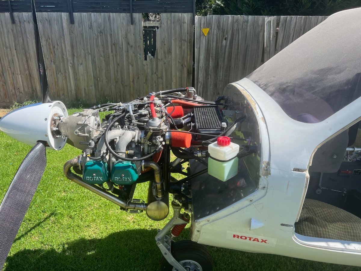

GolfWhiskeyHotel Posted March 21, 2023 Posted March 21, 2023 I have just about finished fitting a Rotax to a J160. The RAA reg. Form (Tech form 14) requires that I identify other aircraft that have had a similar conversion. Quote"I have supporting documentation such as independent engineering advice or history of safe operation from elsewhere." Can or will anyone that has such a modification please let me know in the form of a statement that they have had X hours of safe operation? There is no liability attached to such a statement. Any information from anyone having gone through the registration of such a modification would be a great help, Thanks, Geoff Higgins. 1
Neil_S Posted March 22, 2023 Posted March 22, 2023 Hi GWH, There's been one at Lethbridge for years. I don't have the contact details but if you call the number listed in the ERSA for Lethbridge I am sure they can put you in touch. Cheers, Neil
kasper Posted March 22, 2023 Posted March 22, 2023 I hate to be a spoiler BUT MARAP is VERY prescriptive as it will remain a factory built aircraft and available to use as such. 1. history of safe ops has to be EXACTLY the same modification: a. same model of JAB (not a JAB LSA55 with Rotax but another J160) b. same modifications (eg same design and manufacture of the engine mounts, exact same engine - not 80 vs 100hp, same accessories and same mods to the cowls) 2. Jabiru will still need to provide a notice of no objection (its their airframe) Overall you need very specific support for a MARAP and it will still take a lot of time. I would clarify with RAAus Tech exactly what will be accepted before gathering it or you will be quite frustrated to discover further down the track that you have not got the required bits.
GolfWhiskeyHotel Posted March 22, 2023 Author Posted March 22, 2023 AH , OK , Then I will go down the E reg road. Thanks for the information.

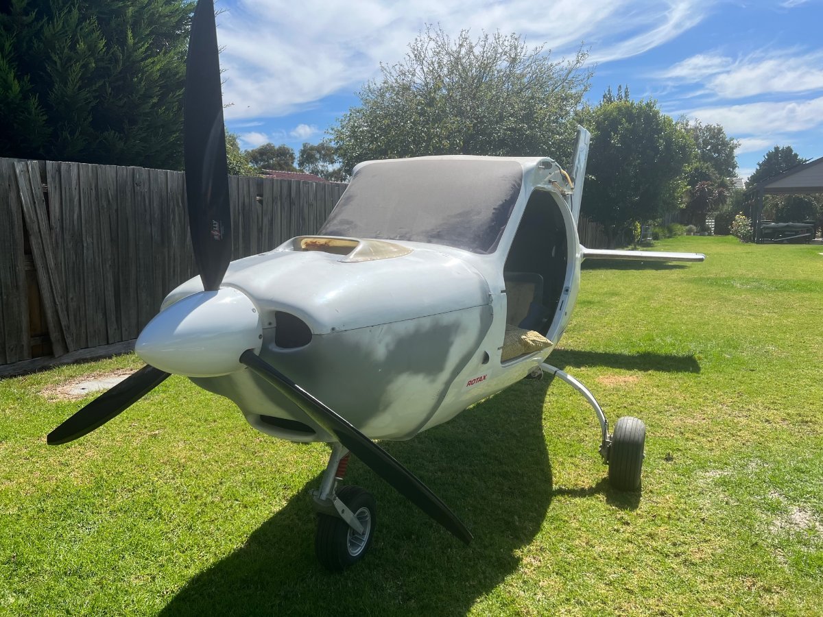

GolfWhiskeyHotel Posted April 24, 2023 Author Posted April 24, 2023 RE: Rotax/Jabiru 160C Well, things have moved along. The aircraft is finished and I'm on the road to MARAP. Unfortunately there is no other way. The weight and balance was done today. Empty weight came out a couple of kilos over the original 302, and the C of G is in the correct range. So things progress. AS the 160c is a Certified aircraft it has to follow the MARAP path. ( I really dont understand "Certified' and LSA, Why Certified? I can't follow it at all) I wish it were otherwise. I had no idea that the 160C was particularly singled out for this. RAA has been helpful so far. But, I WILL need examples of safe operation of a Rotax Powered Jabiru 160 There must be a couple around. Please raise your hand.

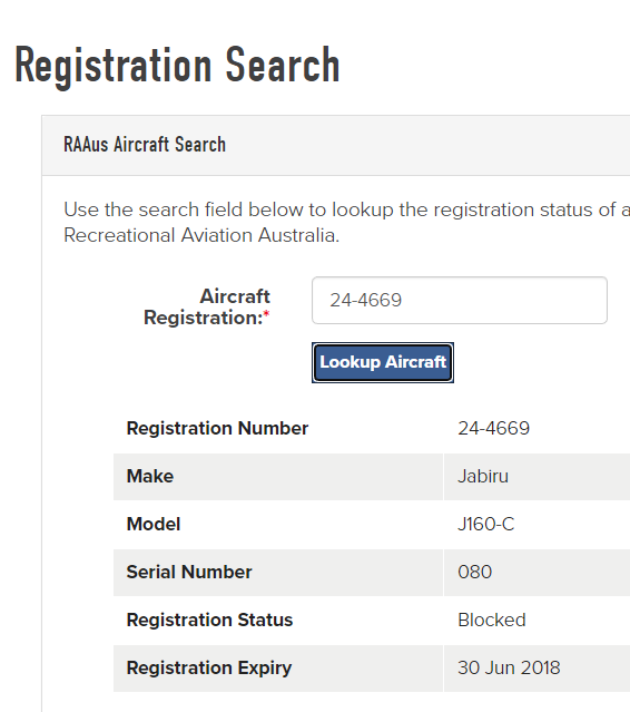

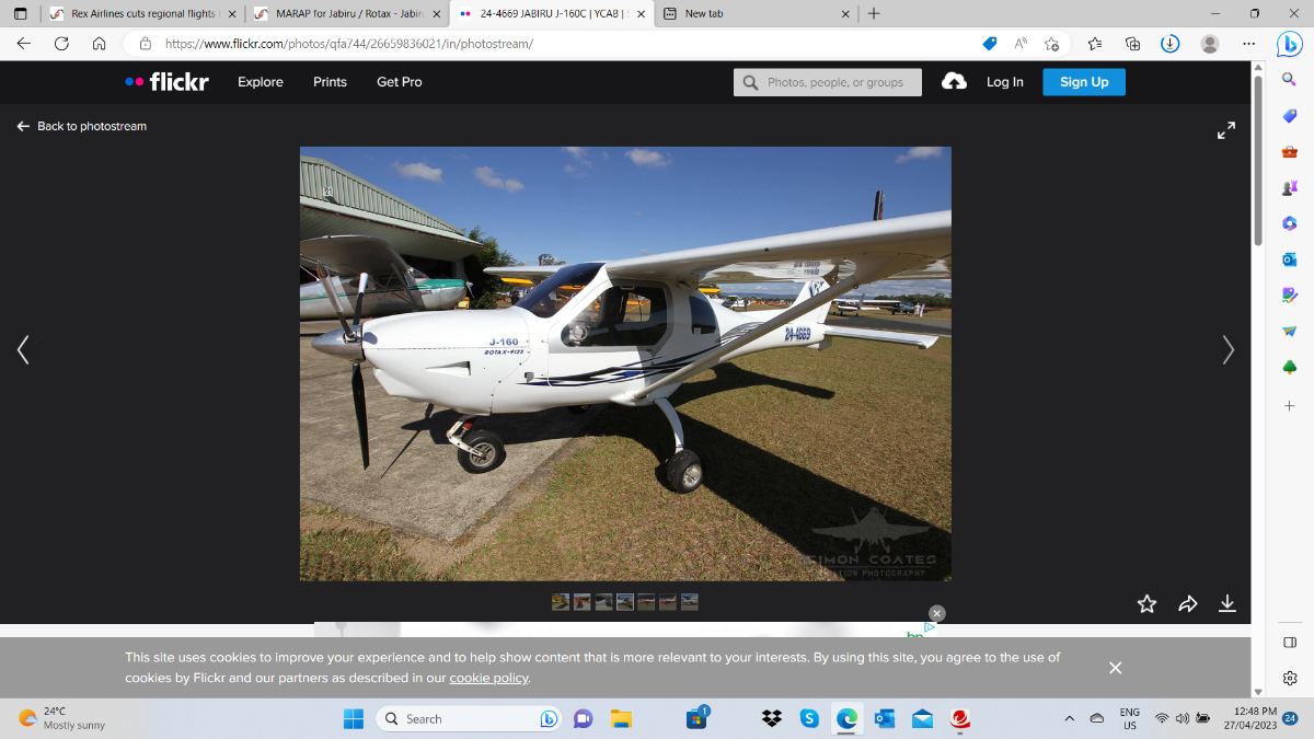

sfGnome Posted April 26, 2023 Posted April 26, 2023 (edited) I used to hire 24-4669 which was a Rotax powered 160. No idea where it is now, but if it’s still flying then it should be traceable. Edited April 26, 2023 by sfGnome 1
Blueadventures Posted April 27, 2023 Posted April 27, 2023 21 hours ago, sfGnome said: I used to hire 24-4669 which was a Rotax powered 160. No idea where it is now, but if it’s still flying then it should be traceable. May be at Caboolture, a rego check with RAAus may say.

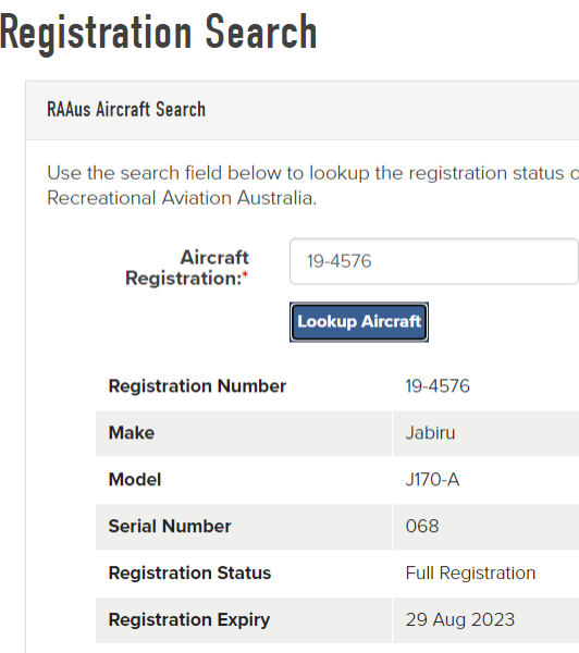

440032 Posted April 27, 2023 Posted April 27, 2023 Surely RAAus knows of Robert's Jabiru 170 19-4576?

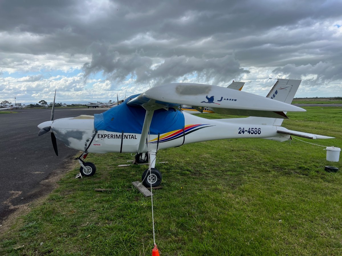

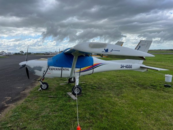

GolfWhiskeyHotel Posted April 28, 2023 Author Posted April 28, 2023 Thanks everyone. I have a couple of numbers to work with. Although I would have thought that RAA would have known who has the Rotax powered Jabiru's. The aircraft has an "Experimental" sticker on the side. I stuck the decals on in anticipation of E reg. When I try to remove them the paint comes off!!! 1
tillmanr Posted April 28, 2023 Posted April 28, 2023 GWH, have you tried warming the decals with a hair dryer. It is normally enough to soften the adhesive. Don’t just keep the heat on a small spot rather gradually warm up maybe half the word. 1
