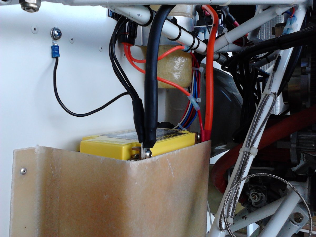

kgwilson Posted March 5, 2023 Posted March 5, 2023 (edited) In that case if there is any space forward of the firewall, that is the best place for it. A simple fibreglass box attached to the firewall, foam padding on all sides with a top bungee strap to stop it moving. Best position for all heavy cables Solenoid, starter, engine earth, regulator, main fuse etc. Another good idea is to install an Anderson plug on the fuselage close to the battery so that you can easily jump start from any other vehicle if the battery is to flat to turn the engine over. This my battery installation on the firewall. The battery is 6KGs Edited March 5, 2023 by kgwilson 4 1

skippydiesel Posted March 6, 2023 Posted March 6, 2023 19 hours ago, kgwilson said: I....................................... This my battery installation on the firewall. The battery is 6KGs........................ 19 hours ago, kgwilson said: ........... a top bungee strap to stop it moving........... ...........install an Anderson plug............ Nice neat install. That seems about right for an excellent Rotax start battery - I have used SSB batteries to very good effect for many years. Lead Acid/Absorbed Matt/Gel type motorcycle batterie's have been going up in CCA's and down in weight. The last I purchased, for my Zephyr , was (I think) SSB VB16L-B CCA 385 - AH (20hr) 19- Weight 6.5kg - spun the 912 ULS almost as well as combustion. Personally I don't like bungees in this sort of application - much prefer a strap of almost any tightening system . Be careful of your commonly available Anderson plug - it will literally fall apart, if inadvertently sprayed with hydrocarbon (petrol etc). There are chemical resistant versions, unfortunately I was unable to find any, when I did my search/purchase. 2

kgwilson Posted March 6, 2023 Posted March 6, 2023 (edited) I recently did my BFR. Got the aircraft out & the battery was dead & instructor waiting. I could not jump start it, wouldn't even turn over so I went to the local battery shop & asked for a replacement for what I brought in. I got a Ritar RT12220 22 AH general purpose battery designed for UPS/EPS high discharge and recharge use with a 6-8 year design life in float service for $130.00. Weighs 5.6KGs. Spins the 3300A over flat out. I have no idea how long it will last but it was better to part with $130.00 at the time than pay for a BFR twice. There is no quoted CCA value but it states the monthly self discharge rate is less than 3% at 25 deg C. Edited March 6, 2023 by kgwilson 1 2
