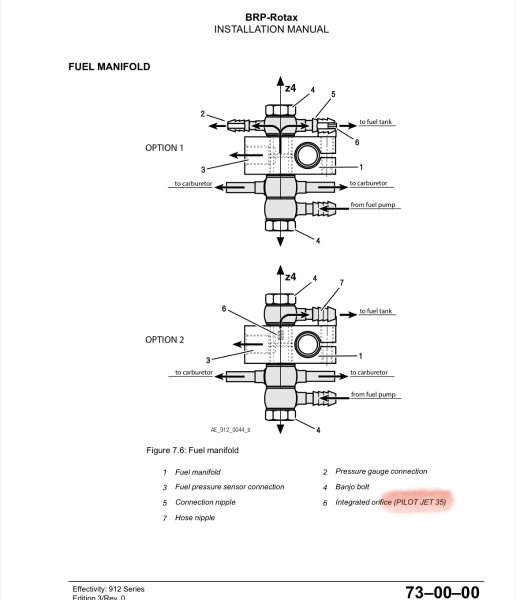

pluessy Posted January 28, 2023 Posted January 28, 2023 no need, the #35 (0.35mm) jet has been documented by Rotax and mentioned a few times in this thread. 1 2
skippydiesel Posted January 28, 2023 Author Posted January 28, 2023 (edited) 2 hours ago, pluessy said: no need, the #35 (0.35mm) jet has been documented by Rotax and mentioned a few times in this thread. Unless Rotax have changed their part, the jet supplied to me on the 25/01/2023, PN 963820, "Pilot Jet 35" actually measures .53mm (ID) definitely not 0.35 mm The Rotax fuel line return restrictor jet is almost certainly a Mikuni type VM 22/120 #35 - Why ? The design/shape, dimensions & number of holes, matches the Rotax part. Further the Mikuni numbers relate to flow (not a specific jet ID). Unfortuatly I have been unable to find the flow data. Are you able to assist? Edited January 28, 2023 by skippydiesel

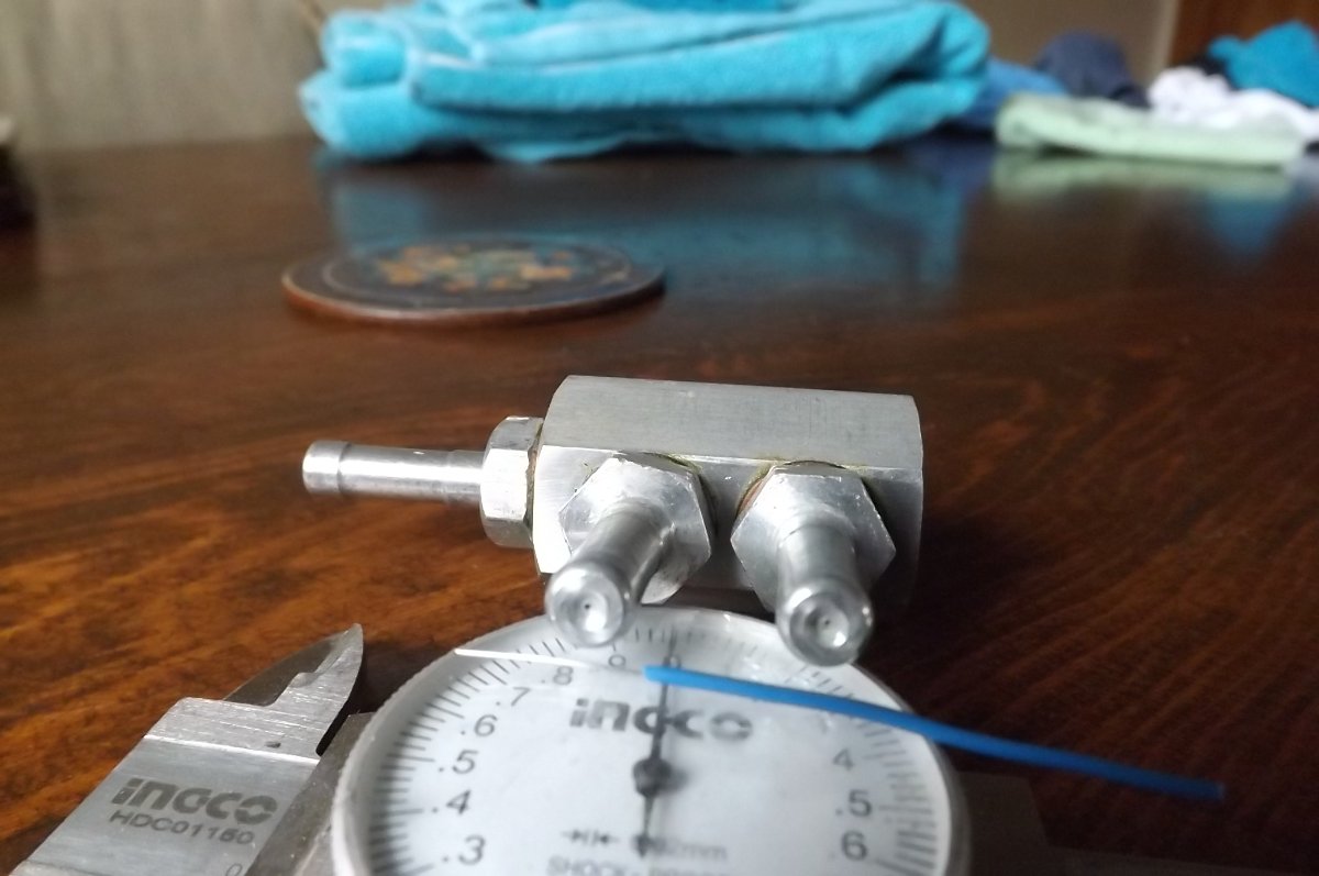

IBob Posted January 28, 2023 Posted January 28, 2023 (edited) I don't think the people proposing here to stick variously modified pins or needles in the hole have looked at just how small 0.35mm is: I spent many minutes with grades of emery paper cutting a taper onto the tiniest needle I could find in order to try and measure the jets in the above pic. As a comparison: a standard fine dressmaker's pin in 0.6mm in diameter. Edited January 28, 2023 by IBob 1
