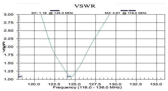

FlyBoy1960 Posted November 8, 2022 Posted November 8, 2022 2 hours ago, cherk said: MobileOne.com.au https://www.mobileone.com.au/images_antennas_airband/airkit.png Sorry but these aerials are really TERRIBLE. I have the RF plots somewhere.
FlyBoy1960 Posted November 8, 2022 Posted November 8, 2022 Found them, the range is just so NARROW it will cook most radios at either end of the frequency range. Mobile 1 Ground plane independent VHF aerial system
RFguy Posted November 8, 2022 Posted November 8, 2022 (edited) They are quite narrow. but they are typical of most efficient air band antennas you cant have efficiency and wide bandwidth many antennas (like the swept back ones use lossy resistors or lossy elements in them to improve bandwidth (throw away half the power and signal) there is no free lunch in this game MOST of the swept back airband antennas have awful VSWR, and or a resistor to even them out. You'll find it very hard to find a published curve for them- they dont want you to know how bad they are! Mobile One have been honest. Suggestions : BTW no antennas are truly ground independent, just ground less dependent. The mobile one ground independent is very narrow. If you have metal in your frame there is no point to using a ground independent, you'll suffer narrow band. just go a mobileone quarterwave whip. not the mobileone ground independent on the mobileone site- the M124-1 whip. https://mobileone.com.au/5b_airband.html and you want a UB5BNC base , coax and connector https://mobileone.com.au/7c_cables.html#ul12bnc The mobile one antenna that FlyBoy doesnt like - they can be OK with a 3dB attenuator in series- this is made from standard RG58 polyethelyne dielectric- not the low loss foam stuff) - you'll need 15m coiled up. OR you can buy a 3dB attenuator inline coaxial https://www.ebay.com/itm/373625363386?mkcid=16&mkevt=1&mkrid=711-127632-2357-0&ssspo=Y3gm5yYcQcy&sssrc=2047675&ssuid=&var=642635709538&widget_ver=artemis&media=COPY That will make the antenna OK for the radio over the whole band. BUT I suggest the quarter wave whip instead of the ground independent (assumign you have a metal frame.) if you dont have a metal frame, use the quarter wave which with two wire ground wires 180 deg to eachother, approx 59cm long . make them thick- out of 10mm wide strip of copper tape or ally tape. or just 10-20mm wide 1mm ally strip. you'll need to drill and wire the threaded antenna base. Edited November 8, 2022 by RFguy 1 1 1

Jabiru7252 Posted November 14, 2022 Posted November 14, 2022 On 08/11/2022 at 2:22 PM, FlyBoy1960 said: Found them, the range is just so NARROW it will cook most radios at either end of the frequency range. Mobile 1 Ground plane independent VHF aerial system Given the huge price we pay for aviation radios I would say that they would have protection against high SWR. It's easy to implement, being found in cheap CB radios. If my radio was 'cooked' because the antenna was rubbish I would have every right to shove the radio down the manufacturer's throat. 2 1
