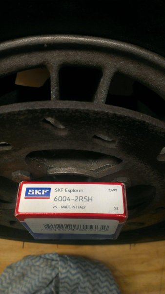

facthunter Posted December 13, 2022 Posted December 13, 2022 I think that one is shielded which is not as good as sealed for grease retention. They are even used in wheelbarrows (a cheap version). Nev 1
Thruster88 Posted December 14, 2022 Posted December 14, 2022 (edited) 1 hour ago, facthunter said: I think that one is shielded which is not as good as sealed for grease retention. They are even used in wheelbarrows (a cheap version). Nev 2RS means it has rubber seals both sides. Z is the steel shield type, those are not completely sealed Edited December 14, 2022 by Thruster88
onetrack Posted December 14, 2022 Posted December 14, 2022 Good choice. The SKF Explorer range of bearings are premium grade bearings, and the "RSH" refers to rubber seals with high performance, the rubber seals are double-lipped and have improved abilities to keep grease in, and water out. Â Table 2 on Page 4 of the SKF catalogue below, outlines the differences between the RSH and RS1 seal types. Â https://www.acornbearings.co.uk/downloads/catalogues/bearings/deep-groove-ball-bearings/skf-explorer-deep-groove-ball-bearings.pdf 1
facthunter Posted December 14, 2022 Posted December 14, 2022 Those bearing types are used on Multi V belt drives for Car water pumps and alternator drives and last for years in extreme conditions/ Grass can enter and damage the "thinnish" seals if there's no protective cover. Lift the wheel regularly and check no roughness or play evident. If any water gets in it's not going to last long. Nev 1
