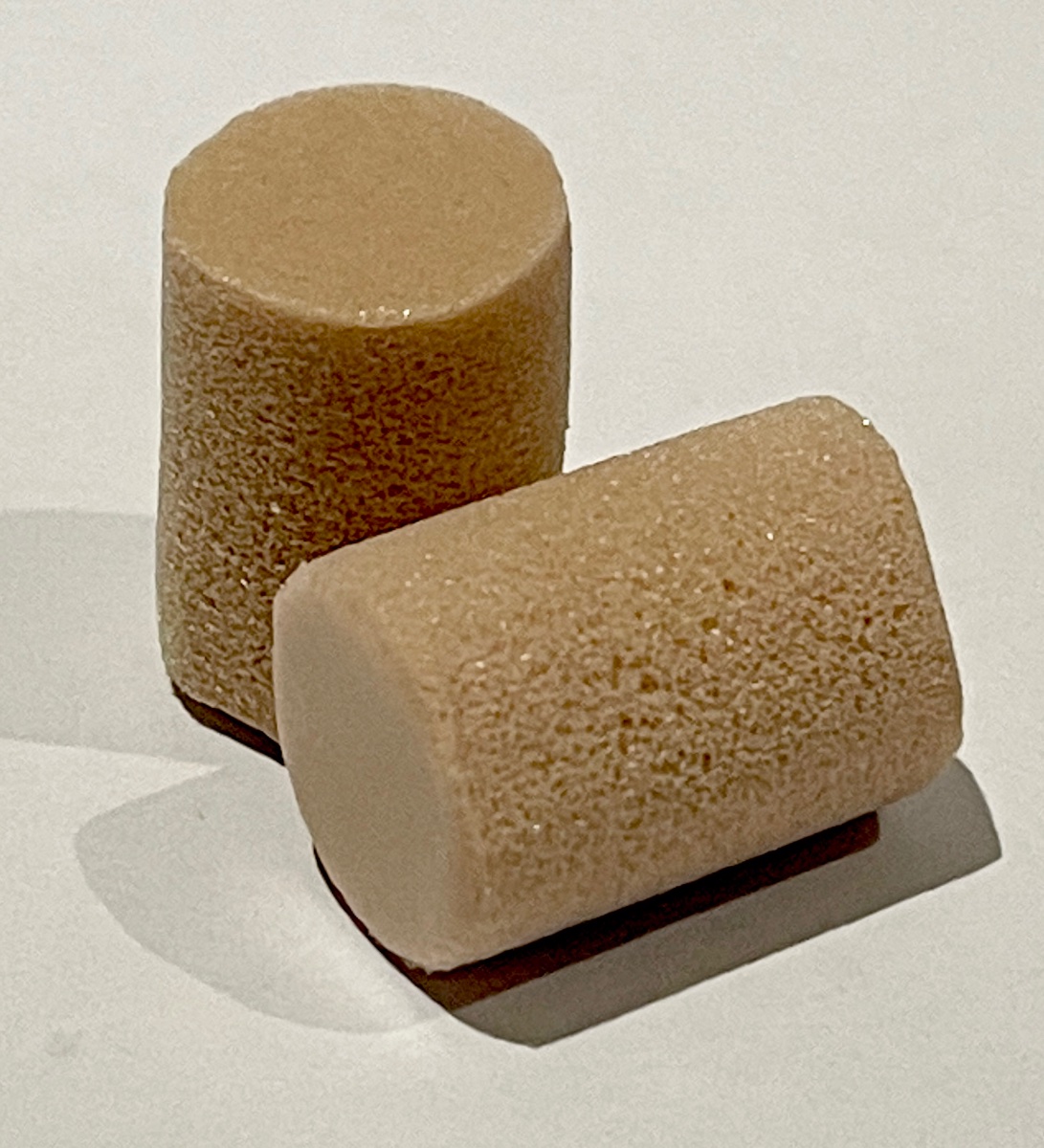

But noise-cancelling headphones + foam rubber earplugs are better than either other combination. The foam rubber earplugs, pictured below, work much better than the earplugs with rounded ends that look like they have been moulded. The moulded ones distort sound too much. This might save someone about $600.
Disclaimer: I sleep with earplugs so I am very used to them. If you fly with someone else, who is not using earplugs, you will probably find that the other person’s headset sounds too loud and your headset sounds too soft, even when both headphones’ volume controls are as high and low as they go. It is less likely that the headset will not be loud enough.

I’ve never got much noise reduction from foam earplugs, but custom moulded ones really help- especially with decent earmuffs over the top. Noise cancelling sure helps too, especially expensive sets.
Google custom molded earplugs; $25 might buy you enough kit to make two pairs.

What's the advantage of noise cancelling and earplugs. Wouldn't it be simpler to buy earphones that attenuate the sound more?
A combination of https://www.amazon.com.au/Professional-Safety-Decibel-Defense-PROTECTION-GUARANTEED/dp/B01BEENYCQ  and earbud mikes might also be more effective if it floats your boat as it would combine the best quality of sound with an un-distorted sound feed.
I'm not 100% sure what you're saying. Do you wear passive foam plugs under your headphones? If that was the case your headphones would need to be louder to overcome the passive plugs and thus would sound louder and even with foam plugs with attenuate different frequencies at different rates.

Personally I prefer PNC over ANC headsets as I can hear the engine note and can detect any little anomaly. I hate foam earplugs & can't see the point of having these as they will reduce the level of radio traffic information being received & this what the headset is for.

I put passive foam rubber ear plugs in then I put on an active Lightspeed headset. The earplugs make all the sound softer. The headset volume is turned up. The sound does not distort. The end result is that the sound from the headset is just and loud and clear, but the sound from the aircraft is even softer than just using the headphones by themselves.

That is also a valid argument. Maybe. better headline would have been to try foam earplugs if you cant upgrade.

I think APenNameAndThat's original proposition is quite cunning, and certainly worth considering:
1. 'Turn down' hearing by inserting earplugs (hopefully without sacrificing clarity).
2. Compensate by turning up headset volume.
3. Ratio of headset sound (radio and comms talk) to external sound is now improved.

Signal to noise ratio.
The key issue is what is the attenuation profile of your favourite earplugs. If the plugs attenuation the higher frequencies more than lower ones, which they do, you're going to end up with muddy sound which mutes plosives and masks the temporal boundaries which we normally use to distinguish speech. Plosives have a lot of higher pitched sounds. This may not matter much if you already have some hearing loss.
This is one of the reasons why, as you get old, and your ability to hear higher pitched sound diminishes, conversations in noisy places with lots of hard surfaces become increasingly more difficult.
I'd be tempted to just buy noise cancelling headphones with good physical attenuation as well as active attenuation. It's hard to get published figures on these though I love to see test results so it was easier to make some value based choices.
