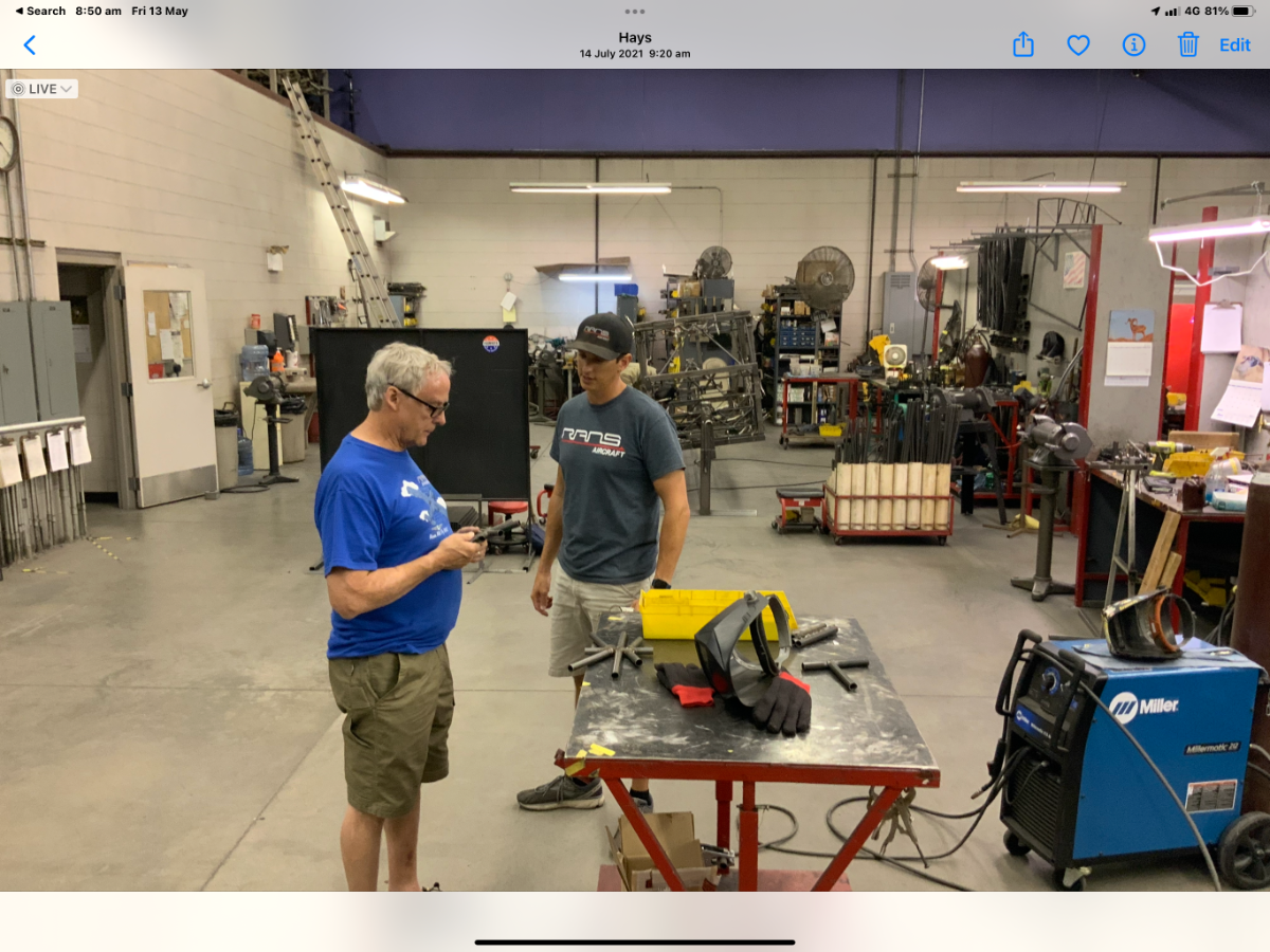

Pic; Randy in the factory. Interviewing potential welders. I did a trial weld and didn’t pass muster. No job for me.

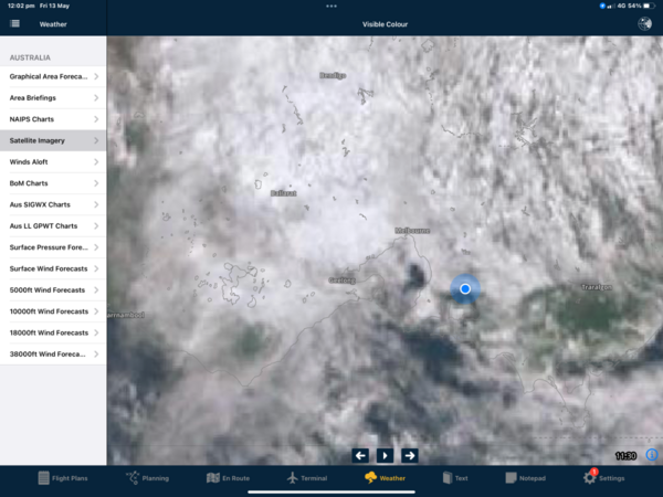

Fog today…..I suggested I meet oldest daughter to fly today when fog clears. She won’t. Friday 13th! . I certainly won’t push it because we lost mum recently. I’ll fly and told my girls I’ll wear my luck pants so it’ll be okay. Response…that’ll be included in the eulogy 😀

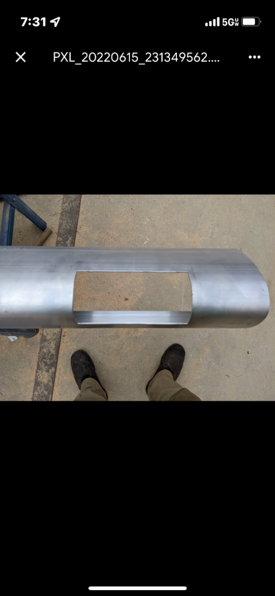

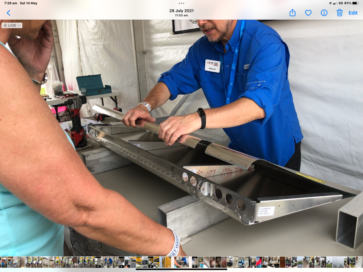

Rudder build with the super helpful nice guy Eddie from Rans.

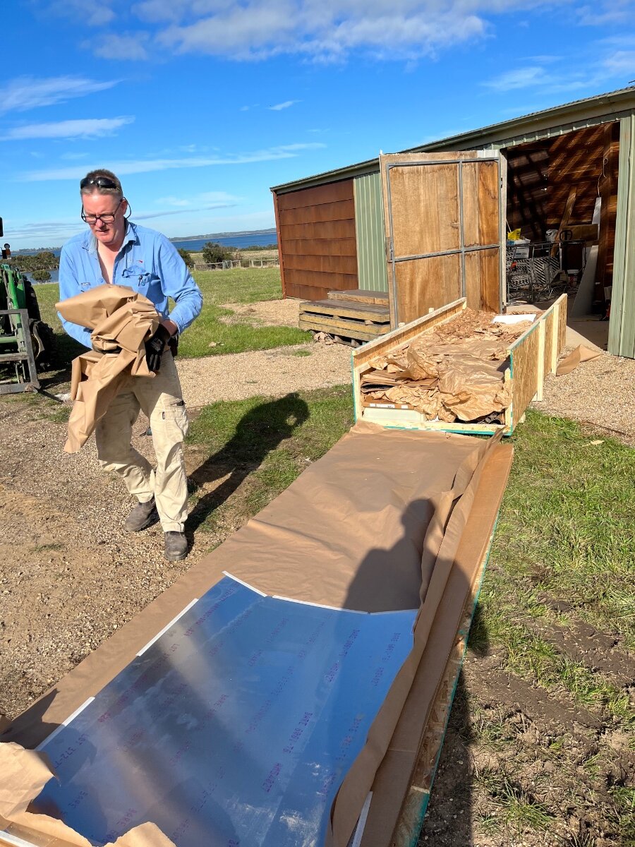

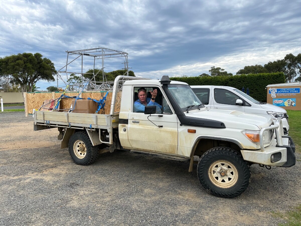

Pickup of the frame kit from Tooradin. Very lucky to get the back on the barge to French Island with a blown engine and the barge limped in on last run until repaired.

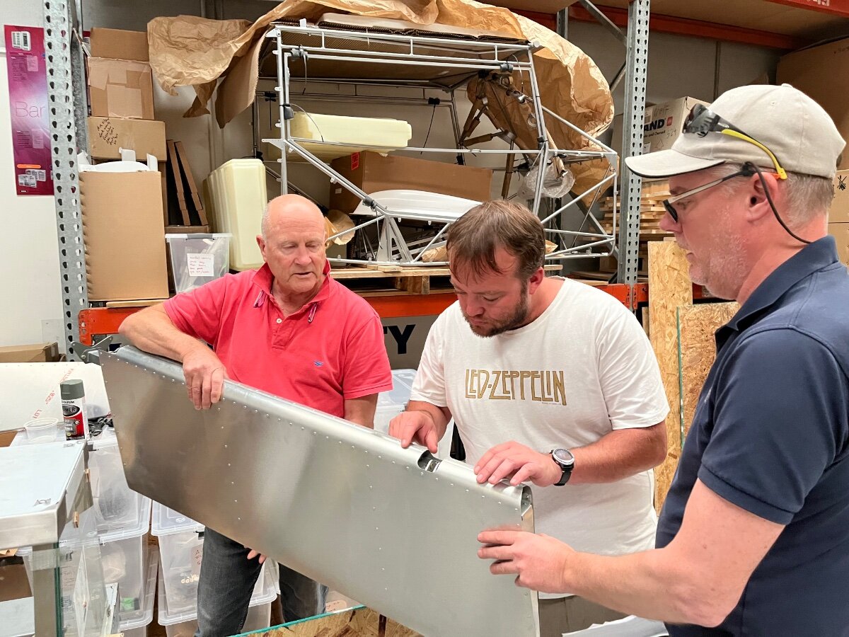

Visiting another S21 builder. Big assist on how to unpack and plenty of build tips.

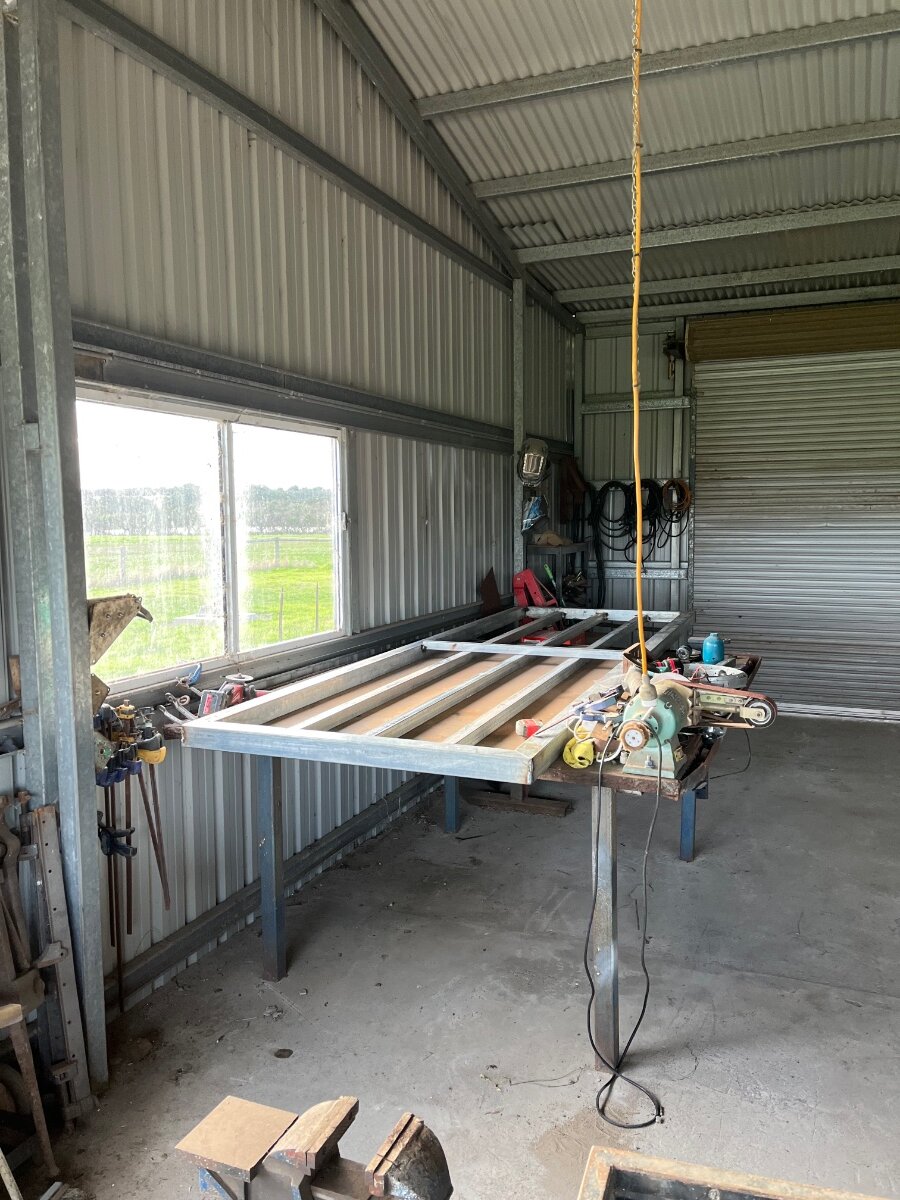

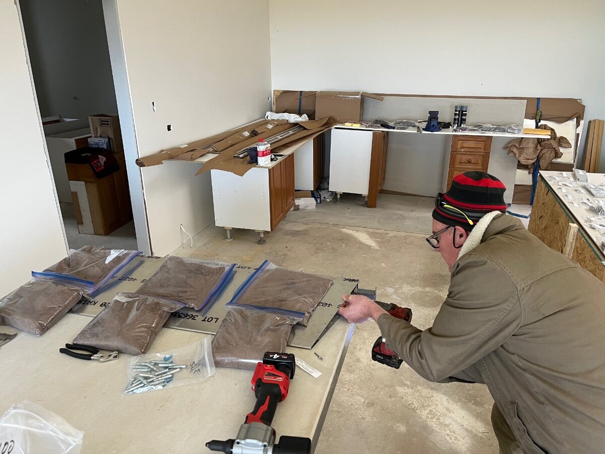

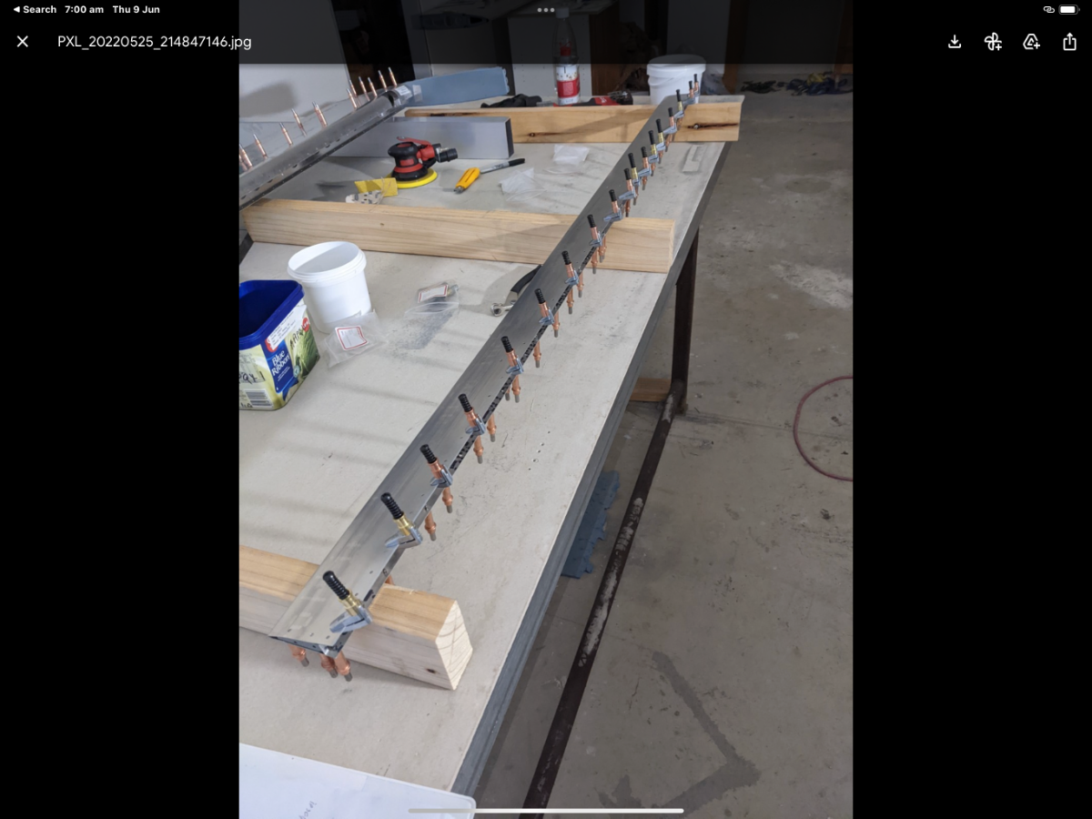

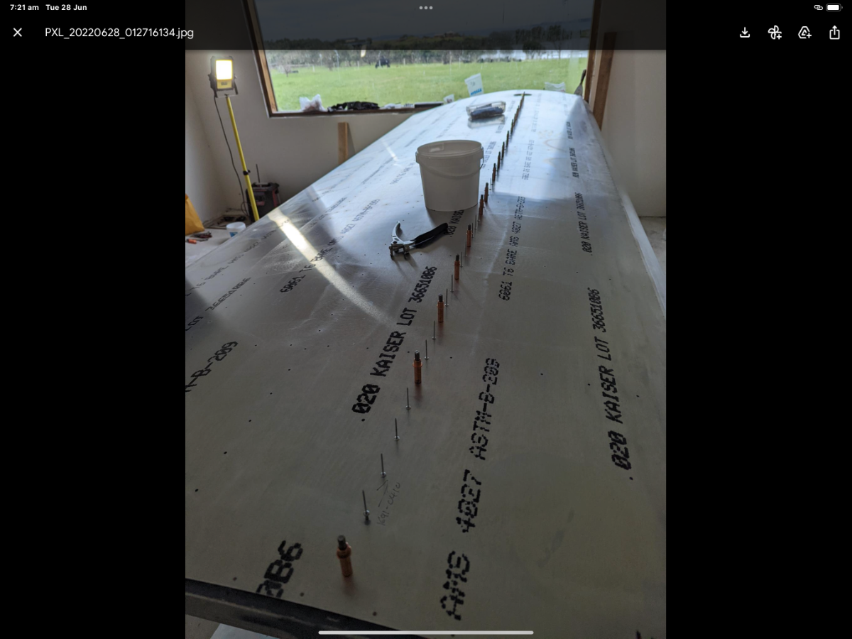

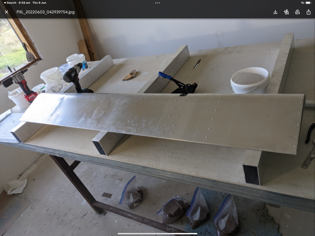

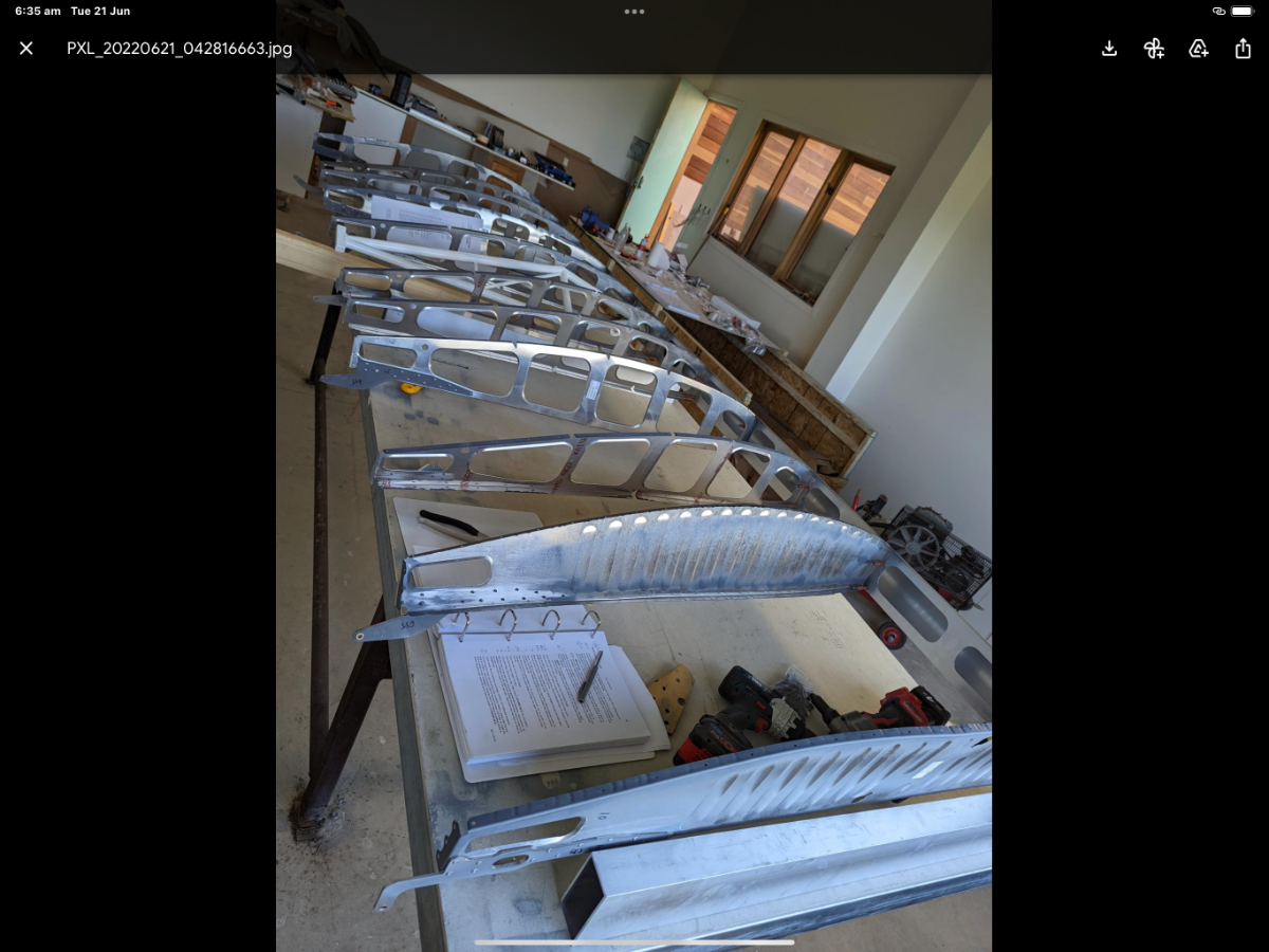

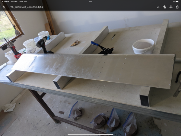

Fabricating a flat table. We’d like to have thick MDF but no barge so cement sheet has to do. It’s within .5 degree and we use 100x50 aluminium and shims for final critical levelling of parts. Rudder underway and we were waiting on clecos then waiting on 3.3mm drill bits. Flew today in some pretty blustery conditions to Tyabb. Yesterday battled the fog. Ended up having to go to Port Phillip bay then come back around the coast under the cloud into western port bay to Tooradin. Quite a detour. IFR would have been a quick trip in.
Rudder finish tomorrow morning and hopefully it’s perfect and we don’t start with a reorder and repeat! Not keen on going to USA with the kit build going on but family and other commitments in USA.

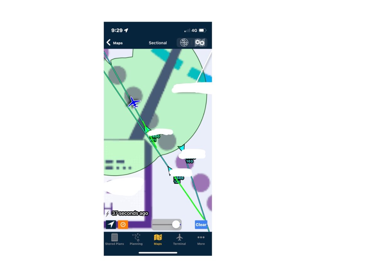

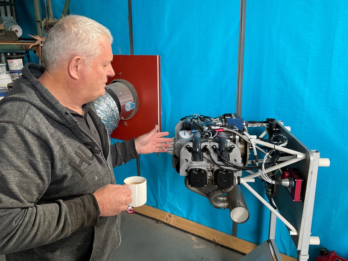

On the topic of exciting moments flying to Maryborough to meet the UL520t Australian dealer Les. You can see VFR corridor. I’ve blanked the other aircrafts altitude because it may or may not have been way closer to me than he should and obviously on wrong side of corridor. Move to right of corridor for oncoming aircraft. It says so on the map!
1500ft southbound, 2500ft northbound as I was. I moved left because of that aircraft being off to wrong side and in the wrong place. ATSB in and avplan always on. monitoring Center and they didn’t call eithe of us so it must have been okay….
We have ordered the 520t. 40% deposit 41,500 euro. Les is great to deal with. Either order or fly into Maryborough as I did and he can take you through the history of UL engines. Les has represented them for 14 years. One of their oldest dealers. As Les mentioned you can go through the history of the engines via the service bulletins. With a history as inventor I definitely don’t want to be an early adopter. Great to see history.
https://ulpower.com/en/engines/service-bulletins
The turbo is a recent development. It is also a very conservative addition. Horsepower kept down to 220hp at 2700rpm. The engines normally run out to 3300rpm. It is more normaliser than turbo. It has certainty in being a well established turbo. We run standard 2700rpm prop in place of a prop especially made for 3300rpm

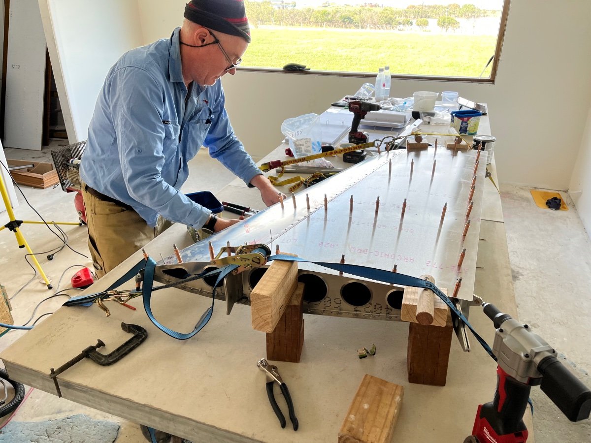

Monday/ tomorrow morning we finish the rudder. Nic had to go home for weekend. Happy wife, happy life.
Hoping rudder is straight and nice as first finished part.

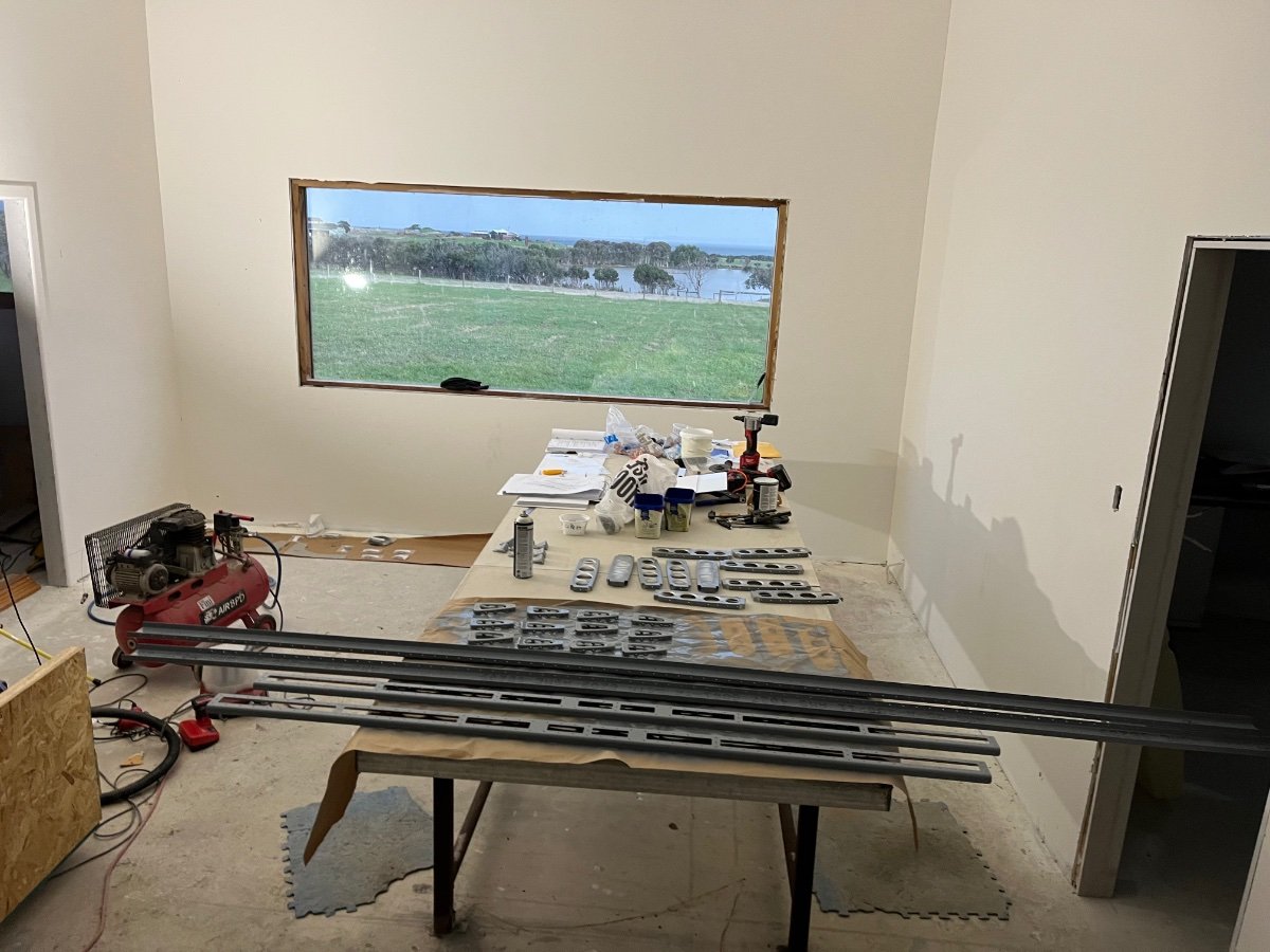

We have nearly all the tools now. Shipped from Aircraft Spruce and Henchman. Nic and I hope to  have the rudder, vertical and horizontal stabiliser finished this week. Nic will work on the wings and fueselage while I’m in USA.

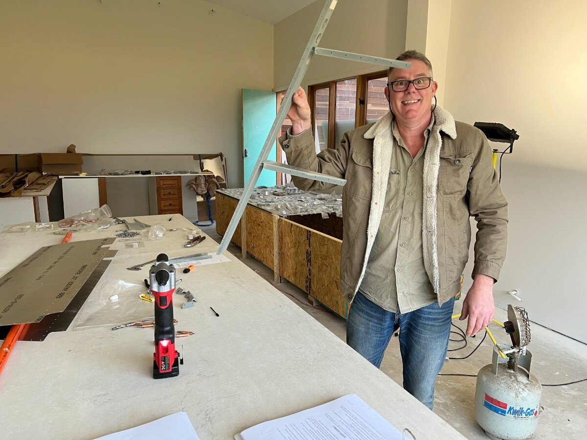

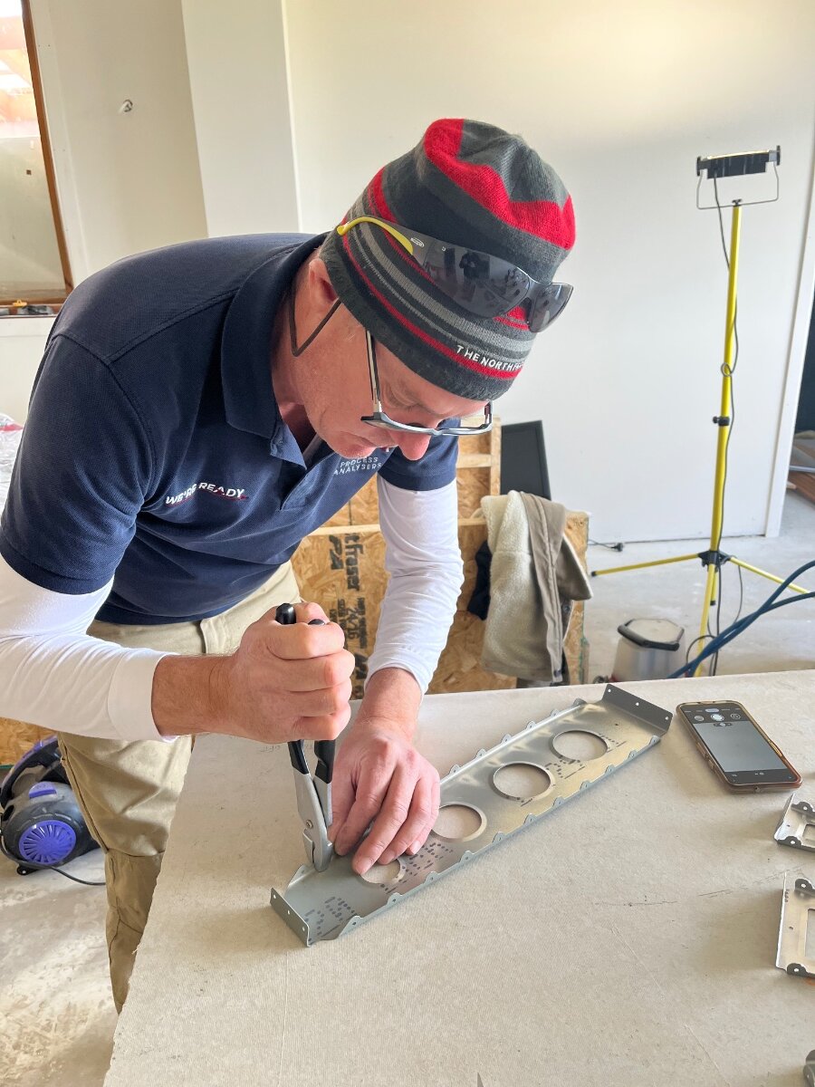

Last build day before I fly to USA today. Nic and I have an ambitious plan to build the horizontal stabiliser. I prepped on my own last night and it was a lonely old business for 3 hours getting all the bits sorted and appropriate areas (metal to metal) primed.   Very used to working with Nic and we make a good team. The bastard won’t come to OSH KOSH though. 😀 He’s flown remote worldwide locations for 20 years and I do get it. Retirement can’t involve international travel. This year! 2023 might be a new story.
Handy tips so far.
1. Have an experienced builder visit. I picked Rob up in the Nynja and we flew with some pretty awful crosswinds. Some 10kn beyind Nynja max and speed sorted it nicely. Couldn’t plan a calm day visit because of the USA coming trip.

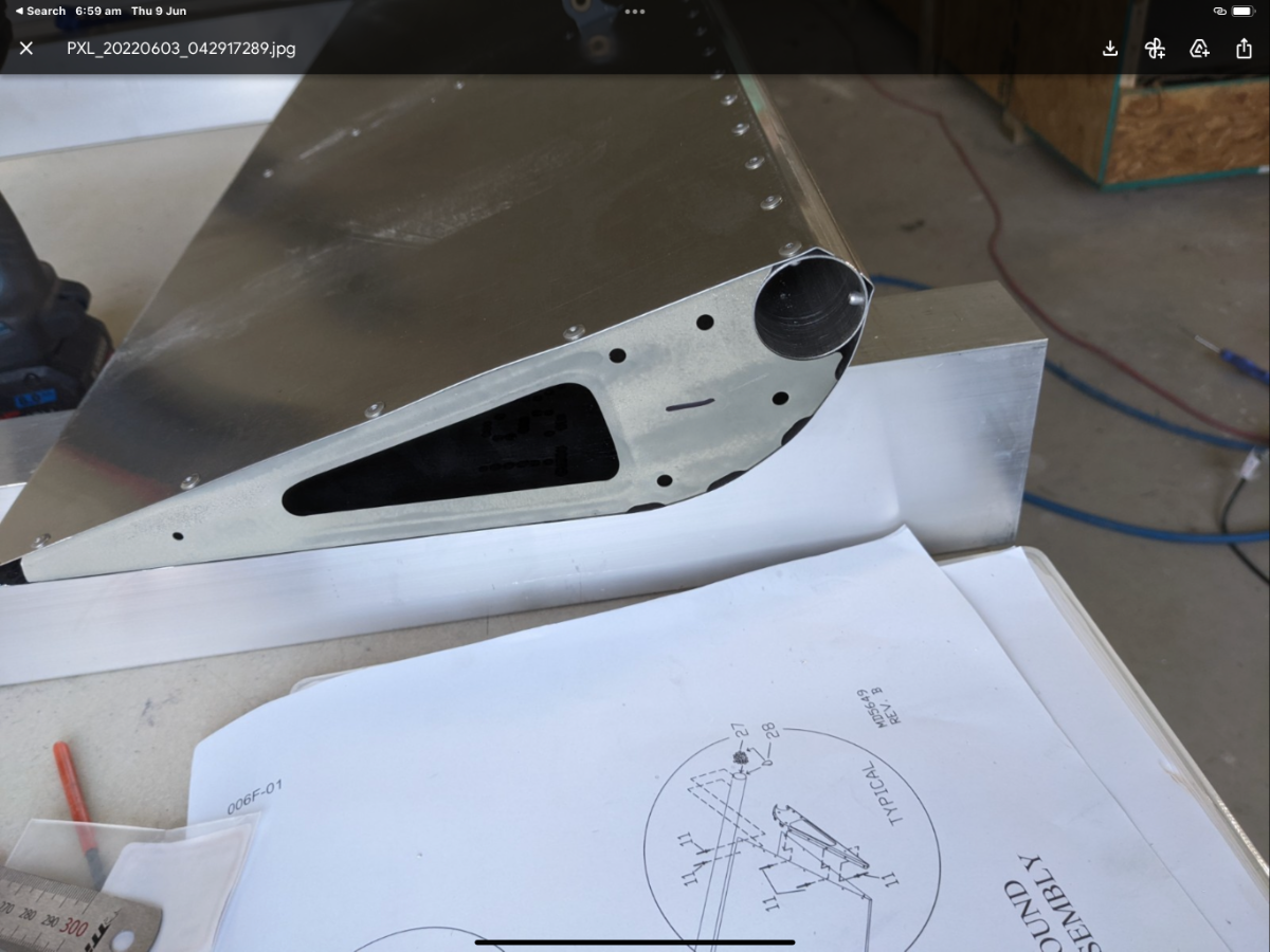

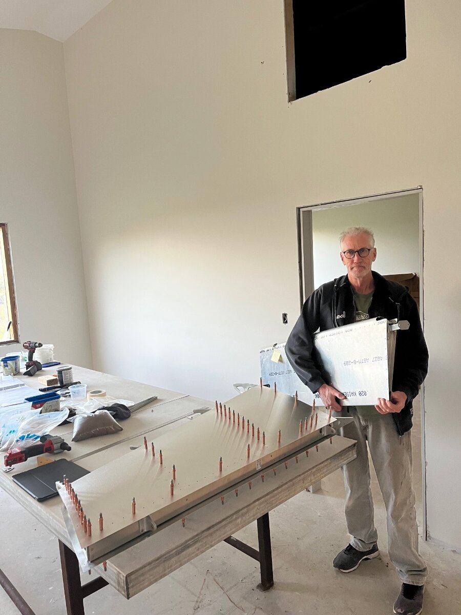

Pic below. Rob and Nic inspecting the vertical stabiliser. Rob was great value and I think it was mutual and he returned with renewed enthusiasm. That’s definitely a lot of what this is all about. We have an Australian, New Zealand and worldwide community of fellow builders. We can build, fly and visit as time goes on. Remote bush locations including our French Island runways easily sorted in the S21.
2. A3 folders. Rans has text, parts and figures. Parts and figures way better in A3. Rhythm is read the text, open parts and tick off each item, follow text, parts and figures along with a good dose of YouTube.  Clear direct is our favourite and combined with a few other builders for occasional detail.
3. Have all the tools. Edge former, fluting tool, reamer etc. There are a lot! Impossible to move forward without them.
4. Buckets for the rivets. Clearly mark the rivet containers and rivet discipline. A rivet can’t be left on the table. It’s in or in the correct bucket.
5. Inspection. We thoroughly inspect completed work. Found one proud rivet on vert stab and redid.
6. You have to assemble and drill a number of times then disassemble and deburr. Nobody likes rework. It’s just how it goes. Payoff on completion and it looks exactly right.

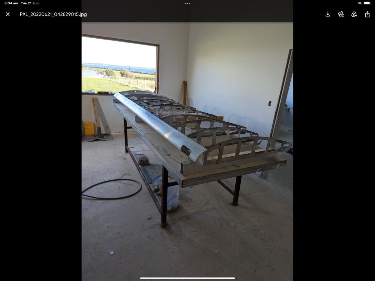

We jointly completed most of the back end. Nic has since completed ailerons and moving onto wings. We have Aerosport carbon dash and parts ordered for inclusion with August 20’ container to Australia with my Pipistrel tail dragger. I sold this so many times and it fell through that I’m now going to cut its 50ft wings down to 31ft and big bore the engine. Being done by an expert in New Mexico and I’m the test pilot and will help. I’ll just fly it out to a speed that is just below flutter and see if anything breaks off.

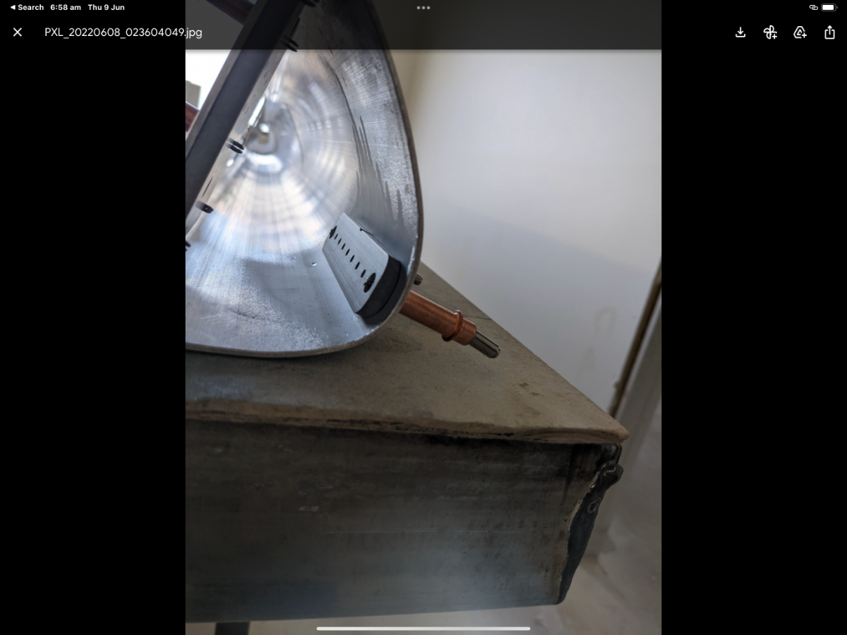

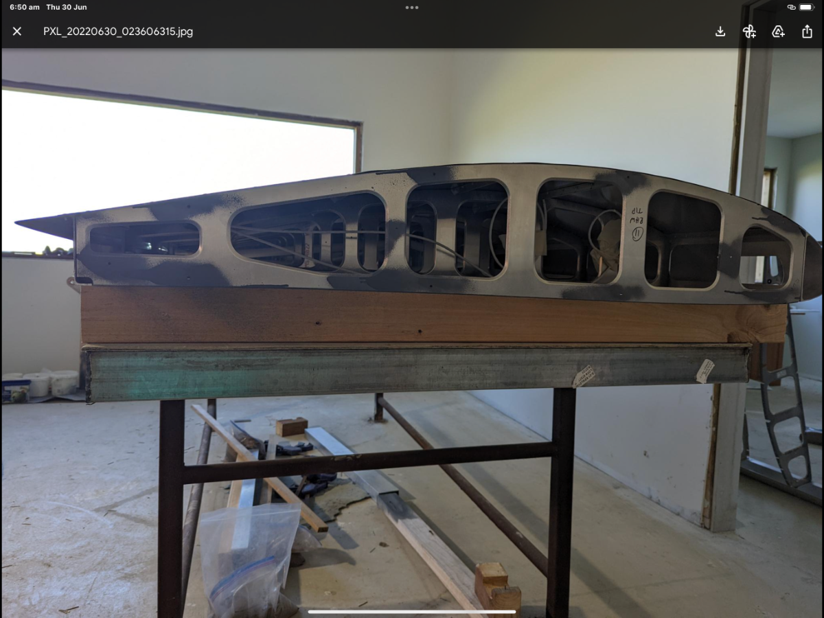

That D is the wonderful RANS wing leading edge. Great innovation. Makes it very difficult to stuff up. Hopefully.

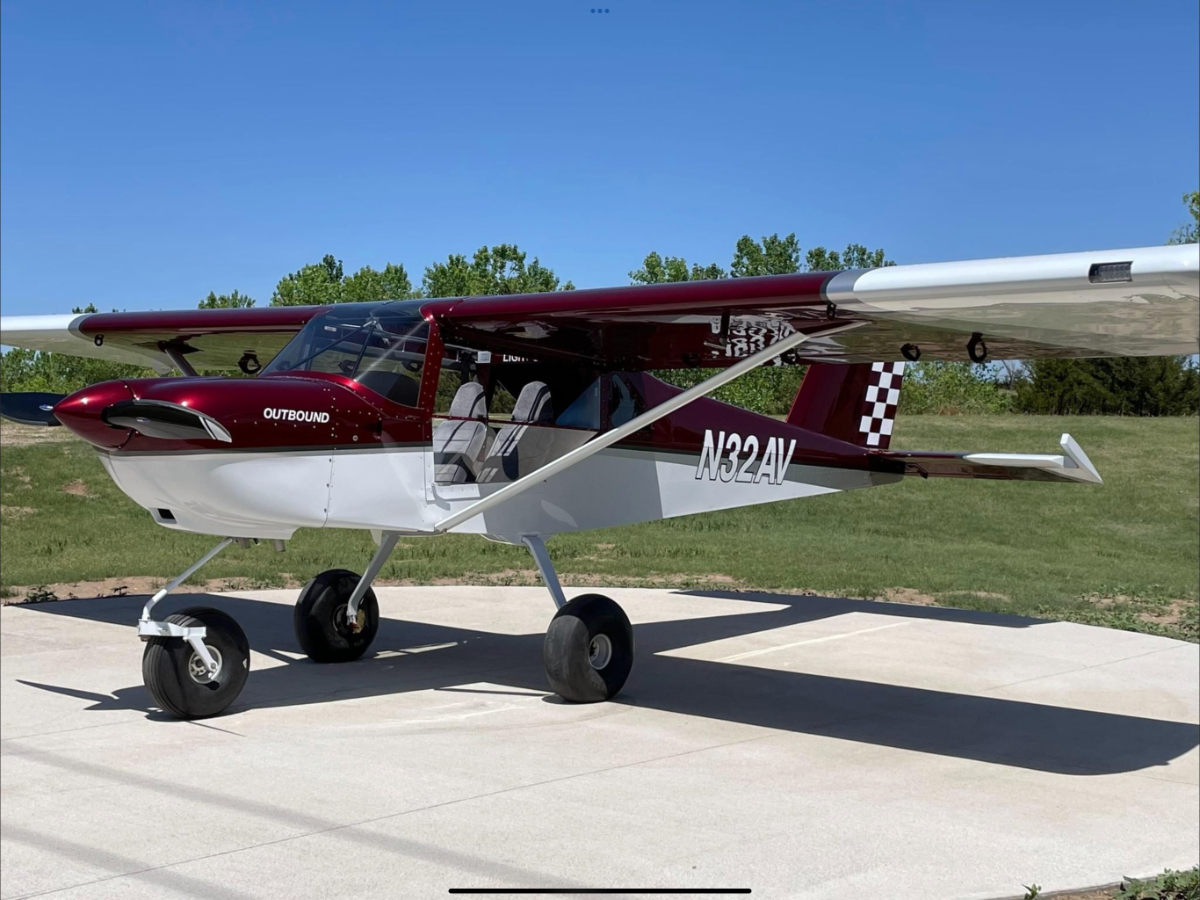

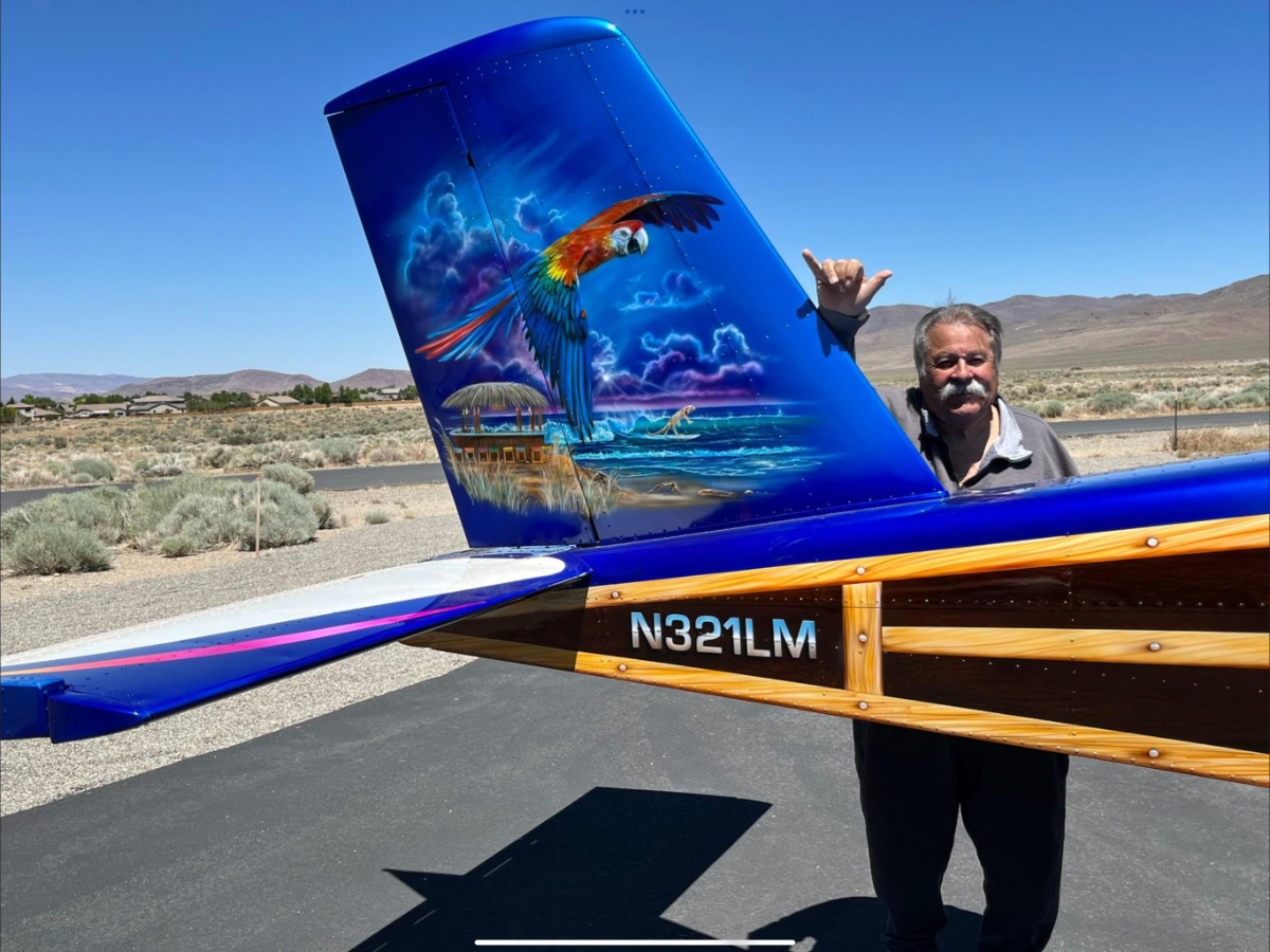

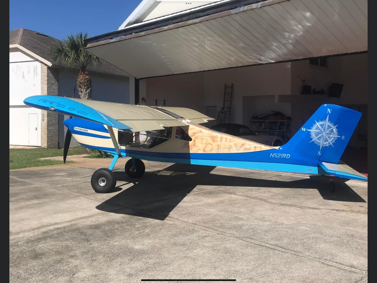

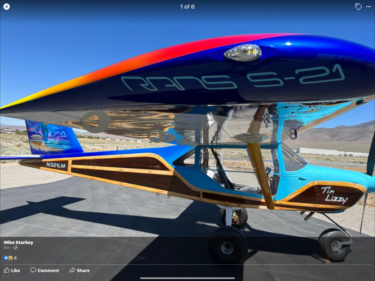

Here’s Mike Starkey and his wife’s completed build with an amazing paint job. I was following their build last year in an American flying magazine. Lots of clues on electrics and I was worried about these more than anything else. Nic being an electronics guy fixes all this!
Might borrow some of this great airbrush concept with a koala island theme as long as the koala has goggles and a machine gun. (Cuddly cute koala isn’t going to work)

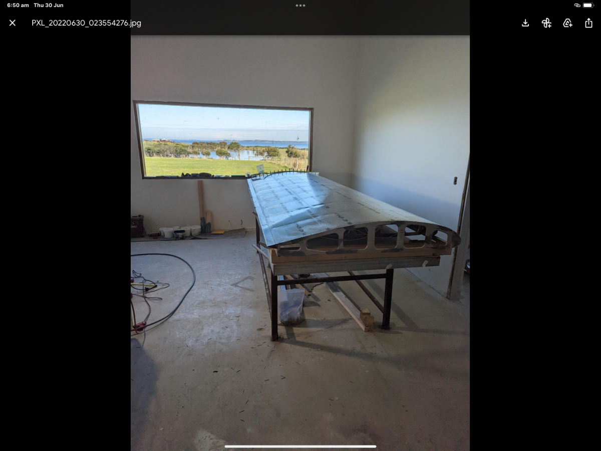

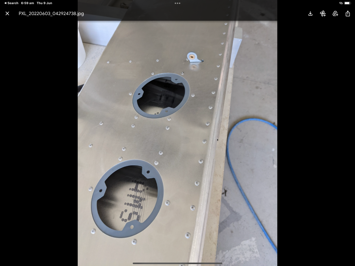

Nic is onto the wings… D leading edge now has light hole cut and we air freighted the lens and lights.

Reality is we likely will  be the red, white and gray of the S21 pictured with the Rans green substituted for red. Notice the VH reg on that aircraft. Early Aussie build.

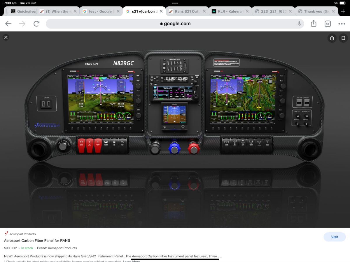

Here is a dash comparison with carbon fibre dash from https://www.aerosportproducts.com/product/s-21-carbon-fiber-panel/ Great care has been taken in the layout. It’s both beautiful and economy of eye movement across displays with circuit breakers down low.
 I designed dash concepts for quite a while and as soon as I saw that carbon dash from,Aerosport and the beautiful switches (these can be custom named) I threw my concepts out. No ego involved. If somebody else can do better I’m happy to pay them.

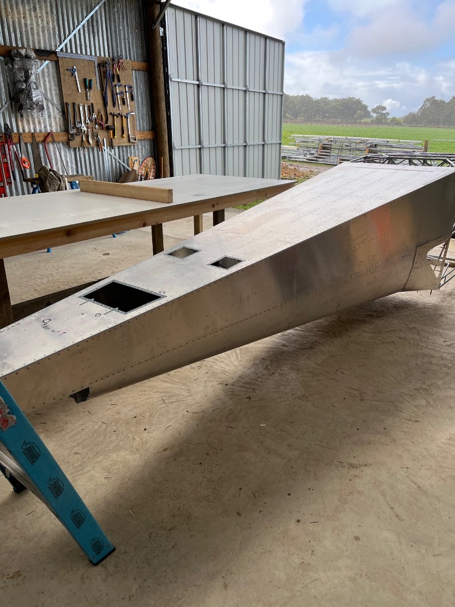

Wings complete. Nic is working on fuselage. I think I’ll be coming back to a complete aircraft. Means we can get working the second one as well as starting on the finishing. I know when you lock a house up you’re only at the half way point. Aircraft… I’m guessing you are not half way!

In the picture it looks like Nic has left fitting the under wing skin for you to fit 🙂
Ha! I think this was left open for inspection and he’s moved forward since. Well, that’s what he tells me. 🤔

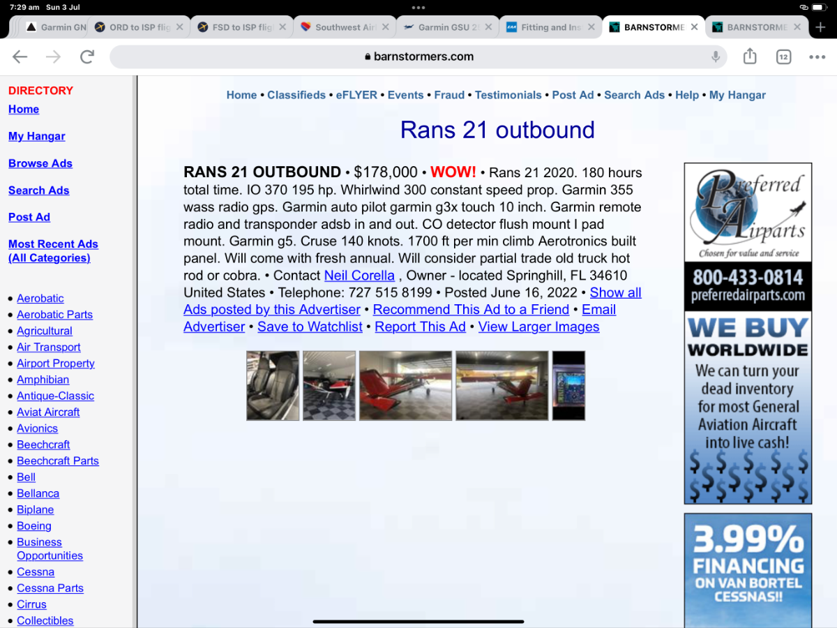

Here is a Rans S21 for sale in USA. A couple of interesting things. It has 195hp and 140kn  cruise. Be very interesting to see what the 220hp pushes that airframe along at. I know it’s draggy and the HP is giving us the cruise. Titan 180hp 135kn cruise. This Lyc 195hp. 140kn cruise. Probably 145kn cruise as long as Nic pays the fuel tab.  I flew with Randy and he pulled back to some 115-120kn cruise to show fuel consumption similar to a Rotax.
Also, the price. That S21 in advert below is pushing  270k AUD on current exchange rate. We have as 5th share importers (container split cost) some 70k in each aircraft as supplied by Rans. Well, we have tricycle kit now so say 75k.
Engine. The 220hp ULPower will be landed at approx 80k. Note, the turbo bumps the price quite a bit.
Avionics. Dynon or Garmin with dual 10” touch, GPS and autopilot some 50k plus or minus.
CSU Prop. Some 15k

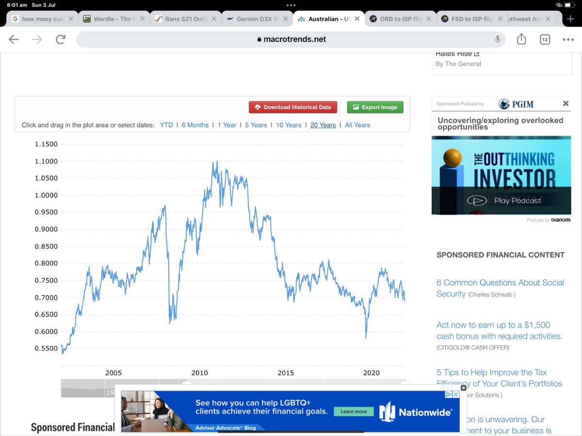

Approx 220k. Plus other misc stuff. All prices AUD. Note.. I’ve been exchanging AUD/USD for some 30 years as importer/ exporter.
I’d hang off if you can afford to wait on an exchange improvement. Currently any USD I have are going into AUD. I’ve learned not to give money advice. However, exchange rate has fair certainty but don’t bet that farm. It’s all in that chart below. Pretty obvious.
I purchased a house in USA in 2011 at parity. I think that’s when our idiot government started closing the car industry. Sold last year and will flip those USD to AUD about now. Some 50% gain minus 15k a year in USA property tax. Lincoln NE some of the highest taxes in USA!

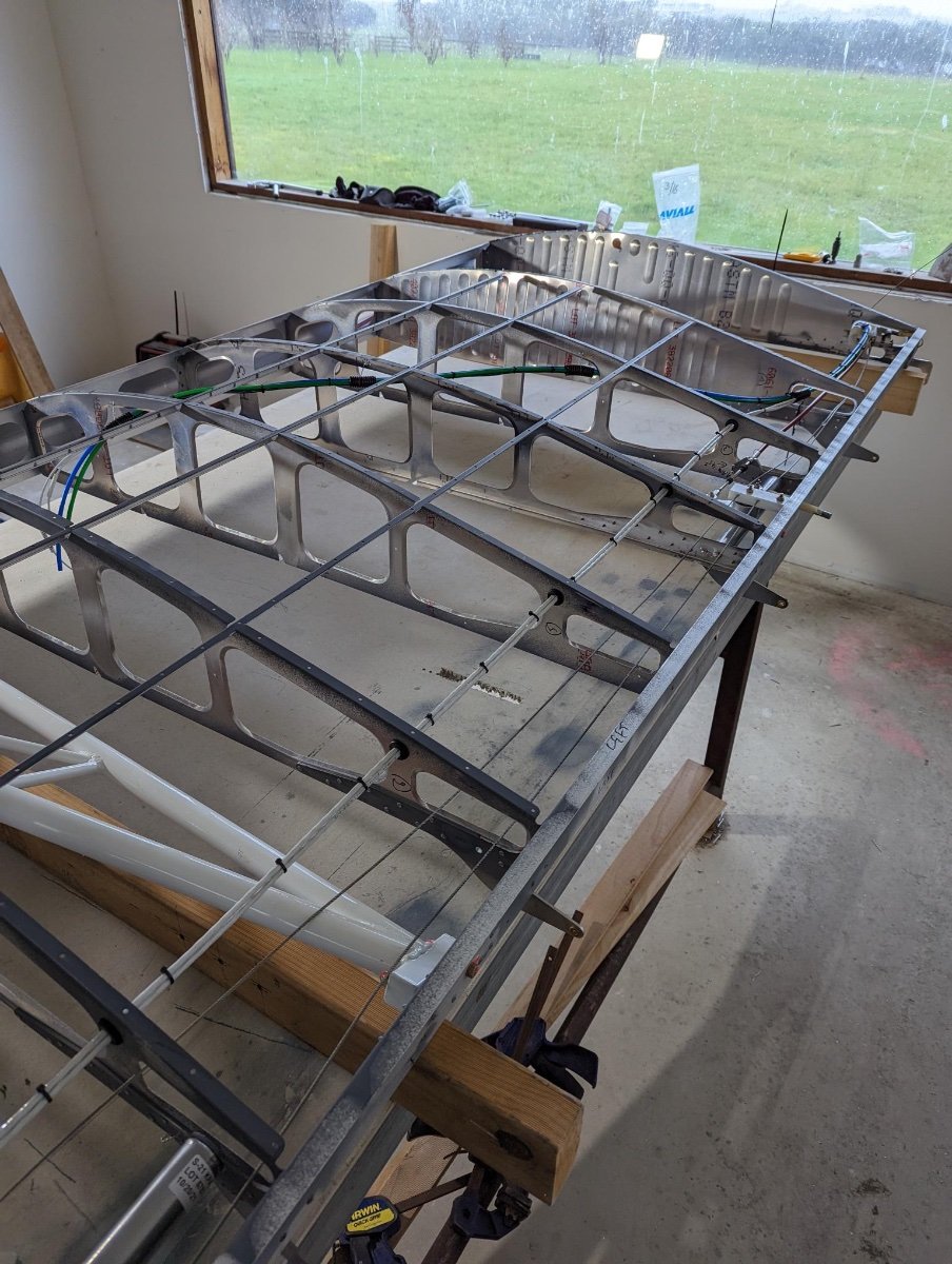

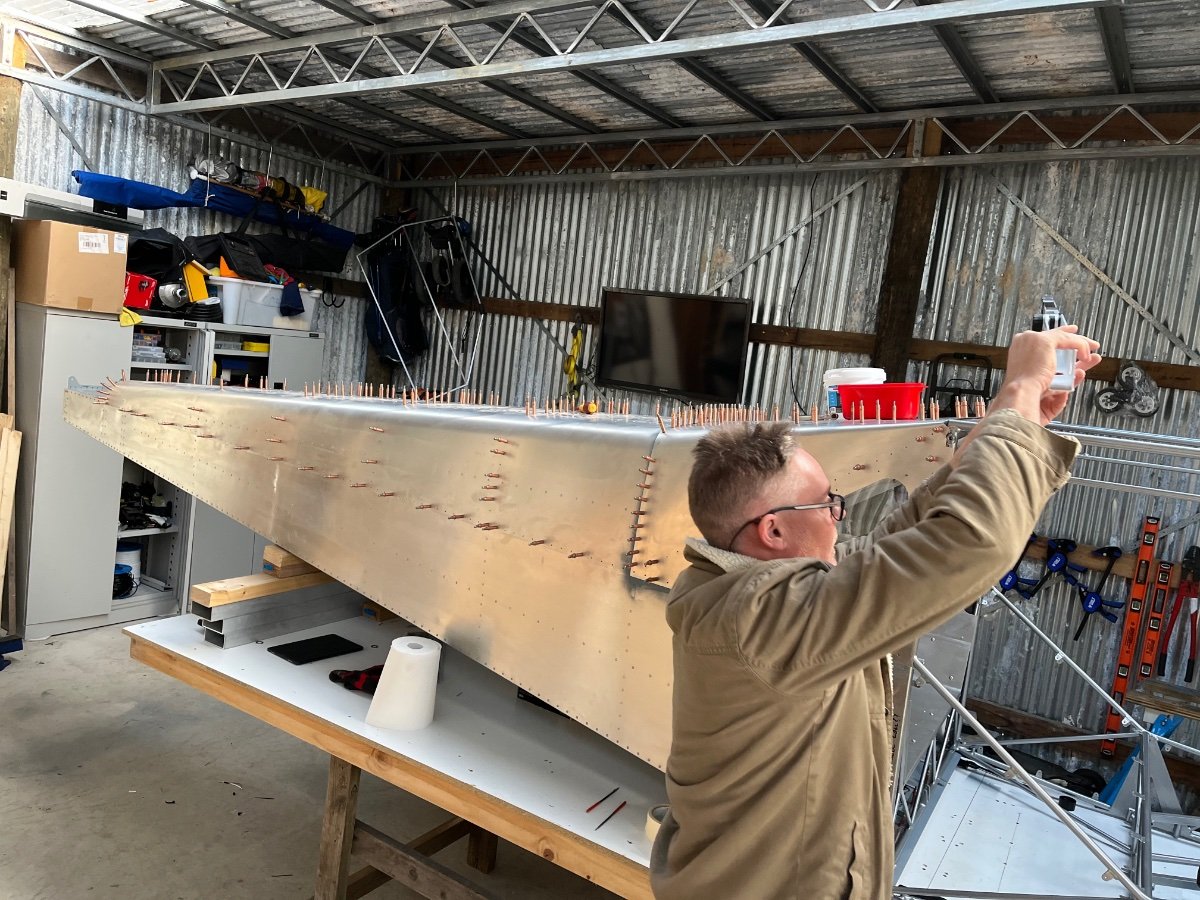

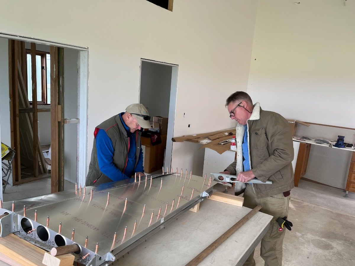

Update. Inspection in next few days and this is second wing. I was a bit ahead…Looks good to me!

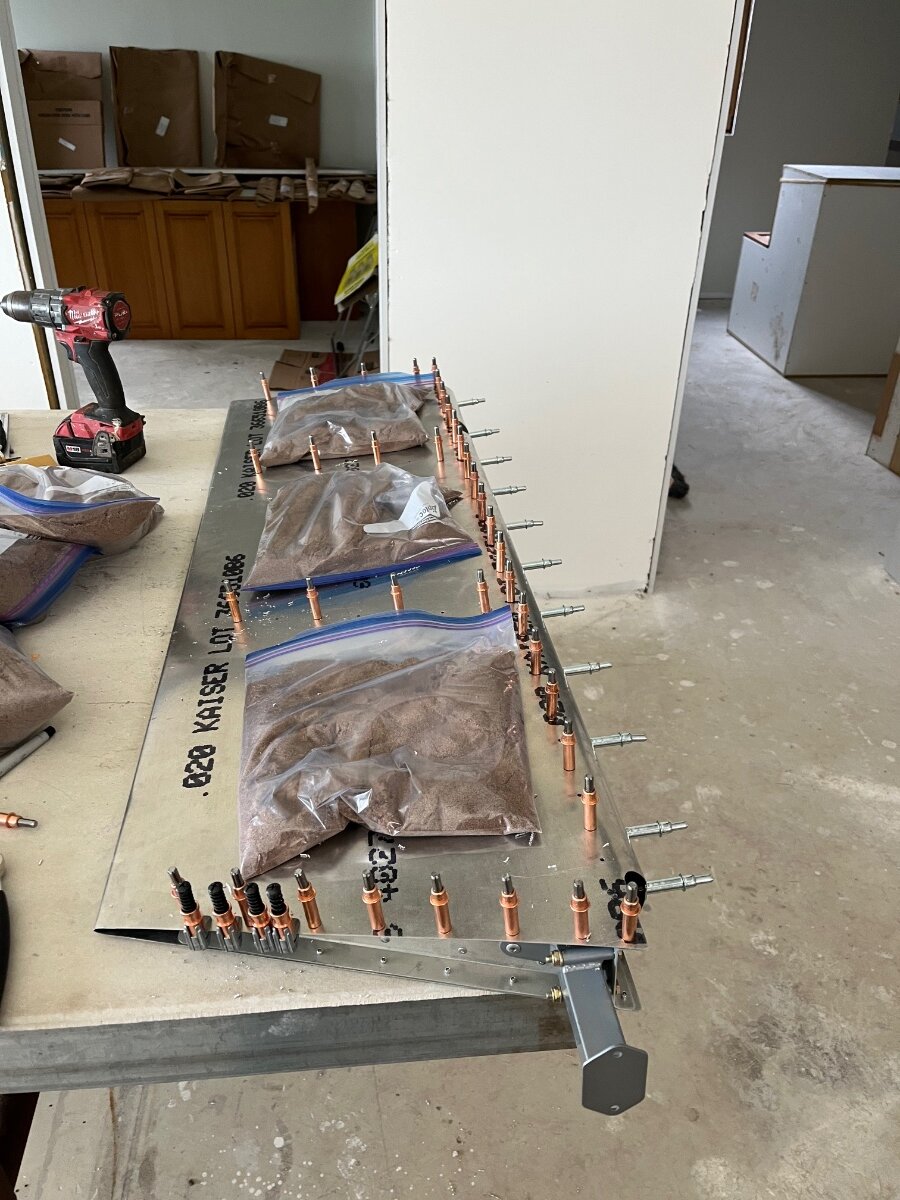

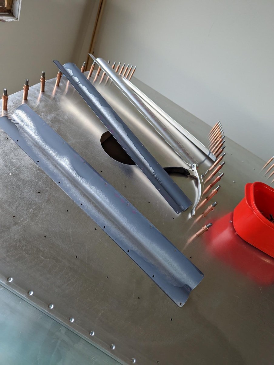

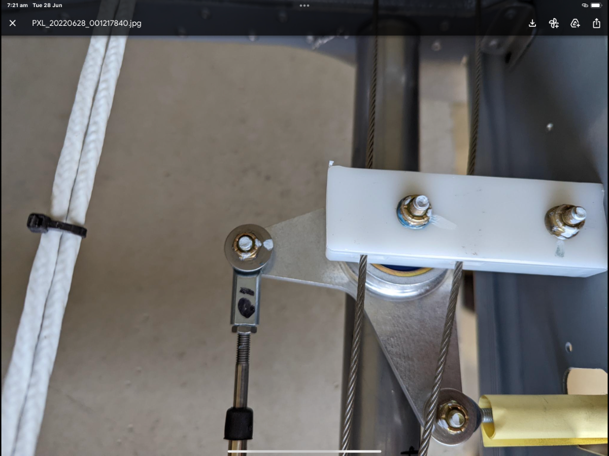

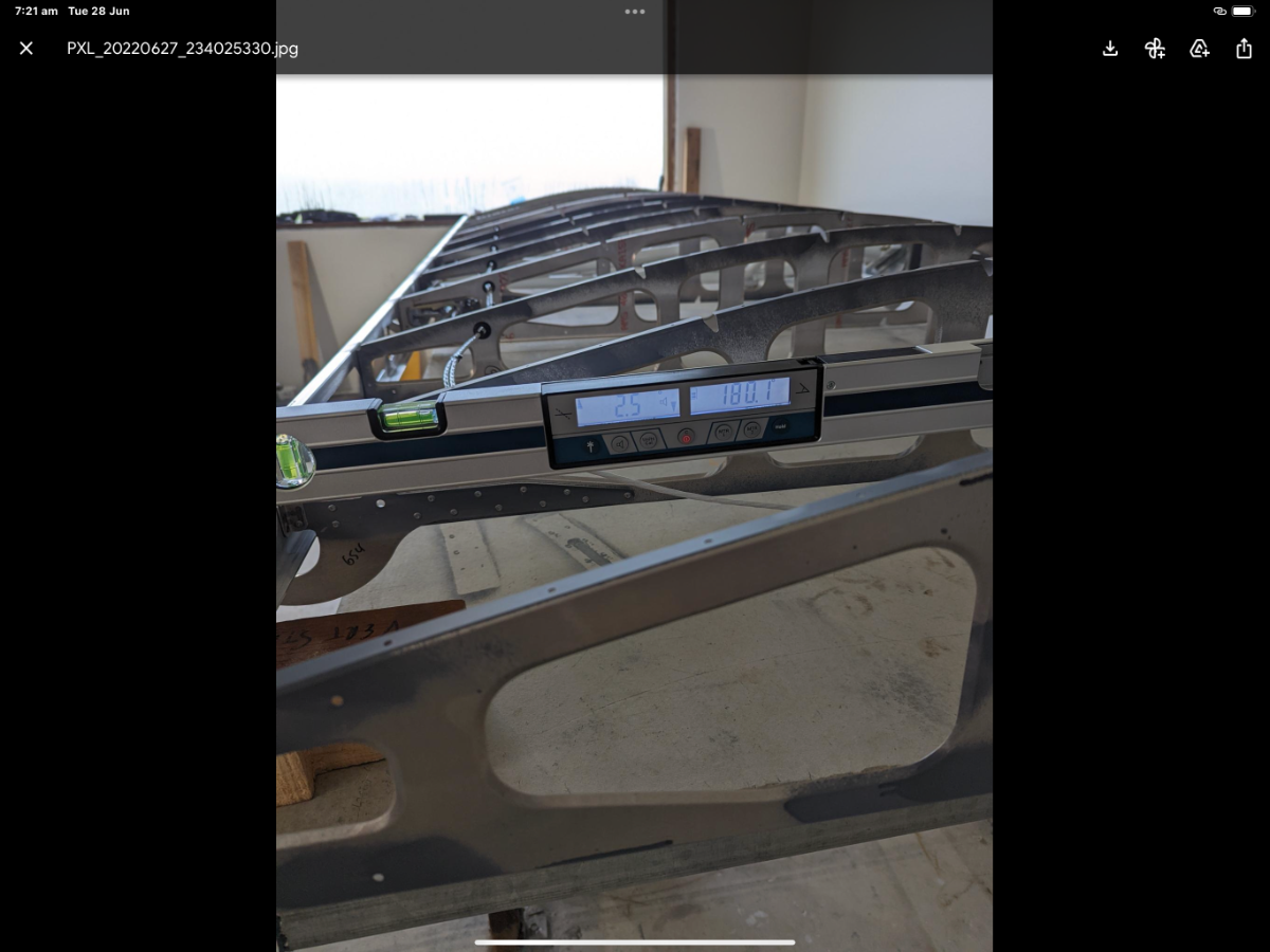

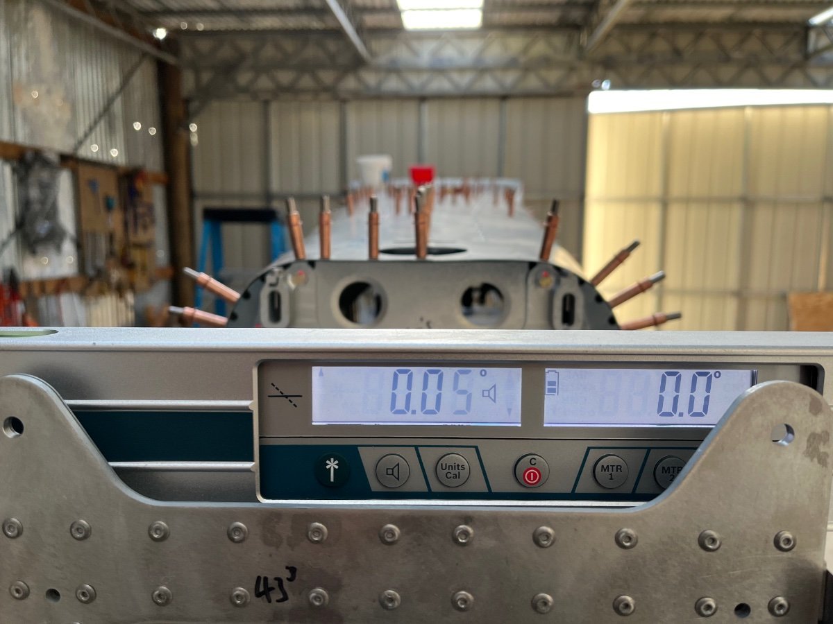

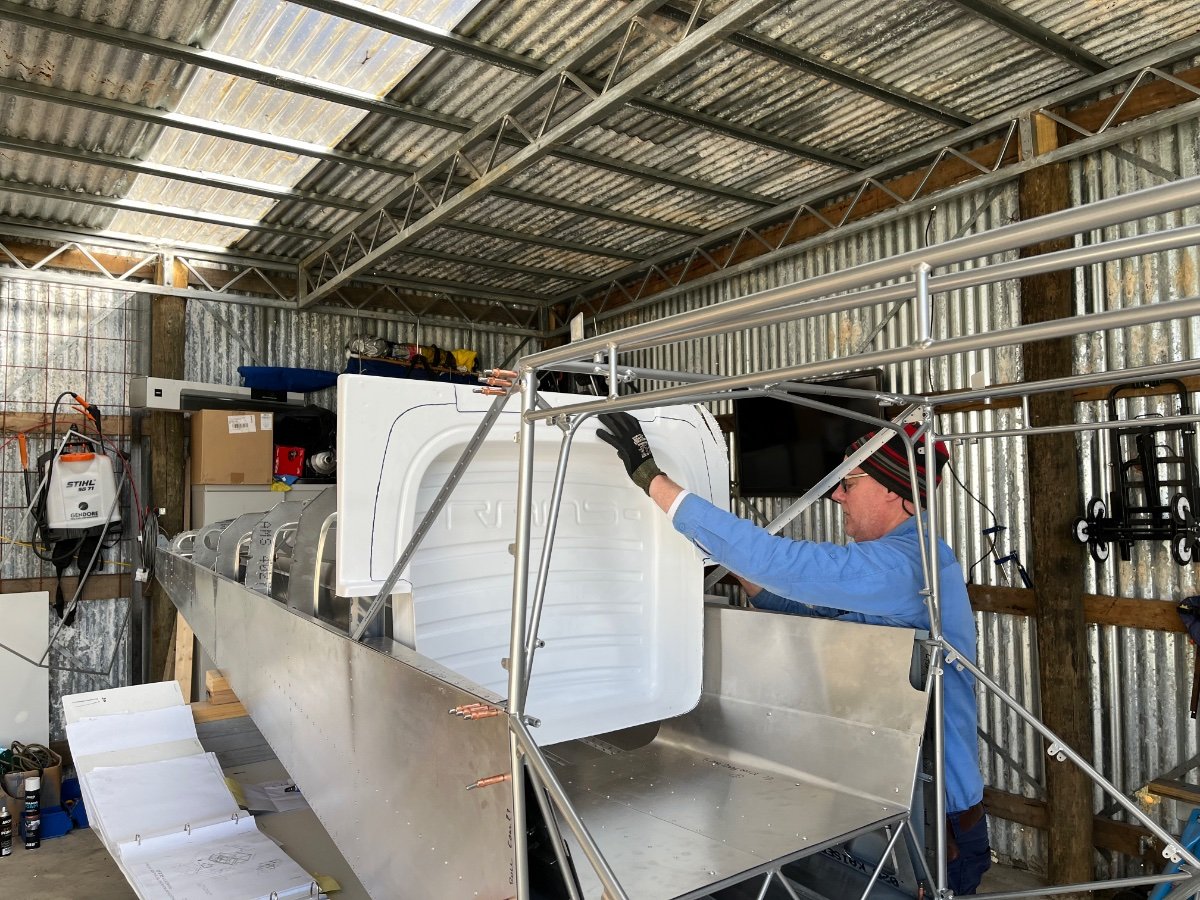

Progress. Plenty of YouTube’s along with the manuals. 05 degrees out then when we finally finished riveting we were 0.00 fore and aft. Nice to have it tweak itself perfect.
That baggage compartment is a little tricky. We ended up quite neatly fitted.
Wheels next after floor pan tomorrow. Only been back a week and we have made heaps of progress.
