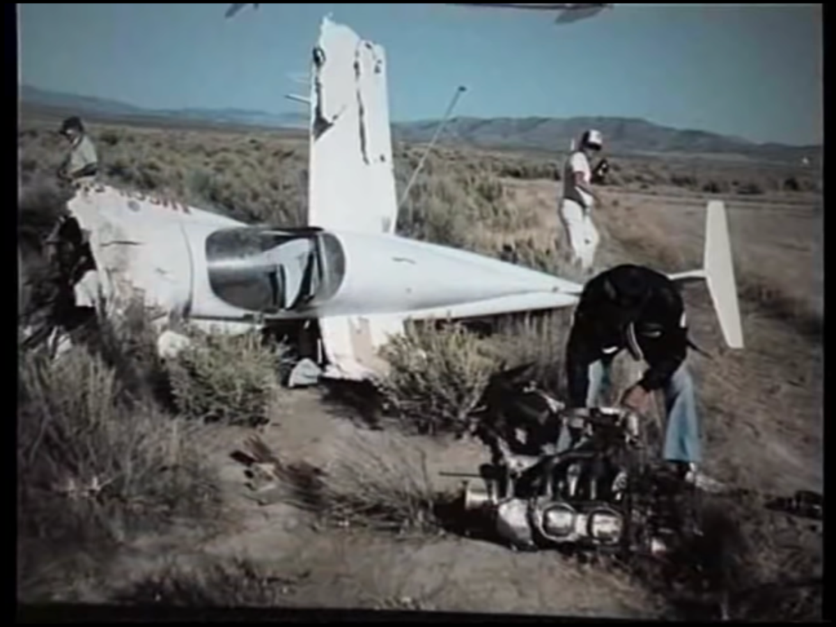

Mike Gearon Posted July 9, 2022 Posted July 9, 2022 A couple of things stand out on that video. 1. He take a copy of Fluid Dynamic Drag on holiday. I get a kick out of people,who are way more quirky, almost makes me look good.😀 didn’t expect to watch the whole video. Thanks for sharing! 2. Flew a 300kg all up fuel and pilot to 170kn plus, set a world record, smashed his aircraft up at that speed and walked away. All remarkable.
