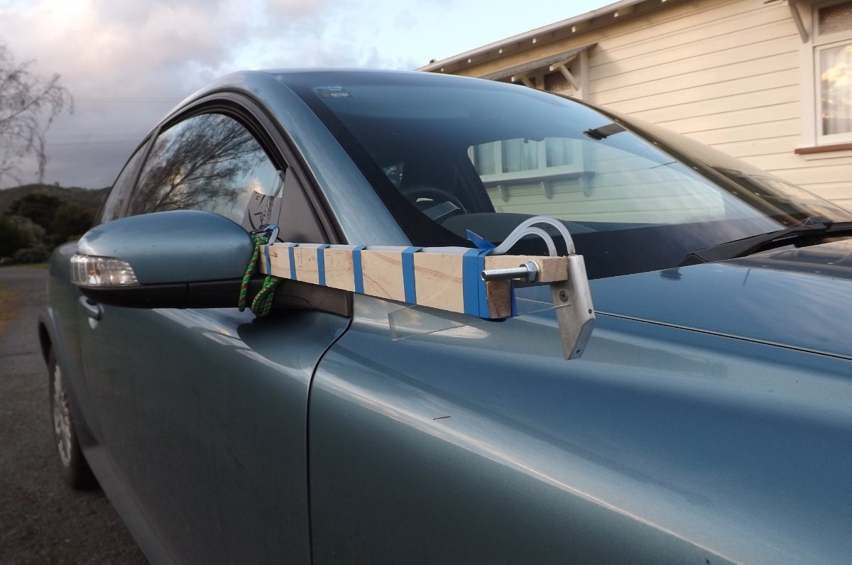

Here is a pic of my Mk1 probe, lashed to the Volvo for ground testing. The neighbours took to twitching the curtains as the wife and I made numerous runs up and down the street at various speeds and various pitot angle settings...........)
PS: I believe Dynon offer a 2 port pitot head which then enables their A of A option.
They make good gear, so I would expect it to work well. However, the readout is (I think) down with the rest of the glass cockpit stuff, which is not where I would want my eyeballs on finals.
The audio system mentioned above is a possible workaround for that. It will be interesting to see how well that works in practise.
