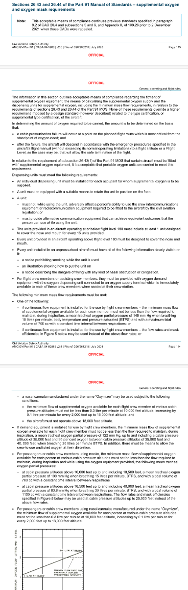

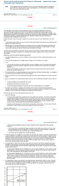

Ian Posted August 23 Author Posted August 23 The relevant information. Acceptable means of compliance and guidance material General Operations and Flight Rules Part 91 of CASR Above 18000 you need a mask that covers the mouth and nose - below that cannulas are sufficient. Flow rates are specified and oxymiser cannulas are specifically stated to meet lower flow rates. 1 1

facthunter Posted August 23 Posted August 23 I don't seem to be able to enlarge that plus the Maker of the Best brand stated only OK to just over 13000 feet. I used to regularly go to Lae from Moresby at FL180 unpressurised. You need to know what you are doing. Quite a few People have come to grief.. It had a mask with a diluter demand system, including a Microphone. Nev 1
Ian Posted August 23 Author Posted August 23 13 hours ago, facthunter said: I don't seem to be able to enlarge that plus the Maker of the Best brand stated only OK to just over 13000 fee Not sure what the Best Brand is. Easier to read as part of the PDF so the link has been provided. The key points oxygen may have benefits even below 10000 especially at night, if you're older or you're an ex-smoker or fly at night. Put simply your judgement and ability to concentrate are likely to be better. Because you're not consuming a limited supply from an O2 bottle and the fact that you can now easily monitor your O2 levels it does provide options which in the past were simply not available. https://www.casa.gov.au/resources-and-education/publications/guidance-material/acceptable-means-compliance-and-guidance-material?search_api_fulltext=&dt_published[min]=&dt_published[max]=&field_tx_rules_part=71 Inogen appear to be pushing their device as being suitable to 18000 feet. https://www.inogenaviator.com/ 1
