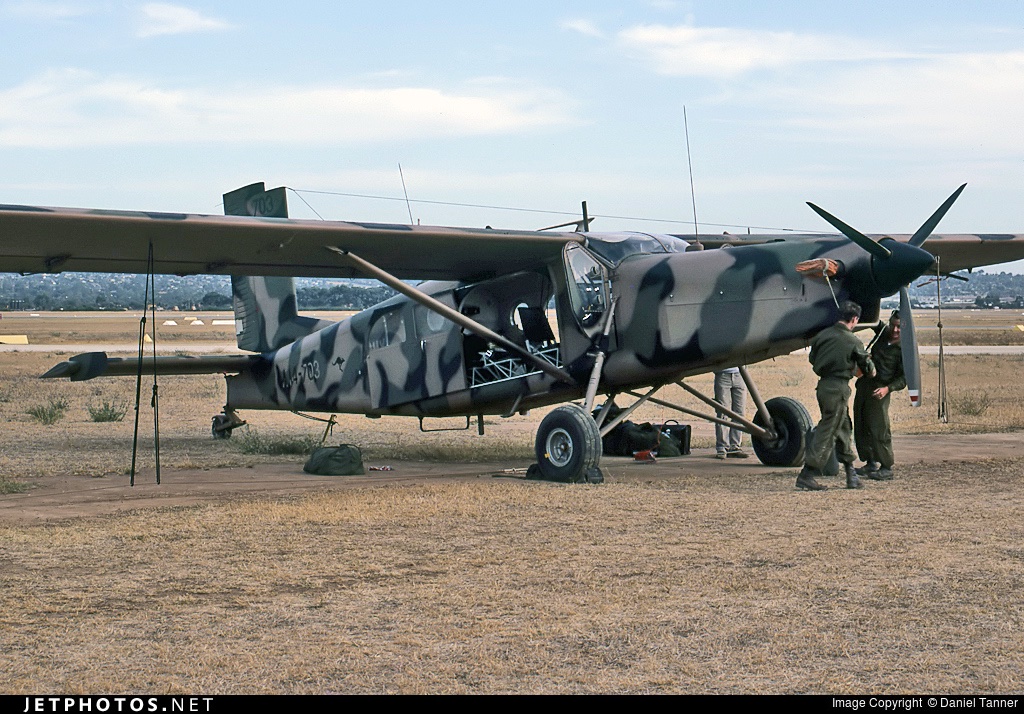

eightyknots Posted October 9, 2021 Posted October 9, 2021 On 29/09/2021 at 11:38 PM, jackc said: Now for another crazy off the planet paint idea 🙂. My Thruster came with a spare set of skins, I need to somehow get them tested to see IF they are serviceable. IF they are OK I was going to try and ‘paint’ them with this paint scheme. So, any ideas IF this would be doable? Jack, I am a bit worried about flying over terrain, with your aircraft painted like this, and then not being seen by other other pilots. 1
