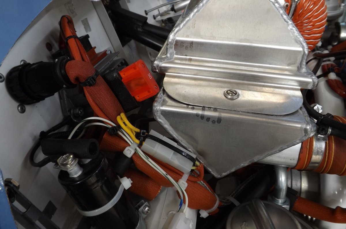

Is this it?
My yellow alternator wires come up to a connector. This has a mating connector, and the wires from that then go up to the regulator.
That's the connector, cable tied down and together at lower centre of the pic:
  • Helpful 1
Ah - that must be it.  I plugged the generator wires straight into the regulator.
Is that perhaps for engines that are mounted further forward?  Mine reached the regulator fine, so not sure that I need to use the extension.  Less connections would be better I assume?
Yep, provided there is enough cable to route it so that you can secure it to the engine mount etc.
