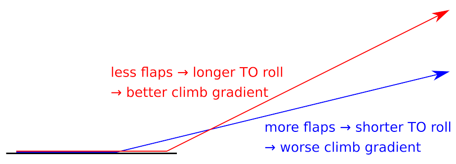

2 hours ago, anjum_jabiru said:
I think this makes a lot of sense. The reason you apply take-off flaps is not to increase the lift. It is actually to increase the drag, without affecting the lift too much. This gives you a steeper climb path (if there is such a thing), making it appear as though you have a better climb performance. What is actually happening in reality, is that you are able to climb to the desired height, within a lesser horizontal distance travelled (due to the drag created by the take-off flap).
On applying take-off flap in a glide, once again the horizontal distance travelled will reduce (due to the increased drag), without much impact on the lift being generated. Hence your glide distance (horizontal distance travelled) from a given  height will reduce. Thus causing a deterioration in your glide performance!
This diagram shows the effects of flap on takeoff.
I never use any flap for takeoff except if the ground is soft or the grass is long or the field is very short. Cessna recommends no flap for TO in the 172 POH but many instructors advise 10 degrees anyway. I don't know what is in the Jabiru POH but all (3) Instructors have advised me 1/2 flap for the 160, 170 & 230. On a T&G for me it is full power, flaps retract (electric), stick forward to gain speed & then full climb, all in about 5 seconds.

Hi kgwilson, when I did a few lessons on a Cessna 152, it was from the shortest licensed grass strip (490m), in Netherthorpe, UK. The instructor used to use 10' flaps and called it the "hedge" check. This was to ensure you clear the hedge at the end of the runway.
I think it's a good idea to use half flaps so that you can be airborne asap, and start climbing, in case you have an engine failure and need the runway ahead of you. Besides, one never knows,  but you might need the runway for a longer than usual run on a hot day or high altitude.
I  completely agree with regards to retracting half flaps and full power. The only issue is, that in the 3 to 5 seconds it takes to retract the flaps, and push the carb heat in, one can chew up to 100m of useful runway in a t&g, if you are travelling at 50knots. May not be very practical, while landing on a short runway, if you are already 200m into the runway during your landing flare.
The best option may still be to go around with full flaps, with nose forward, and retract flaps once you are established in a climb.
On many aircraft with full flap down you really won't go  very well at all as far as climb performance is concerned. It's the excess power over drag that permits climb. When you don't have it you don't climb. Larger flap angles have much more drag than extra lift. Some flaps don't provide a lot of extra lift at all. They mainly give you a steeper approach.
