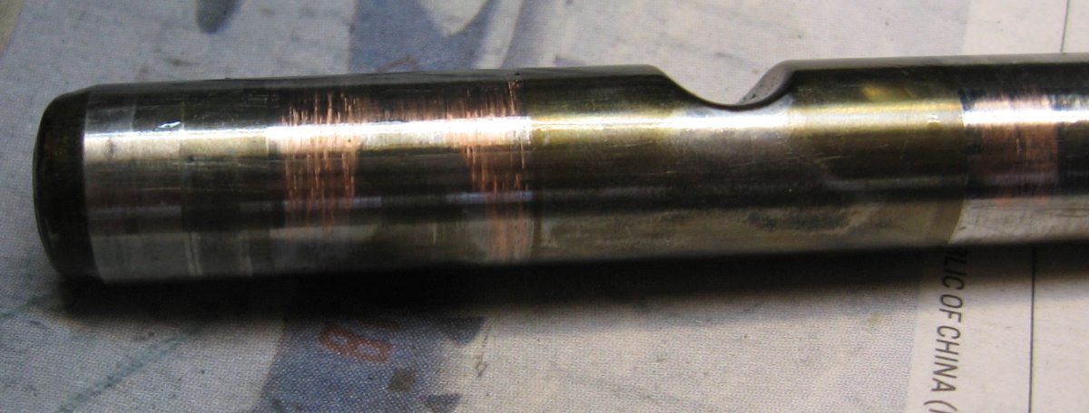

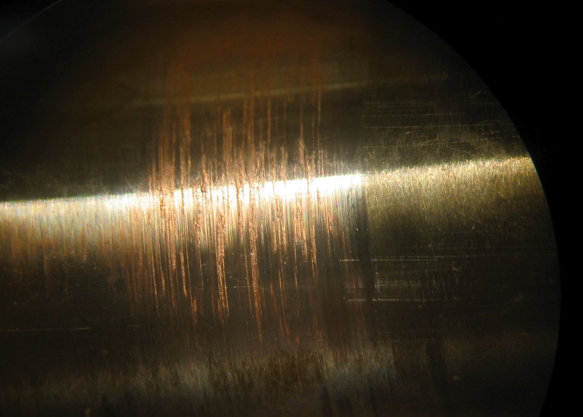

RFguy Posted March 11, 2021 Author Posted March 11, 2021 (edited) Replacing rocker bushes... rocker shafts measure well. bushes measure 0.2mm beyond spec (in one axis - the wearing axis.) The rocker shafts at the front of the engine have little/no deposited bush material and no scratches. #6 is the worst, they get worse steadily toward the rear (last to get oil supply on start ? lowest oil pressure ? hottest ? ( a bit) ? very soft material, scartches flat with a fingernail. looks like copper. might do a chem test on it. to find out. will inspect push rod ends and oil supply shaft etc , and return . the very rear is the worst. attached : Edited March 11, 2021 by RFguy 1
Thruster88 Posted March 11, 2021 Posted March 11, 2021 Looks like the surface finish on the shaft is a little rough. 1
RFguy Posted March 11, 2021 Author Posted March 11, 2021 and smooth on the other side. I think material has come away and scratched. they'll all get polished flat. I will leave the copper in the grooves. The ones at the front of the engines are near unworn. progressively gets worst toward the rear. The binocular microscope is always handy... There are plenty of good 10x to 50x monocular hand held tube scopes that are very useful to have during aircraft maintenance- particularly a type that has a built in light source (essential) . Even a handful of loupes of different magnification sis excellent for examination in situ.
Bruce Tuncks Posted March 11, 2021 Posted March 11, 2021 Great pic glen. It looks to me as if there was something scratching the surface. But it also looks like the scratches are longer than the rockers would make.
RFguy Posted March 11, 2021 Author Posted March 11, 2021 (edited) Bruce well spotted. #6 was the first head I did - I was figuring how to get the shaft out (turns out just drive it out...) and I had rotated the shaft with the slotted end driver. That of course is only to get the keeper notch in the middle aligned, not for anything else. so I would say some of that scratching I did with I rotated the shaft . Of course there is still quite alot of bush material in there, and much more at the rear as I said. at the front, almost imperceptible .... (and the bush wear is 50% less at the front ) Edited March 11, 2021 by RFguy
facthunter Posted March 11, 2021 Posted March 11, 2021 It's a crook (ground) finish and I'd do a hardness check..Nev
RFguy Posted March 11, 2021 Author Posted March 11, 2021 Hi Nev. OK, yeah. what's the bushing material- a bronze ? although, I could swear it looks like some sort of aluminium bronze allot that I have seen before. Can do a chem test on it I guess. glen
facthunter Posted March 11, 2021 Posted March 11, 2021 It's not plating. It's there because the oil film has broken down or the bronze is too soft. How strong are the valve springs at full lift?. Aluminium bronze is critical to lubricate and difficult to machine. Best small end boring is by a diamond tipped boring bar. The best small end bushes I've used are steel backed copper lead and rolled strip. Nev
RFguy Posted March 11, 2021 Author Posted March 11, 2021 single spring setup : 6kg from memory. double spring is 5kg + (inner small) 1kg I will get a bush out and have a good look at it. they all have to come out anyway and get back to you.
RFguy Posted March 11, 2021 Author Posted March 11, 2021 also, there are NO longitudinal (lengthways) marks present due to driving the pins out (wooden dowel , hard mallet) .
facthunter Posted March 11, 2021 Posted March 11, 2021 The springs aren't exerting any pressure either. Those valve spring figures seem far too low. Don't have the bushes with too little clearance. There must be no chance of any seizure. They only wear on the bottom and a bit of slop doesn't matter. Nev
RFguy Posted March 11, 2021 Author Posted March 11, 2021 thanks Nev Yes I did ask myself why a bit of slop isnt a bad thing. the hydraulic lifters will take out the play. We'll see that the new bushes measure in it when they arrive tomorrow. $5 bush. not much.
