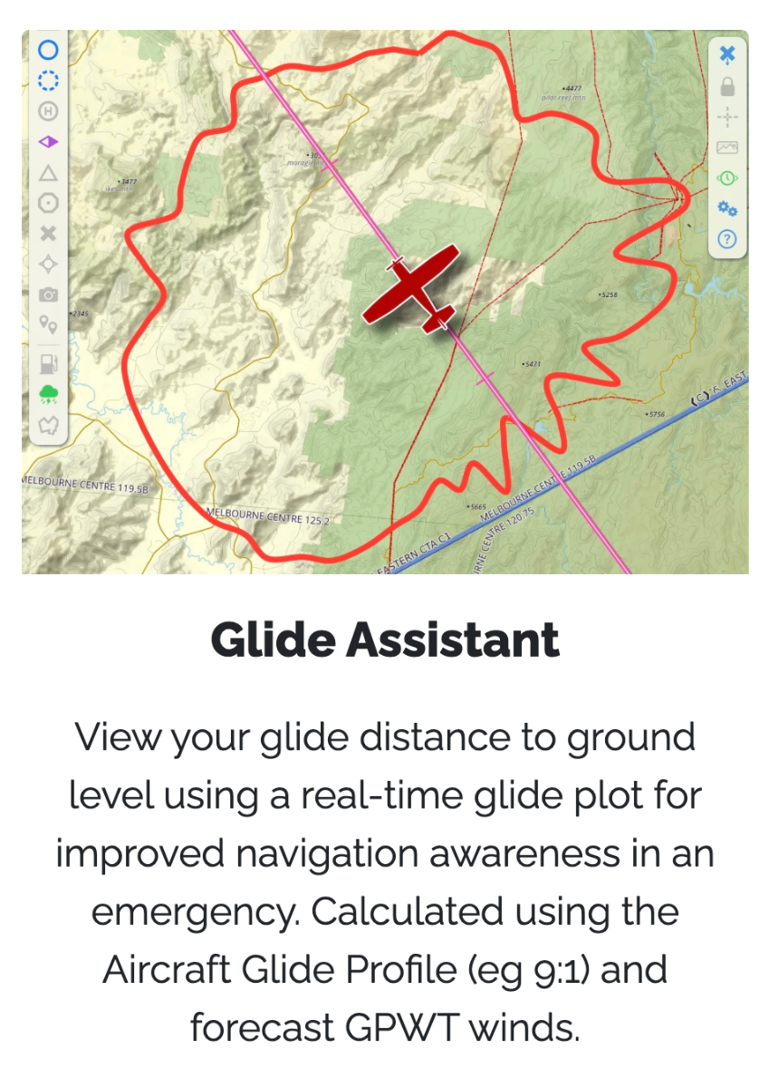

Also, I've been playing around with  OzRwy's Glide Assistant in a simulator.  It can can be used in planning and/or in real time. Not sure if, faced with an engine out situation you'd think to consult it but a quick glance might suggest a direction for longest range - in prevailing winds aloft.  Anyway, it automatically cuts out at 1500' AGL probably in order to suggest that now is definitely look-outside time.
User guidance here (18.5) :
DOCS.OZRUNWAYS.COM
