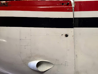

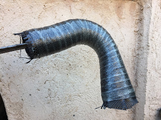

Garfly Posted June 16, 2022 Posted June 16, 2022 16 minutes ago, IBob said: And that's really cleaned up and fast for a Jodel. Very small air intakes...... Yes, and if you read his blog around 2018/19 you can see that the clean lines are no accident (a random sample): "January 1st. 2019 Cover, oil cooling air outlet. First of all, happy new year to all and full of success in what you are about to undertake. For my part, I hope to beat a new speed record this year and fly at more than 130 kt. I don't like to redo what I've already done, but yet it was necessary to redo the oil cooling outlet air duct for the new hood. However, I made a few minor changes. First a curvature a little more studied than the original basic bend (first photo) with a slightly larger bend radius and a slight converging in the bend to locally accelerate the flow and avoid separations in the bend. Finally, the outlet on the cowl side will be flatter for better integration of the outlet flow into the general external flow. The part was therefore laminated with epoxy on a polystyrene male mold covered with tape, as usual. The exit is also more oriented upwards by an additional 5°, ie well parallel to the external air streams which at this point rise to bypass the leading edge of the wing towards the upper surface (observation by film of oil). Finally, the output section is slightly decreased (-15%), which will decrease the flow a little, but will increase the output speed. Indeed, the cooling of the radiator has never been insufficient, even in hot weather, so I think I have a little margin to try to optimize this cooling trail." Full blog: https://speedjojo-blogspot-com.translate.goog/search?updated-max=2019-02-01T18:21:00%2B01:00&max-results=2&start=27&by-date=false&_x_tr_sl=fr&_x_tr_tl=en&_x_tr_hl=en&_x_tr_sch=http 2
