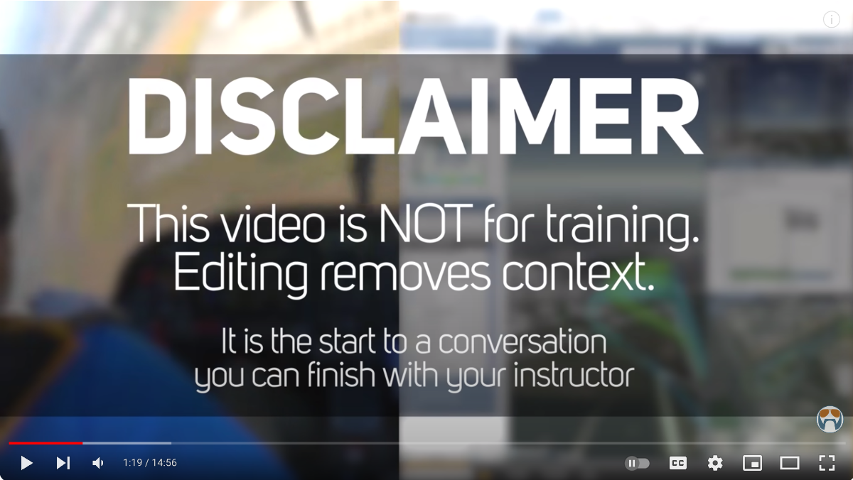

A new contribution by FlightChops:
Headwind makes a big difference to height/ distance relationship on climb out. Many turn backs result i loss of control.  Shallow bank angle reduces the chance of getting back. Don't learn how to do this on U tube..   Nev

Go to their last bit of advice. Get in touch with your instructor. What was demonstrated there was very basic and obvious. Generally discussion on line creates more confusion.  IT should be called the unforgiving turn, which they sensibly have. Nev
