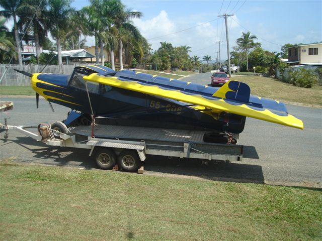

Blueadventures Posted September 10, 2020 Posted September 10, 2020 Thanks everyone, maybe I will just suck it up and convert a boat trailer for the job, not as though I will need to haul it over very long distances by road. This is how my old Skyfox fitted on a trailer, note there is a support tube from the front end of the leading edge to the strut attachment point to support the wing as if not used it's only supported with the aft hinge pin bolt. Also have a lightly sprung trailer so it is not abrupt . stiff on the road bumps as only carrying about 300kg or so.
