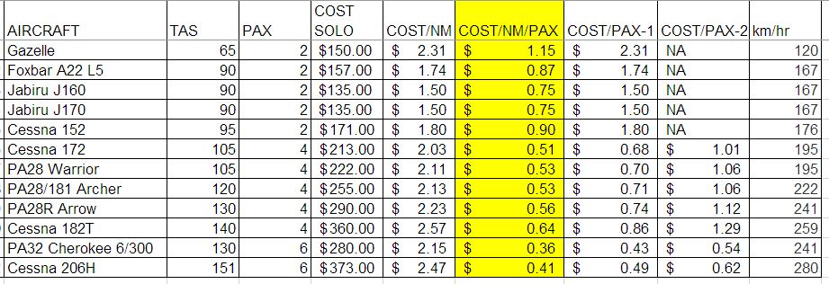

We've had a few threads about extending bladder stops over the years, but it's not just bladders that reach the end of their endurance, it's your fatigue level as well, and most of all it's passengers used to IMC flying on airlines who are quick to turn on you if there are any delays. If you flight plan for 800 Nm through three States, you're also going to be guessing two different weather patterns most of the time vs short legs where you have time to replan weather and fuel for the shorter next leg on the ground etc.
This spread sheet shows you another dynamic where you hire different aircraft for different jobs you might want to do.
If you just want to bring your currency up, then you look for the lowest cost per hour, if you want to do a 100 Nm trip to a fly in, you may still be looking at the lowest hourly rate, but if you want to fly from Melbourne up the centre, across to the gulf, up to the tip down through the Whitsunday strips and back again, it's a vastly different picture, and this shows how the cost per nautical mile for a full aircraft comes down substantially as the aircraft specification goes up, and if you drop 1 or 2 pax to get the fuel or luggage rate up, in some cases it gets even better and you get a substantially faster trip. The cost base is actual hire rates of aircraft at June 2013, so those heady rates are gone, but the cost differences will be the same.
  • Informative 2

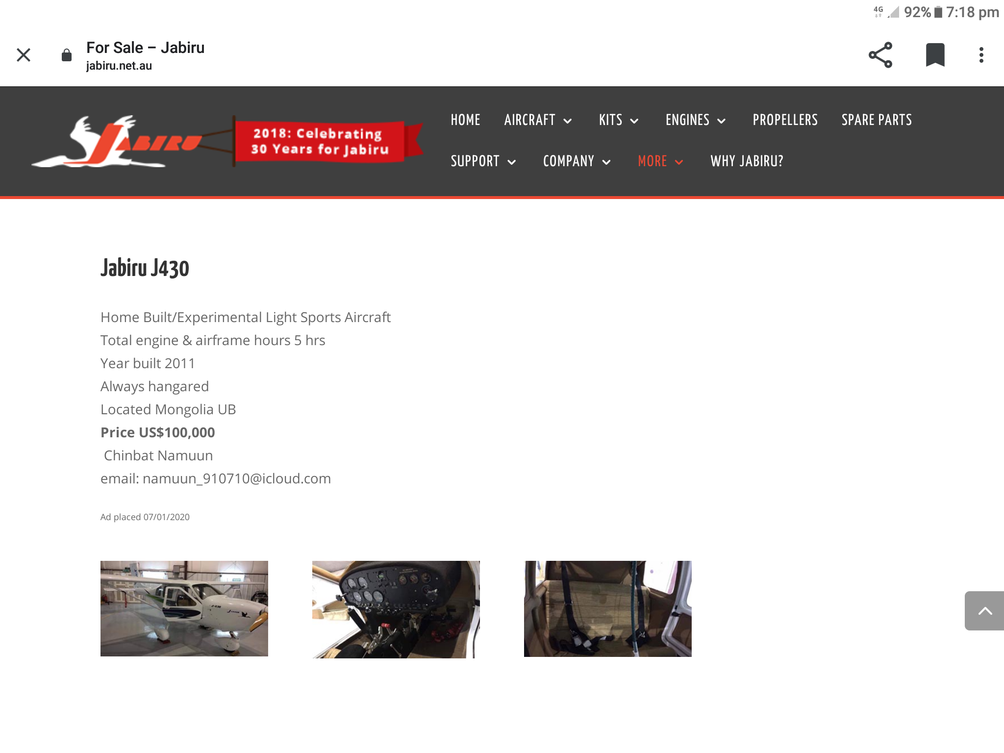

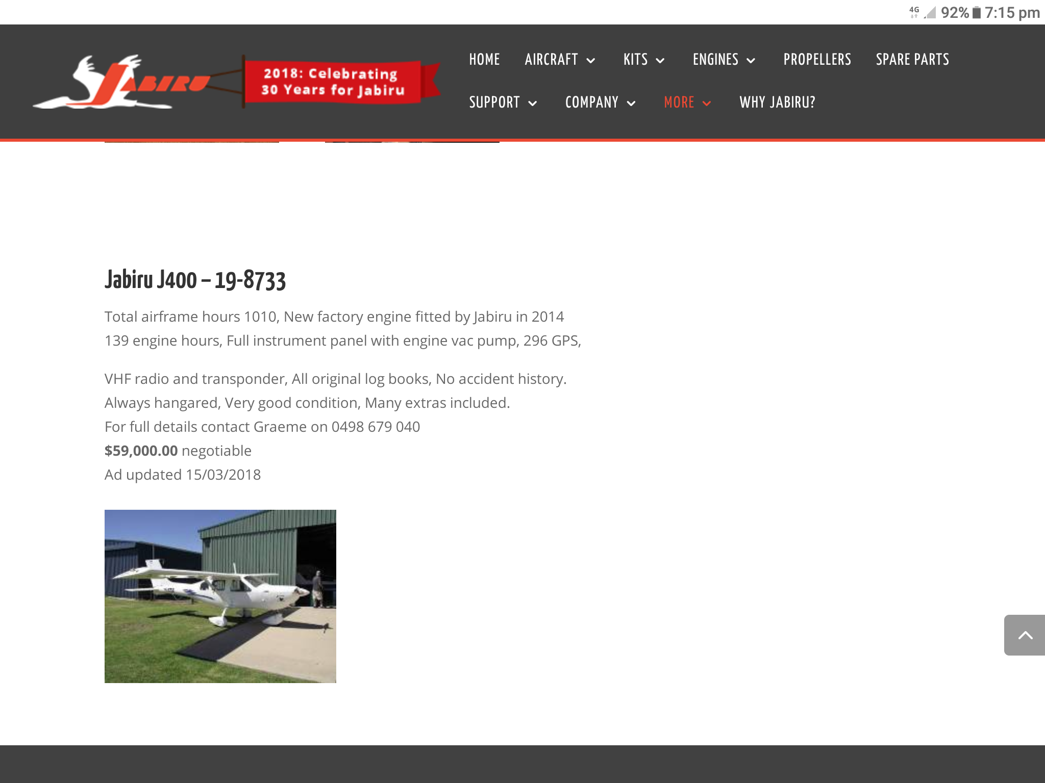

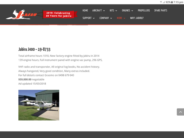

Sounds good. There is no mention of a J400 on the Jabiru website nowadays, I wonder if they would still put a kit together with the shorter wings? And I guess it needs to be pointed out that there is actually one other way to acquire one of these (or any J4xx), apart from building it - find a used one! But not very common I'd guess.

I note the ads above from the Jabiru website. Seems pointless to me to build a J400 then register it RAA, which (I presume) limits it to 600kg MTOW.
