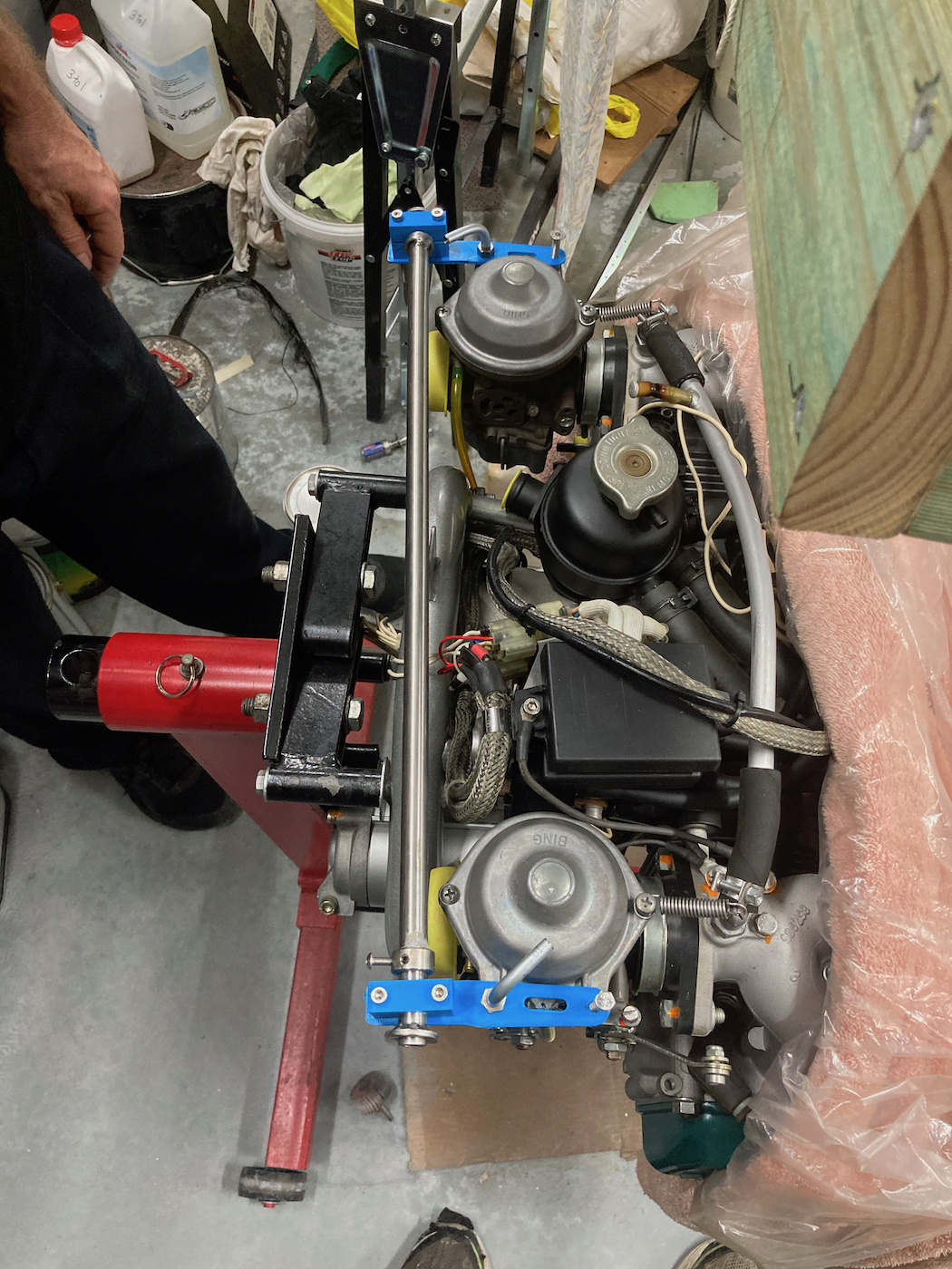

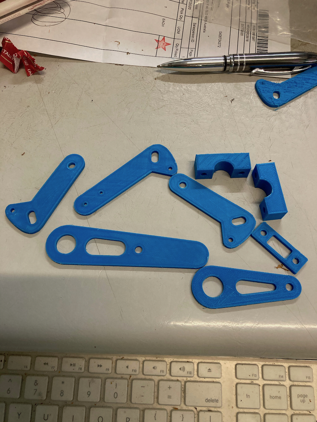

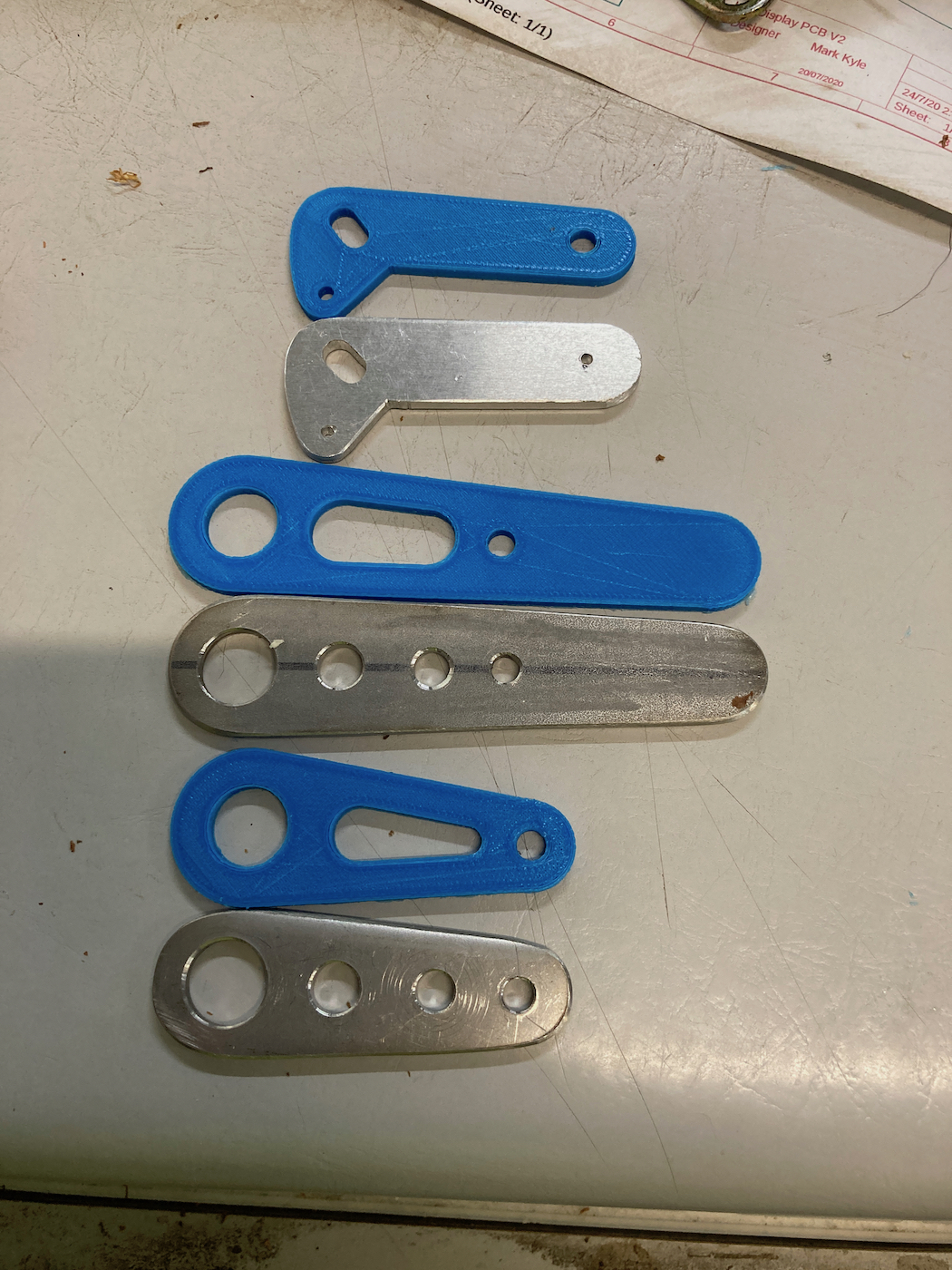

Work is progressing on the production version of the throttle mod

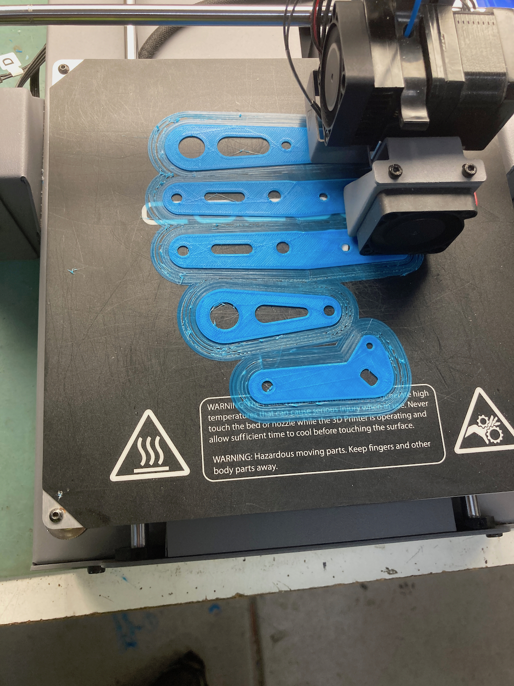

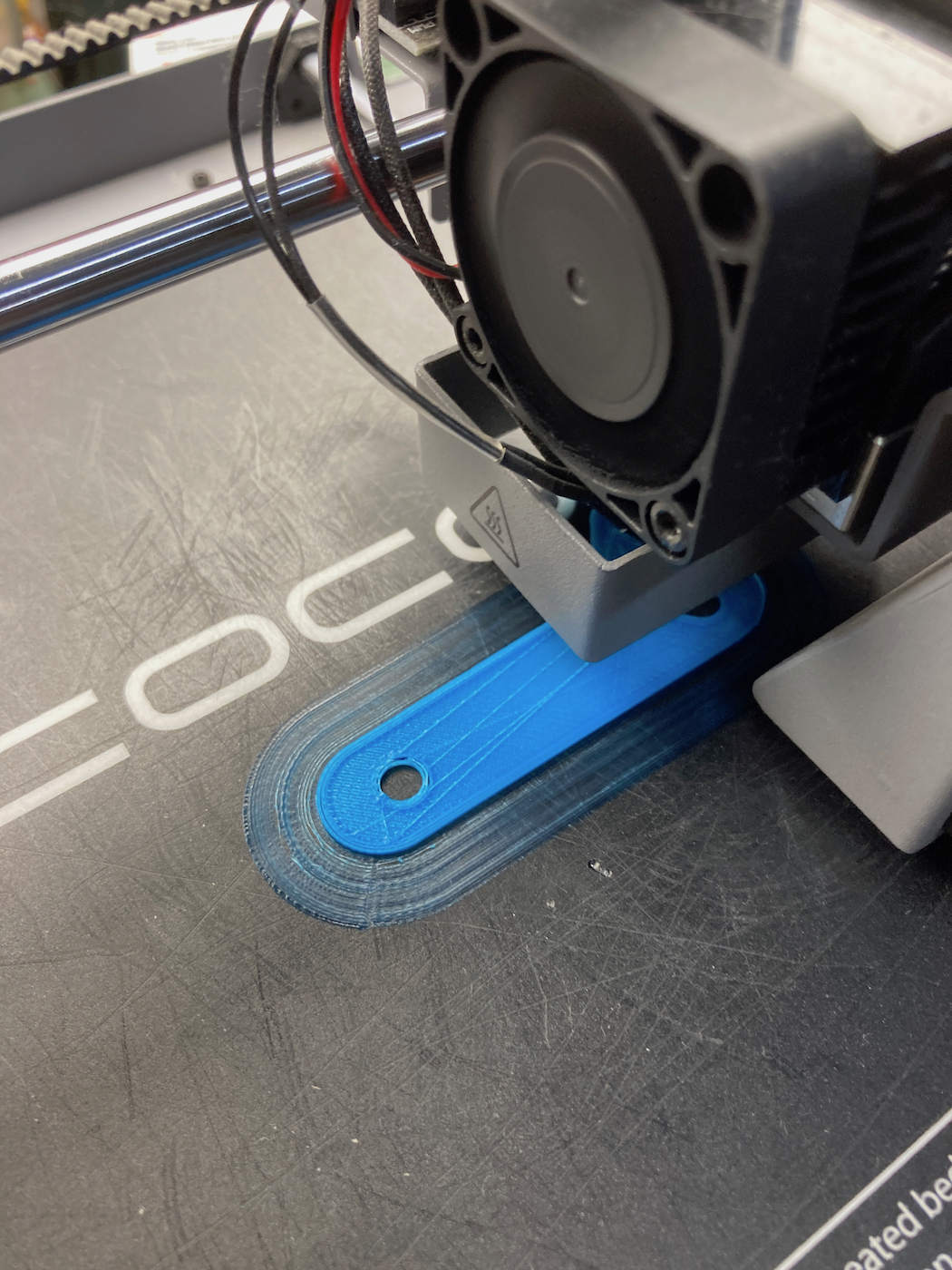

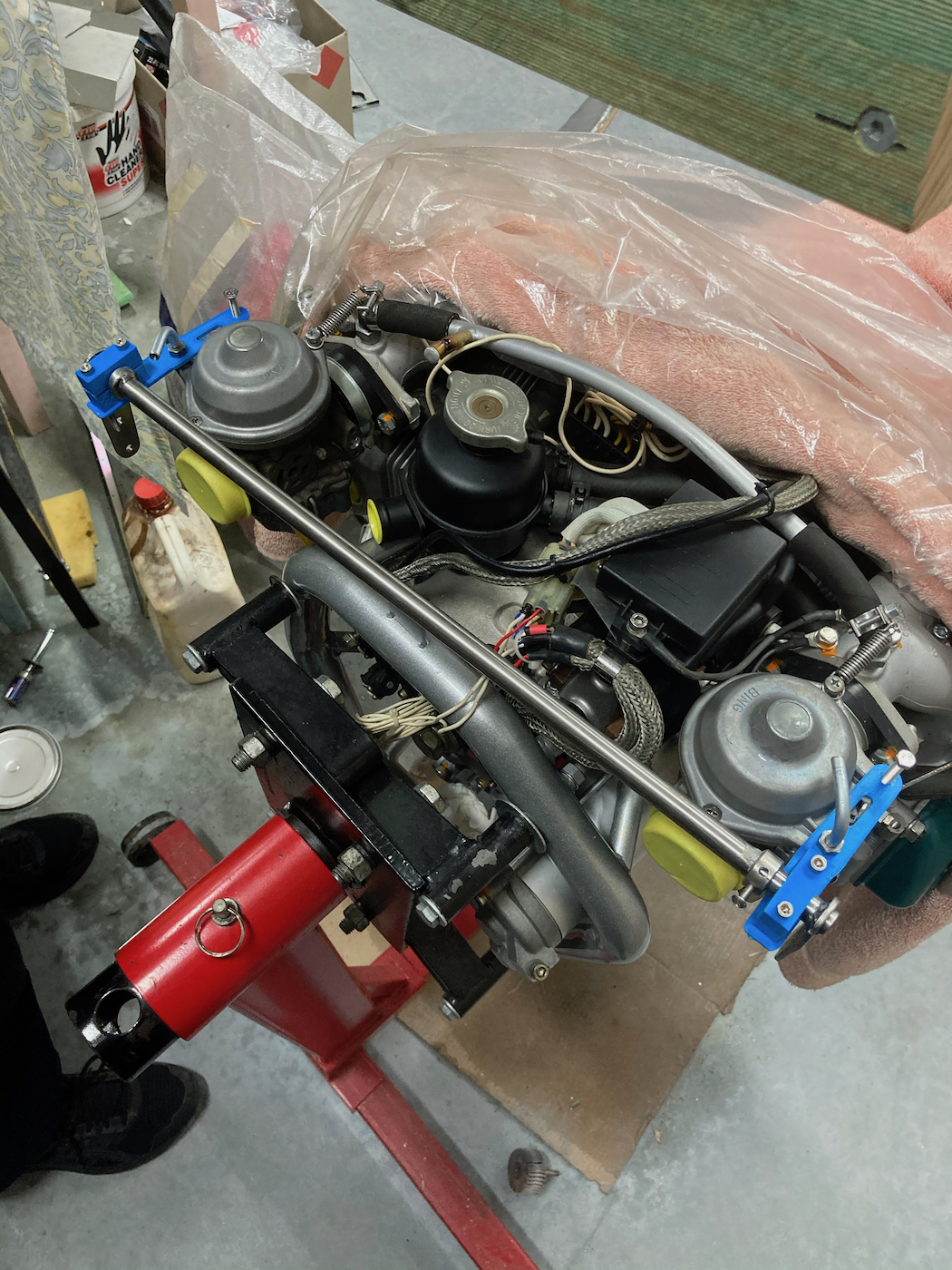

The hand made brackets I have now drawn up and modelled in 3D software. This then allows me to 3D print 100% size versions with reasonable accuracy so we know what we get when everything is laser cut. There has been a few revisions done to get the angles correct and some hole spacings. Had a test fit tonight of the main shaft and brackets..The levers and bearing blocks are all perfect now all looks really good just need to extend both the top bracket mounting holes at the rear about 1.5mm to allow for the bends in the brackets. Then print some more models with all bits attached including the carb throttle lever and finalise it then I can think about the laser cutter guys

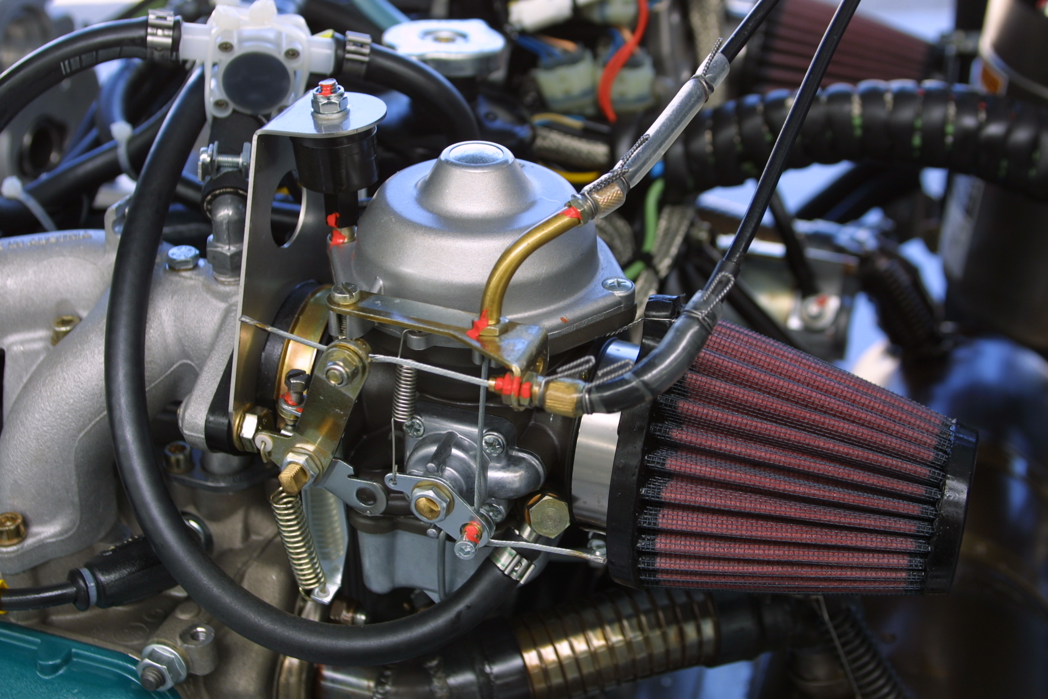

I don't know if this picture is any use to you but the only thing I would be worrying about that could upset this system you are proposing is if you start to get some vibration happening especially because you are putting a little bit of extra weight on the backend of the carburettor which could make the intake manifold more vulnerable to cracking.

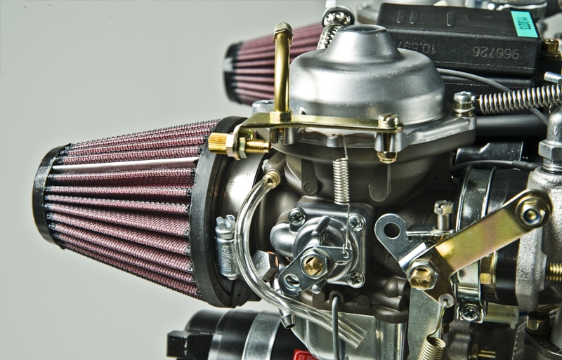

I don't remember what aircraft this photograph was taken from but it shows how they made a simple bracket that stopped any carburettor movement whatsoever.
This may be a necessary addition to the whole system you are designing to stop any vibration or harmonics entering the installation you are completing.
I have never seen that bracket before thanks for the picture...The whole system doesnt weigh much at all and it does tie both carbs together so not sure if it would be a problem. Dannys has an hour or two up on the original so far and no issues and will have another few hours up on it after this weekend as he is flying to the savannah muster on saturday. Carb balance is extremely rock solid too. I am making up a onboard carb balance monitor that will sit on the dash and connect to the ports on the carbs themselves rather than disconnecting the balance tube to do it. I have found a pressure sensor that should be perfect for doing that then will just have a LED bargraph that you can look at while flying or turn it around so you can adjust the balance while at the front of the plane.
The only thing I hadnt considered was if you had pods and not a airbox. Those pics show there maybe a small issue of clearance, This was designed for a savannah which has a specfic airbox. I have a set of pods here so will fit them to the spare engine and check clearance and see if the one system can be made to do both types of air intakes
We are going to try the port on each carb..there is a pressure port in the base..it will only be a small pressure hence the need for a different pressure sensor. We have just got a new digital gauge to connect to that port to see what we get and because its a dual port gauge we should be able to measure the difference
Normally theres a tension spring from the balance clamp to the top carby screw to take some weight off the carb as pictured.
I can't see the weight of this device making much of a problem.

My memory is slowly coming back as to why the aircraft had these brackets. The clamp which attaches the carburettor to the rubber boot never used to have a spacer that would prevent over tightening so over time people would continue to tighten this clamp until the clamp itself was touching and this would pop the carburettor off, usually on start up but sometimes on shutdown and sometimes midflight. Rotax decided to add the spacer to the clamp so people couldn't over tighten this clamp anymore and this was introduced after a fire and fatality on the ground which was a result of one of the carburettors coming off an aircraft in the Czech Republic and catching fire and then exploding. This is why the manufacturer went to these carburettor brackets. I still can't remember what brand of aircraft it was but this might come back to me the more I think about it

That support bracket is on TL-Ultralight aircraft. It continues down to incorporate a drip tray. Makes very stable carbies.
