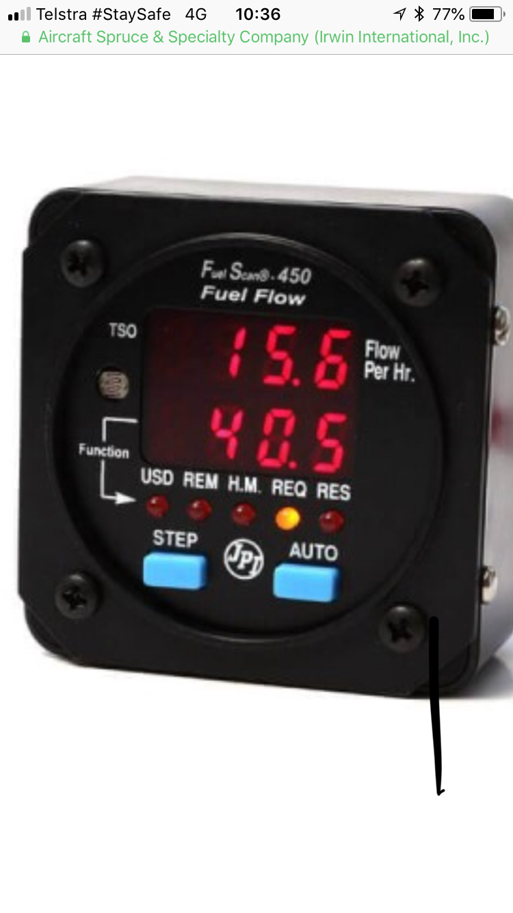

skippydiesel Posted August 19, 2020 Posted August 19, 2020 Trying to be helpful - You could go for a fuel flow /monitor eg Gauges & Sensors. Just meter the quantity in the tank and it will tell you not only what you are using but how much is left

Roscoe Posted August 19, 2020 Posted August 19, 2020 Trying to be helpful - You could go for a fuel flow /monitor eg Gauges & Sensors. Just meter the quantity in the tank and it will tell you not only what you are using but how much is left Yes my JPI FS450 instrument does all that plus gives me rate of usage, fuel remaining etc. Easy to set up and interpret.

Roscoe Posted August 22, 2020 Posted August 22, 2020 See image. This does everything i want and confirms known info
