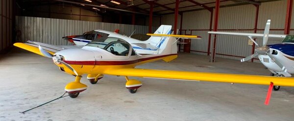

Garfly Posted July 3, 2021 Posted July 3, 2021 (edited) This recent vid from France shows a SkyRanger (an old hangar queen being restored by the Easy2Fly mob) being fitted with a new E-prop. (Auto-translate is available but not much help. You get the general idea without it, anyway.) It got me wondering, Mark (Kyle), whether you have any more reports of E-Props being used locally. Edited July 3, 2021 by Garfly

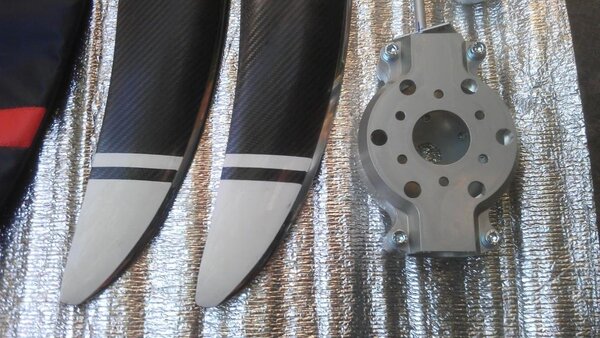

Kyle Communications Posted August 1, 2021 Posted August 1, 2021 Some info now out about the CS Eprop. They will be released nxt month after a airshow in France. One has been put aside for me to see how they go. Price is still flexible at the moment and will know closer to the release the actual price but currently about 11k aussie dollars. I will be trying to get a better price for sale here. The whole unit inc the controller weighs only 4KG https://aircraft.e-props.fr/glorieuse.php?fbclid=IwAR3qi79AFvv8sylJO8XeABsFmdhEd-rvOSB7Vcxphg51QxmXksveG8kJGks TECHNICAL DATA GLORIEUSE : 3-blade tractive propellers, full Carbon with Titanium leading edge protection, in-flight variable pitch system For ROTAX 912S / 912iS engines [models for ROTAX 914 and 915iS to come] Innovative patented technology Carbon blades with Titanium leading edge Max power : 140 hp Max rpm : 2.600 Available in 7 diameters : 1,60 m / 1,65 m / 1,70 m / 1,75 m / 1,80 m / 1,85 m / 1,90 m (one different mold for each diameter) Moment of inertia : 2.600 kg.cm² Total weight: 3-blade propeller + CS instrument + spinner = 4 kg Electro-hydraulic control for Rotax: ✗ Configuration 2 (hydraulic equipped) ✗ Configuration 3 (not hydraulic equipped) Max pitch / min pitch in less than 5 seconds Safety stops min. pitch / max. pitch Pitch variation: max. range 16° E-SCREEN "Constant Speed" specific instrument, designed and manufactured by E-PROPS. Version 1 : rpm adjustment potentiometer, intake pressure, tachometer, oil pressure, oil T°, water T°, battery voltage, ... Automatic over-torque protection. Setting via Bluetooth. Automatic mode (Single Lever Control). High readability screen. Version 2 : only with potentiometer with and without scale (to come) 3 1

skippydiesel Posted August 1, 2021 Posted August 1, 2021 Wow! - the lightest 2 blade CS prop that I found was about 7.5 kg. From memory the Airmaster equivalent was 9.5 kg

skippydiesel Posted August 1, 2021 Posted August 1, 2021 12 hours ago, Kyle Communications said: Well Skippy this is a 3 blade Yes - so the weight is even more remarkable.

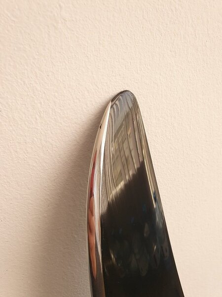

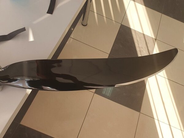

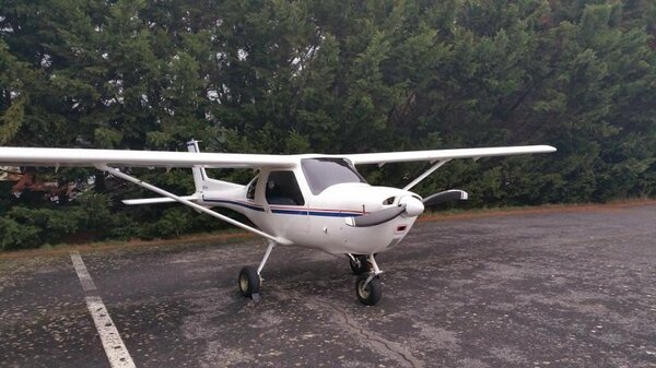

meglin Posted August 12, 2021 Posted August 12, 2021 (edited) It would be very interesting to compare the performance of our propeller with the propeller of the same size discussed here. Starting characteristics, climb characteristics, cruising, maximum, noise, vibration. We solved the problems of using a propeller on Jabiru already 5 years ago, having developed and launched the production of especially strong blades made of pure carbon fiber. Edited August 12, 2021 by meglin 1
Kyle Communications Posted August 12, 2021 Posted August 12, 2021 This was a long time ago about the incident above. Bolly were trying to develop a all carbon 2 blade for the Jabs. They have it solved now. The Eprop one is still in testing but not too far from being released. There is a airshow in France next month that Eprop is releasing the CSU version so maybe it maybe released there as well
meglin Posted August 12, 2021 Posted August 12, 2021 It is also worth comparing the strength and stiffness of the blades due to the fact that most aircraft with pulling propellers have critical clearance indicators, and the propeller, even with careful operation, always gets grass, sand, and stones.
