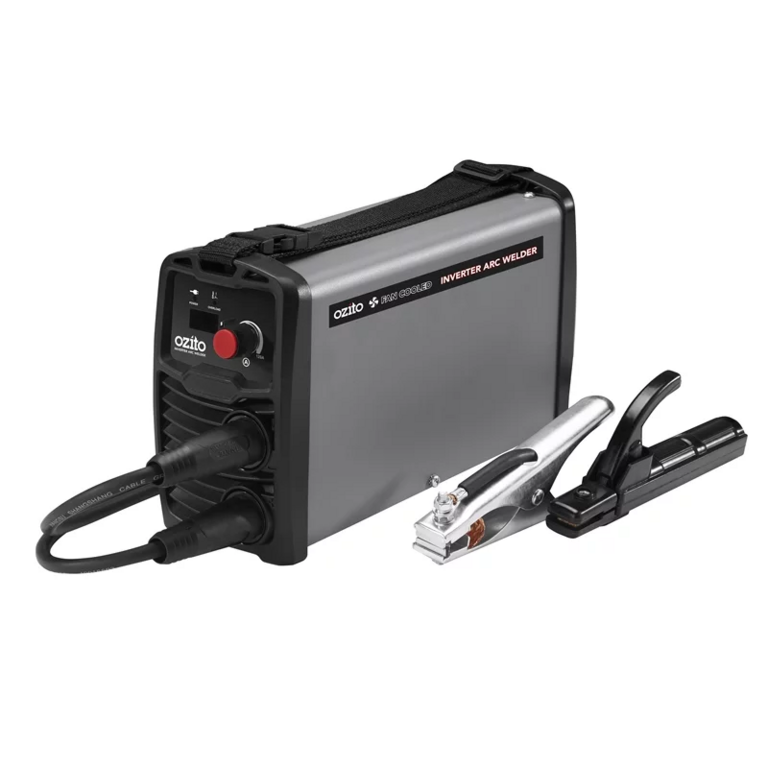

old man emu Posted December 17, 2019 Author Posted December 17, 2019 Look what I'm getting for Christmas Usual price about $139. Christmas special price $88.90 at Bunnings. Limited stock Usual price 1 1

onetrack Posted December 17, 2019 Posted December 17, 2019 Sorry to tell you this, OME, but that welder you've pictured is obsolete technology, and I wouldn't even pay $88 for one. Inverter technology has superseded Transformer technology, and the advantages are; 1. Much lighter weight (7kgs as against about 40kgs). No more back-breaking work, lugging a welder into position. 2. Lower power draw (saves $$$'s). 3. A finer level of control over actual welding amperage (better welds in difficult conditions and materials). 4. A better and more stable arc, leading to a better weld quality. I bought a Chinese (Rossi) 200A inverter welder off eBay about 5 or 6 years ago. One of these units (link below). I think I paid about $100 for it. https://www.edisons.com.au/rossi-welder-inverter-arc-200amp-welding-machine-dc-igbt-stick-portable I formerly owned a 140A CIG transformer welder, which provided good service from about 1985, until it died about 2013. The CIG welder was one of the first to have a PCB in it, and when the PCB fried, I found you could no longer buy it as a part. So, I invested in the Rossi - making sure it used genuine Toshiba MOSFETS in its construction (the secret to reliability). I have done a lot of welding with that little Rossi, and it is, in a 2-word description, a "little pearler". It has never failed to work, welds amazingly well, even on heavy thickness steel, and it works in dusty conditions, hot conditions, and generally cops a fair bit of abuse, and it has never faltered. I would never go back to a transformer welder, they are like stepping back into a Sopwith Pup, after flying around in your Cessna. 1 2

old man emu Posted December 18, 2019 Author Posted December 18, 2019 Sorry to tell you this, OME, but that welder you've pictured is obsolete technology, It's not the technology that's obsolete, its the bloke posting the picture. This is the one Santa has on his sleigh for me: The new technology these inverter welders employ is amazing. I've seen videos of this type of Chinese overheat the operator before they overheat themselves. 1
onetrack Posted December 18, 2019 Posted December 18, 2019 Ahhh, that's better, then. Haven't seen an Ozito inverter welder around, but the Ozito brand has actually garnered a few kudos for surprisingly satisfactory durability and reliability, for a cheap Chinese product. The bottom line is, be aware of the duty cycle. I note the Ozito is only rated at 20% duty cycle @ 120A, the Rossi is rated 35% @ 200A, 60% @ 160A, and 100% @ 120A. Duty cycles are rated on 10 min time periods. So, in practical terms, 20% duty cycle means you should only be full-time welding for 2 minutes, before giving it 8 mins rest time.

ClintonB Posted December 18, 2019 Posted December 18, 2019 Sorry to tell you this, OME, but that welder you've pictured is obsolete technology, and I wouldn't even pay $88 for one. Inverter technology has superseded Transformer technology, and the advantages are; 1. Much lighter weight (7kgs as against about 40kgs). No more back-breaking work, lugging a welder into position. 2. Lower power draw (saves $$$'s). 3. A finer level of control over actual welding amperage (better welds in difficult conditions and materials). 4. A better and more stable arc, leading to a better weld quality. I bought a Chinese (Rossi) 200A inverter welder off eBay about 5 or 6 years ago. One of these units (link below). I think I paid about $100 for it. https://www.edisons.com.au/rossi-welder-inverter-arc-200amp-welding-machine-dc-igbt-stick-portable I formerly owned a 140A CIG transformer welder, which provided good service from about 1985, until it died about 2013. The CIG welder was one of the first to have a PCB in it, and when the PCB fried, I found you could no longer buy it as a part. So, I invested in the Rossi - making sure it used genuine Toshiba MOSFETS in its construction (the secret to reliability). I have done a lot of welding with that little Rossi, and it is, in a 2-word description, a "little pearler". It has never failed to work, welds amazingly well, even on heavy thickness steel, and it works in dusty conditions, hot conditions, and generally cops a fair bit of abuse, and it has never faltered. I would never go back to a transformer welder, they are like stepping back into a Sopwith Pup, after flying around in your Cessna. The first tig i bought was the CIG inverter type which just happens come with a lift tig kit. It is a bit harder to learn on, but my lame mate used it for a lot of the repairs on the bushbaby airframe which worked just fine. not overly expensive and light as onetrack stated. You can now "buy" smaller argon bottles with no lease payments each year and a good bobbin regulator is a great investment. cheers 1
old man emu Posted December 18, 2019 Author Posted December 18, 2019 Like most Chinese-made electronic stuff, the guts all tend to be the same. If that's correct, then I've seen a review of one of this type of DC welder and the guts were very well made with quality components. Those important components, like ICs all bore internationally recognised identifying marks so that the component's specs could be looked up on the 'Net or other electronics data base. The PCBs were well made themselves and the circuit components were well assembled. I don't think that this Ozito welder will be any different. As for the quoted duty cycle, the figure quoted might only be a guaranteed minimum to cover the manufacturer's butt end. Some of these welders seem to be able to keep themselves within operating temperature for a long time. I would expect duty cycles to shorten as the OAT approaches 40C.
Litespeed Posted December 18, 2019 Posted December 18, 2019 For a inverter welder, that's a great price. Amazing how cheap some really useful tools have become. But you can buy a handful of crap that is thrown out after Xmas. Full points for getting a useful present. Grab yourself, a also cheap auto darkening helmet. Makes welding heaps easier and no problems of miss timing eye cover. On lookers can use the hand held one. Buy some nice long blue leather gauntlets. Does the missus like to see you in leather? A leather apron or welding jacket is a hot but burn free look. I have a ancient arc, mig and tig to use but a cheap inverter sounds great. The small size and ability to do big work makes such a little beasty a nomination for best under $100 tool ever.
