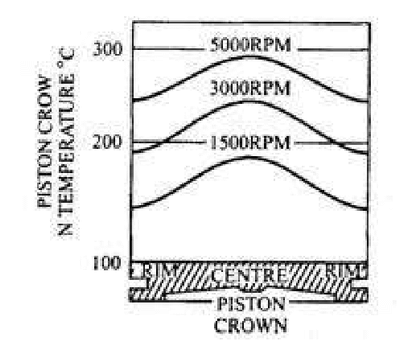

RFguy Posted April 12, 2021 Posted April 12, 2021 (edited) Ovality : As I understand it, the ovality on the thrust axis assists the piston not going too large and maintaining roundess at operating temp, by the hot areas having the greatest room for expansion (perpendicular to the thrust axis where the slots in the crown to skirt are). In the case of the shutdown engine , because the heat flow from the CC is not there, we have the opportunity for the piston temperature to become homogonous, and reach an equalibrium, because the high difference temperatures caused by combustion heat are not present. And that would make it more likely for the whole piston to expand - IE the hot goes into the cooler (major axis on the ovality) in order to acheive equilibrium. Simultaneously, you have the bores cooling. Edited April 13, 2021 by RFguy

RFguy Posted April 13, 2021 Posted April 13, 2021 the pictures of the Gen4 piston I have seen do not have the thermal slots under the crown (which promotes circular growth at operating temperature from ovality at room temperature) But the ally bores expand much more than the steel ones for a particular temperature. (but they also have much bigger cooling fins and higher heat conductivity) 1 1

RFguy Posted April 13, 2021 Posted April 13, 2021 (edited) anyway Bruce my take on the phenonomen of stiff to turn over after shutdown is : - cylinder bores contract - pistons heat soaks , leading to more homogonous piston temperature, expanding on axis more than it would usually in service. piston temp is somewhat proportional to total fuel-air charge per second (RPM x throttle ). The numbers I find for piston temps for wet vehicle pistons are usually at 6000 rpm ish. this is an interesting snippet : (wet vehicle bores) Edited April 13, 2021 by RFguy 1
facthunter Posted April 13, 2021 Posted April 13, 2021 Load and RPM (Frequency and intensity). Much the same as spark plug temps. react . The location of the exhaust valve will move the max temp location unless it's centrally located . (never happens in practice). Area of piston skirt in good contact with the cylinder wall will affect heat loss rate and therefor temp attained. Slipper pistons or large ovality will reduce heat transfer. an oval piston only has line contact A slotted piston will transfer less heat from the crown than a solid one., because you have cut off the path over much of its skirt.Nev 1
