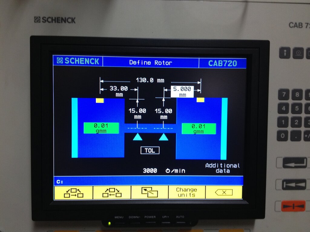

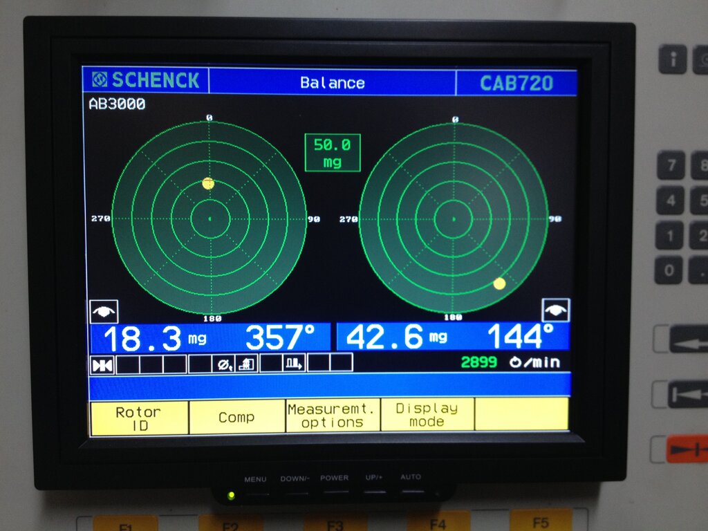

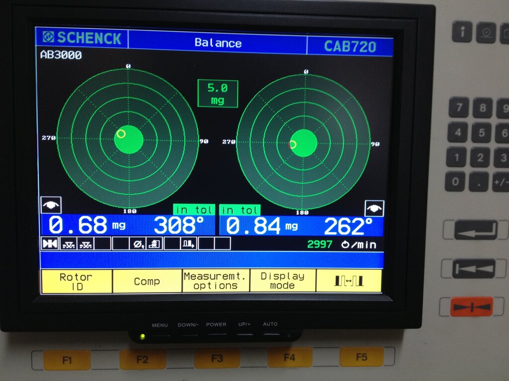

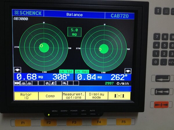

Kyle Communications Posted January 19, 2020 Posted January 19, 2020 Its not 50 bucks to do a balance but its not several thousand either. A decent balancer will set you back a lot of bucks 25k plus and up to 100k. It also doesnt take 5 mins to do a balance properly. I know I had my own Schenck balancer for 10 years..it was second hand and cost me 28k back then. It was for balancing model jet turbines I imported and also repaired all brands..when you have a shaft spinning anywhere from 100,000 rpm to 240,000 rpm...you need a accurate balancer that is very sensitive. So I do know a little bit about balancing. The 915 IS is 141 hp turbo and injected also super expensive...I would think they balance them as the stress on the engine is a lot more when you increase the hp by 40% and start stuffing air and fuel down its throat at nearly twice the amount Some pics of my balancer doing a turbine from start to finish there are a lot of adjustments required between those 2 pictures.left target is compressor end the right target is the turbine end..both ends require adjustment with a grinder. Tough stuff that inconel 1 1

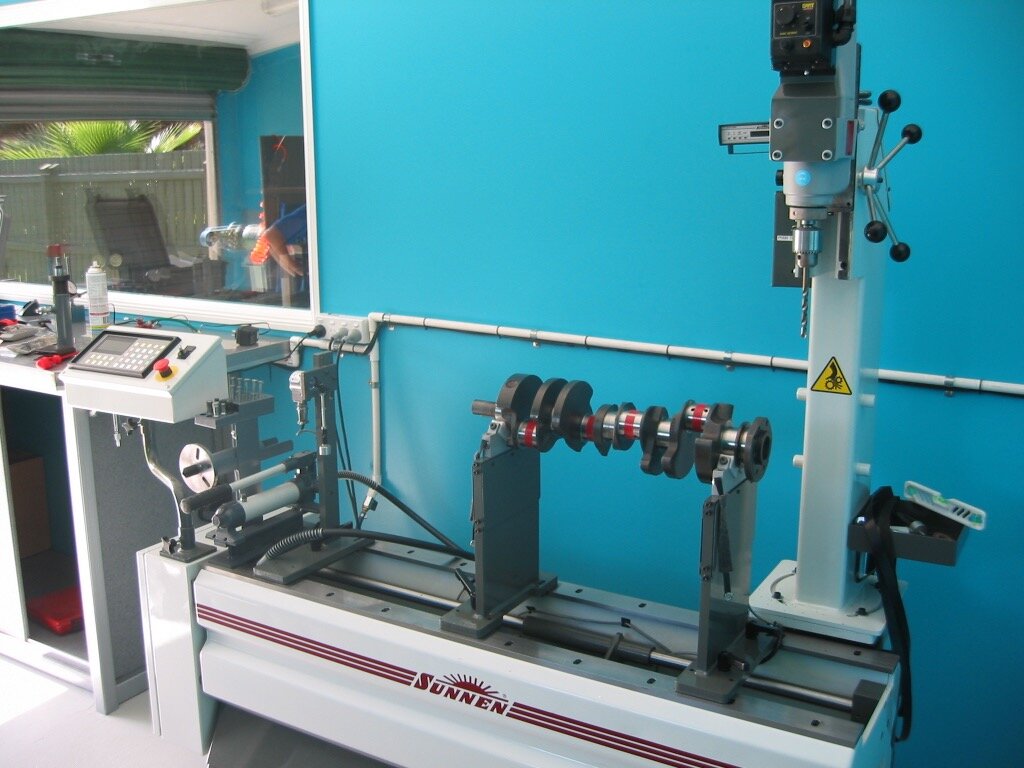

Kyle Communications Posted January 19, 2020 Posted January 19, 2020 Here is a engine balancer if you havent seen one..this one I did a repair on for a guy back in the day...I did a lot of repairs on CNC machines and balancers..Just checked the geo on the picture 15 march 2003

Litespeed Posted January 19, 2020 Posted January 19, 2020 Thanks Kyle and Nev. Love the turbine balancer. My mate builds engines and he is anal about balancing to get the best of BMW engine to do their stuff on road and track. I know they are not quick nor cheap. The $50 is for a factory like Rotax to incorporate in the production line. It could be more but depends on the automation etc 50,000 engines is enough to justify the investment.
