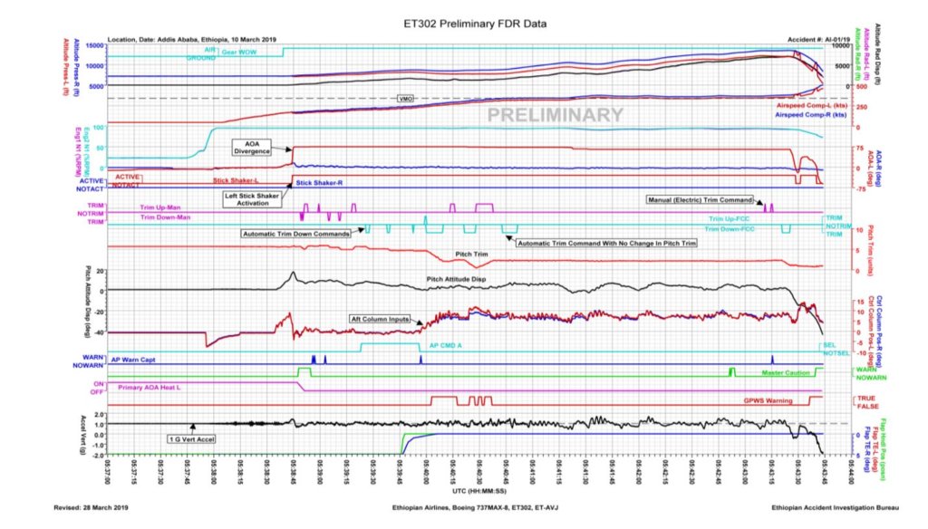

Thruster88 Posted May 14, 2019 Posted May 14, 2019 If the MCAS tries to trim down, but the trim switch is activated up, is there then a manual trim up instead of the MCAS trim down? Or does the trim switch just cancel that MCAS cycle, and that's it? Pilots manual trim switch(electric) overrides MCAS and allows the aircraft to be trimmed up, you can see this at 5:40:30. Not sure why they did not trim for longer until the trim indicator was neutral.
IBob Posted May 14, 2019 Posted May 14, 2019 Pilots manual trim switch(electric) overrides MCAS and allows the aircraft to be trimmed up, you can see this at 5:40:30. Not sure why they did not trim for longer until the trim indicator was neutral. [ATTACH type=full" alt="ET302-FDR.jpg]42305[/ATTACH] Yes, you're right. What do you make of the 'Automatic Trim Command With No Change In Pitch Trim' at 5:40.45? Presumably the servos were disabled at that point? But why then were there not further 'Automatic Trim Command With No Change In Pitch Trim' events after that?
