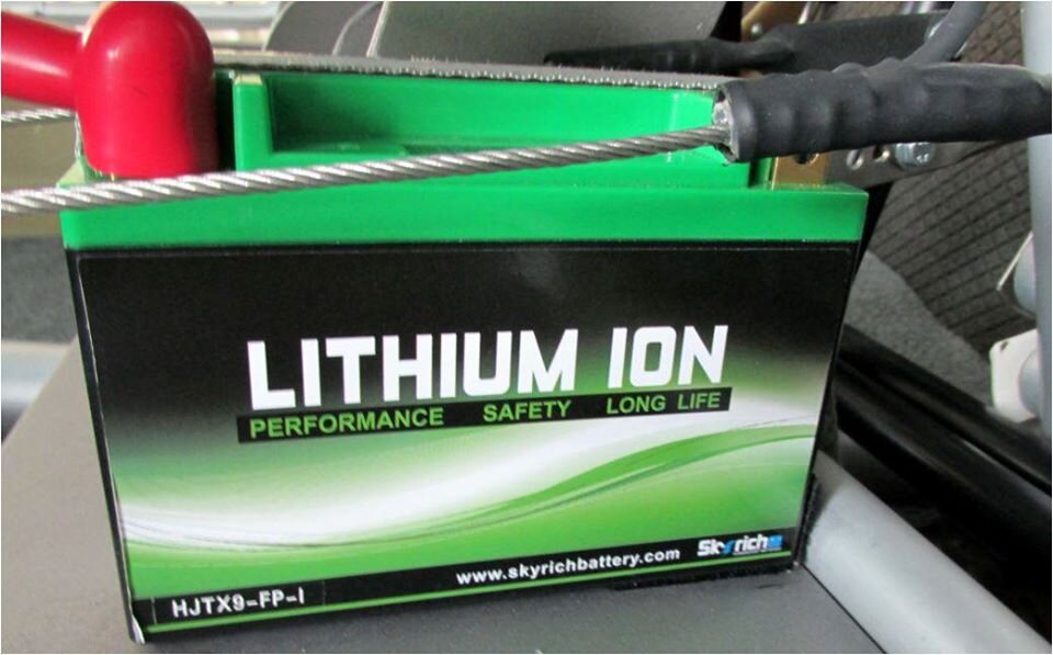

Blueadventures Posted December 28, 2019 Posted December 28, 2019 I see these Lithium Ion batteries are being used by one of the skyranger dealers overseas for Rotax 912 setups. They may be an ok type of battery at only 0.7kg. 185mm long, 79mm wide and 192mm high. Anyone using these. Cheers.
Kyle Communications Posted December 28, 2019 Posted December 28, 2019 Not by me thats for sure when on a Rotax

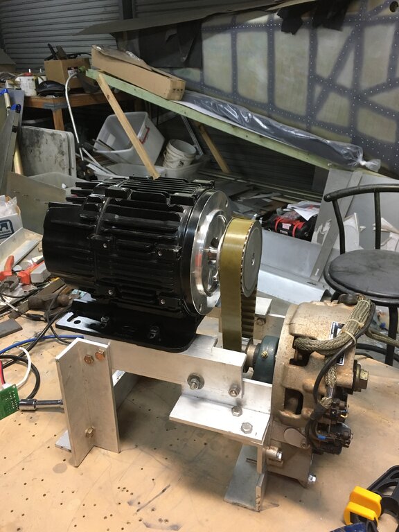

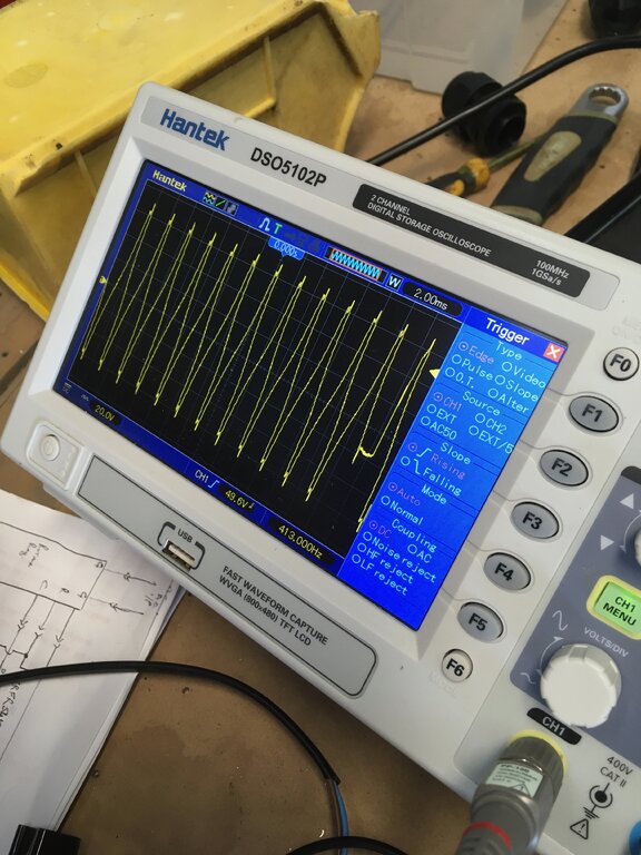

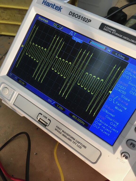

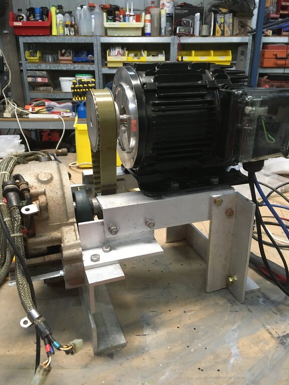

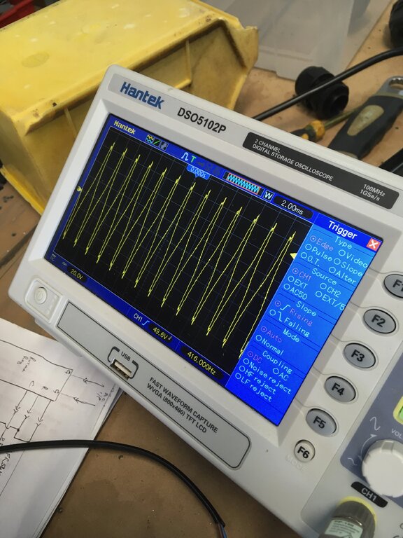

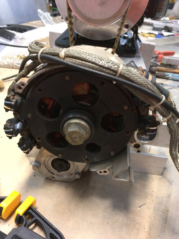

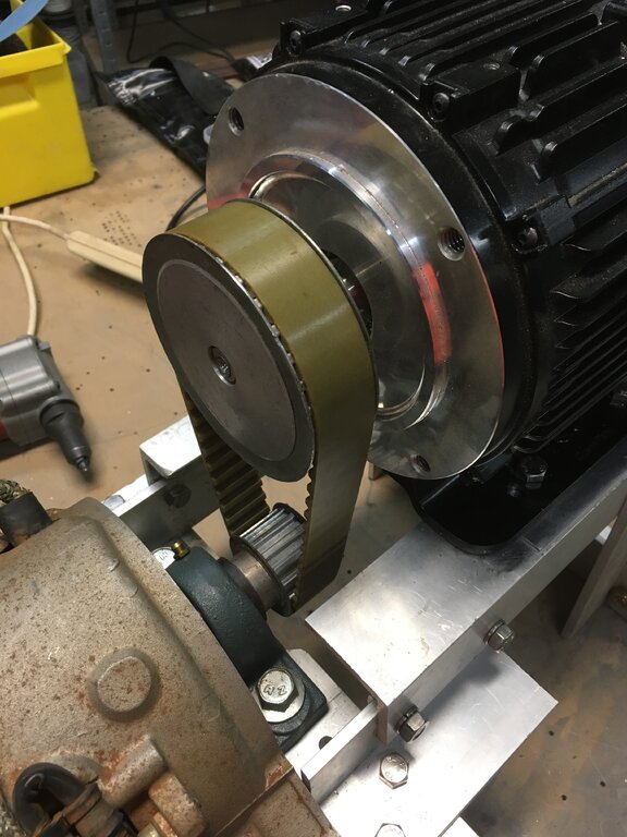

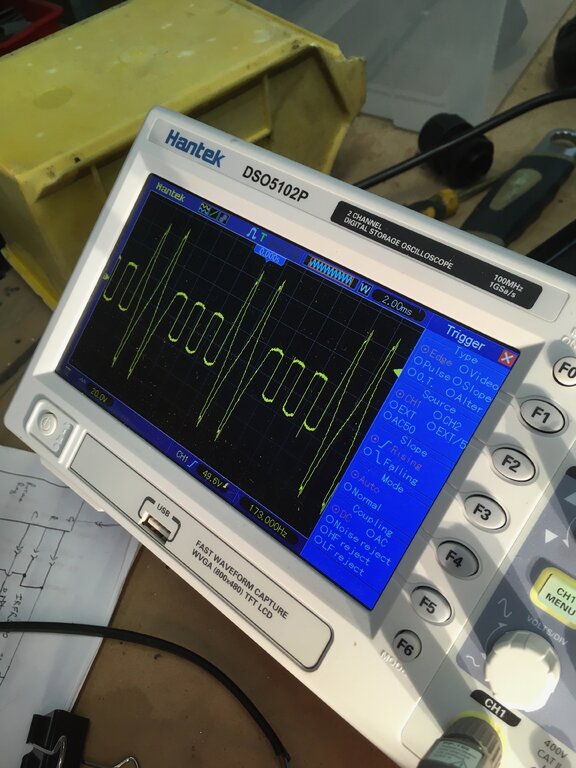

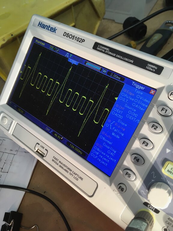

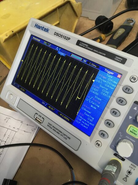

Kyle Communications Posted December 29, 2019 Posted December 29, 2019 A rigorous testing program is to come yet. The first test unit should be going on a aircraft in a couple of weeks. The base design is done and works very well on the test bench and the pics should give you an idea of what it does and does very well. There is some failsafe design on board as well. We have been using my test rig I use for testing the CDI modules I make for the rotax. It can get to 5200 rpm driving the rotax generator so we do have a real world test bed for it which allows the proving before it even gets to a aircraft 1
