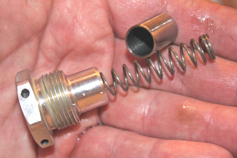

I got in contact with Bill and he did initial testing with a guy down the road from me here funnily enough...the world is becoming a small place. John Raison worked with Bill and they made some prototypes and got it to a final design that worked a treat. John has more then 100 hrs on this design now and no dramas at all. His fluctuations were far worse than mine too...I mean off the chart stuff. I saw the video of it. The issue is the ball type and the mushroom head style can vibrate around inside the pressure relief valve tube and this causes the problem. Bill came up with a new style for the 912ULS something similar to the one used on the new 912IS. There are some differences though the ULS has a 4 lobe oil pump where the 912IS has a 6 lobe oil pump so the pulses are no where near as hard from the pump. Bills valve will also allow you be be able to adjust your oil pressure as well. Although he recommends keeping the oil pressure around the 30 psi when hot at idle and 45 to 50 psi at cruise rpm.
I fitted my new valve on friday and test flew it this morning. Certainly very different now. I am getting some movement but that is because I am running a analogue sensor on a digital instrument. I understand this being in the electronics game. The 4-20ma sensor would be far better to use and I now may go back to one of those as I believe what I thought was a faulty sensor most likely was not. I dont think I threw that $350 sensor out...I hope not

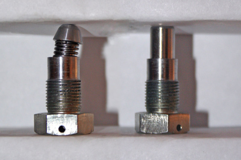

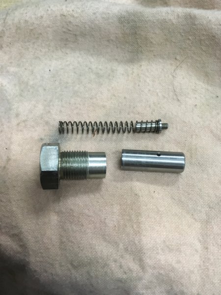

Picture of the mushroom valve from Rotax that doesnt work and Bills new valve and the reason why the mushroom valve doesnt work you can see the layover which bounces it around.

The ball type and the new replacement by Rotax with the mushroom head which is the one on the left in the picture wobble around inside the oil passage. This causes the fluctuations....this new one pictured on the left the valve sleeve is held in place by the plug skirt and this solves the issue
I can see that but a flat face is "unusual" unless the manufacturer can't guarantee the seat being on centre. Since everything is machined at the one setting, it should be easy to achieve... A plunger with ports works fine. These sort of problems are not rocket science. Nev

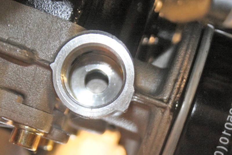

The 912IS valve and inside the oil passage looks like this..very different to the ULS

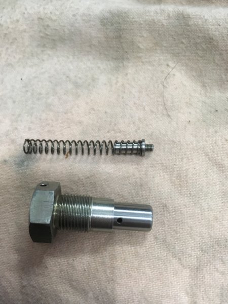

This is what mine looks like now
That must work more like an old style diesel injector pump, should be able to smooth out any jitters.

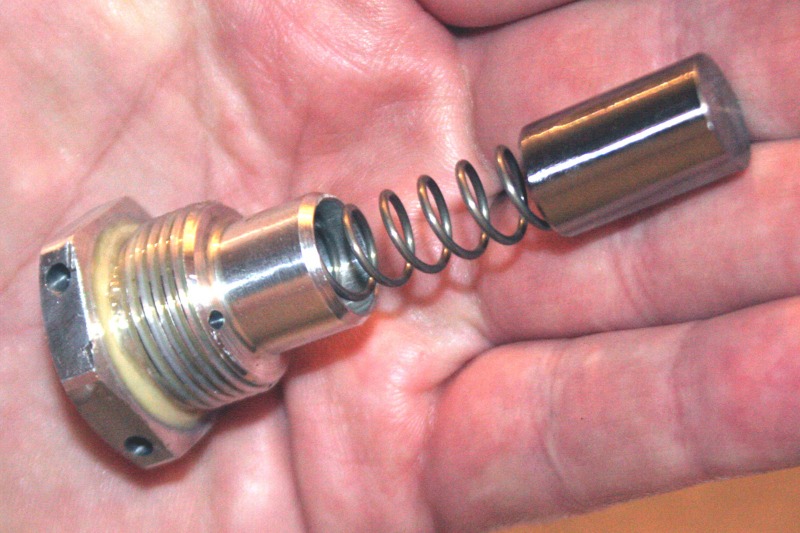

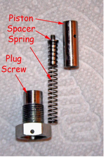

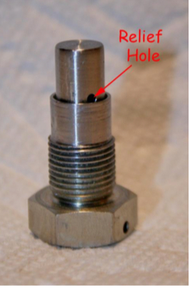

What's to stop the spacer unscrewing? and why is it needed? the length of the plunger could do what the stop is doing.. Every trochoidal pump has pulses. while it may make some noise why would it make the problem? The original set up probably gets the ball pushed to the side the outlet is on by the flow direction of the oil.. Nev
The spacer in the top is a tight thread adjustment on the little allen key grub screw and also loctited with a special loctite. This adjuster allows you to adjust your oil pressure higher or lower if you want. The unit came adjusted to a level that was known to work fine but if you wanted to make it more or less you can. The previous proto units had specific thickness shim spacers in the bottom of the plug to get the right pressure range this all depends of course on the tension of the spring. It took a few goes at getting the right spring tension during development. John the local guy here who did the testing of the proto units and also helped getting the size of things right told me yesterday that 0.5mm spacer made 5 psi difference in the pressure
