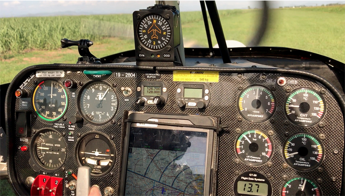

I have trig units and recommend them. Look them up on net and down load a copy of the user and install manuals. Wiring diagram legend will some set up and interface options. The user manual will describe the hookup options and show internal adjustments you can make. If you get these you will need to make your wiring harness and the panel heads are remote to the main electronic box that may be a handy. Cheers
And the Trigs fit well in the centre of your handsome panel, Mike.
I think you can get the pair (Radio & Xponder) for about $4.5K these days.
Very tempting.
