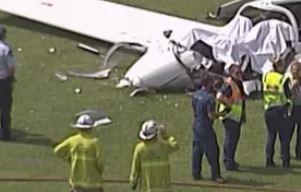

Looking at some of pictures it looks like they came in hard. A lot of schools use DA40 was it a training flight?
Pity to see a crash on what looks like a good place for a emergency landing.
That turf farm is far from flat. It is really undulating and would be very deceiving in the event of a emergency landing.

Based on the flattened grass in front of the left wing and behind the right, I wonder if it was a developed and very flat spin impact?
No scrapes, just flattened grass.
Unfortunately I think that might just be traffic marks from the paramedics and helpers trying to assist
Sorry Helipilot you might be correct.

It's interesting that close witness reports state that they only heard a "thump" on impact - there's no mention of engine noise, or an engine exhaust pitch change.
It's difficult to see if the prop shows signs of rotation under power at impact - but I think I can see one blade partly-buried, level with the turf, that would appear to indicate it wasn't under power at impact.

Can anyone see any forward skid or sliding on the ground marks at all, as it looks its very flat spin with zero forward momentum? Weird to me.
