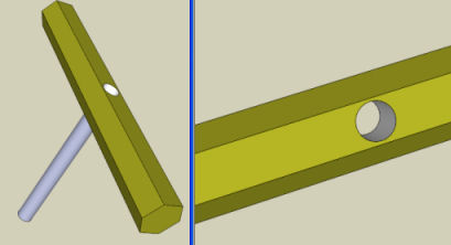

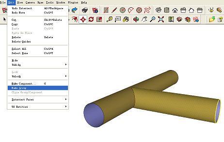

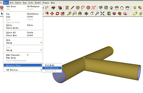

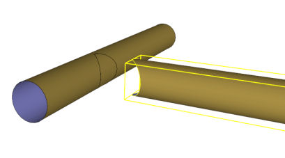

bexrbetter Posted March 10, 2018 Posted March 10, 2018 Marty, you may or may not know how to truncate the tube ends where they meet another tube in SU? It's also the same way the you bore a hole through any shape. Draw your tube up to or through the other tube or shape otherwise Highlight all interconnecting parts. The 'Edit' dropdown - select 'Intersect faces' - 'With selection' Note if your parts are already grouped this will take a while to complete. Select parts individually and group the part before it can be removed from the other part. Remove part. Notice fishmouth. The hole can be made in the other tube by highlighting it and delete, or delete the black intersection lines. Sometimes can right sweep and select the lot, sometimes I have to delete the segments one at a time (PIA).

bexrbetter Posted March 10, 2018 Posted March 10, 2018 And here's a hole. Draw a circle on a part, extrude through, highlight as required, Intersect faces and delete what you don't want. You can also extrude a tube isolated from the other parts, 'Group' it, then position it where ever you want that hole, then 'Explode' it (Edit - Face - Explode), Intersect faces etc...
Marty_d Posted March 10, 2018 Author Posted March 10, 2018 I don't really have a problem intersecting pipes on SketchUp - but printing the actual pattern to wrap around the pipe was a bit beyond it, as far as I could tell. Anyway, found another solution here - Tube Joint Pattern Generator - does the lot. I printed their solutions for each joint, taped it around the pipe and cut with a Dremel, and they fitted like a dream.
bexrbetter Posted March 10, 2018 Posted March 10, 2018 Anyway, found another solution here - Tube Joint Pattern Generator - does the lot. The original I still think is the best, Giles Puckett's "Tubemiter.exe", it's round the net.

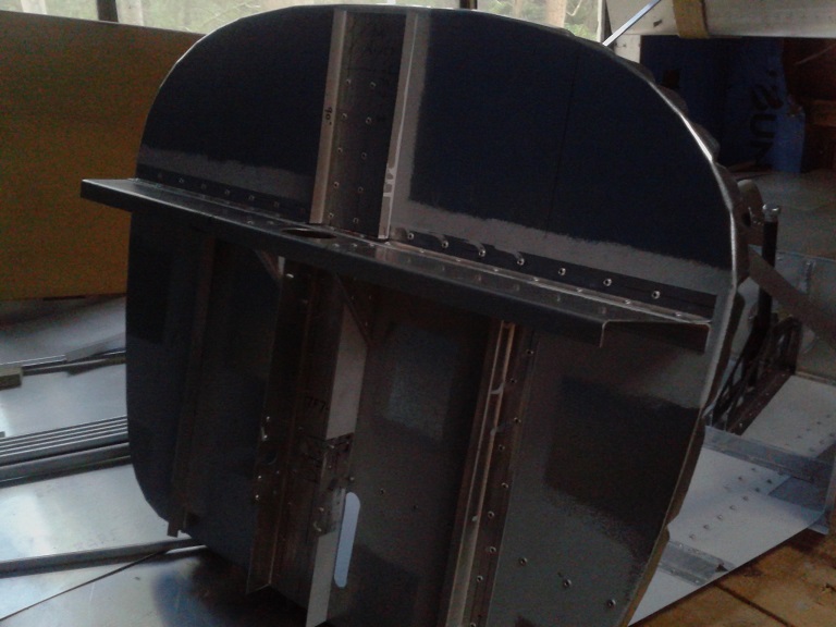

Marty_d Posted April 10, 2018 Author Posted April 10, 2018 Firewall fabricated! And next job... more pipe prep and welding (though not by me!)

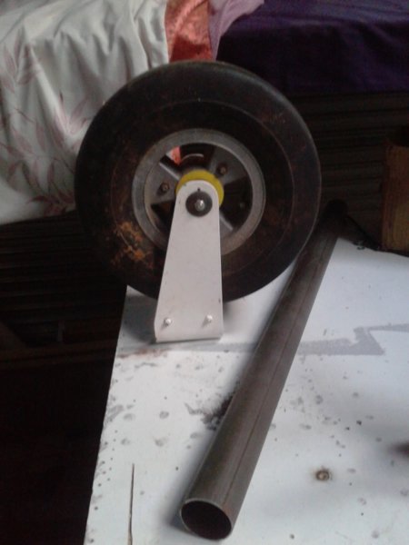

Marty_d Posted April 11, 2018 Author Posted April 11, 2018 I sourced some nylon today (HDPE actually) for use as fairleads, bearings on the nose leg and the little thingy that holds the two rudder pedal assemblies together. Cost me the grand total of $22 for enough to have plenty of stuff-ups!

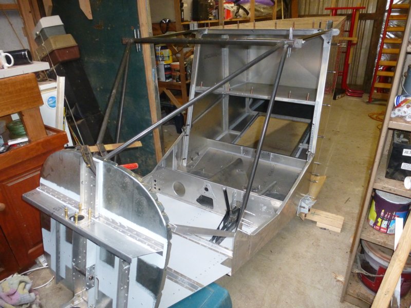

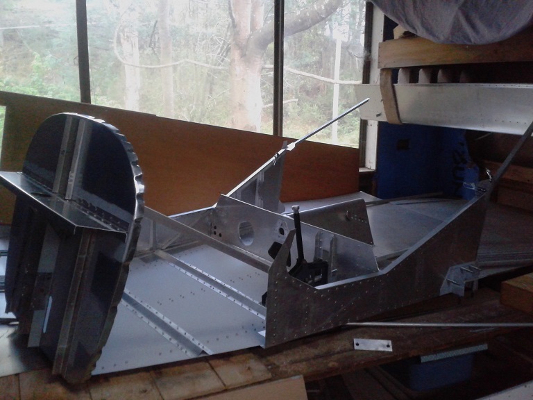

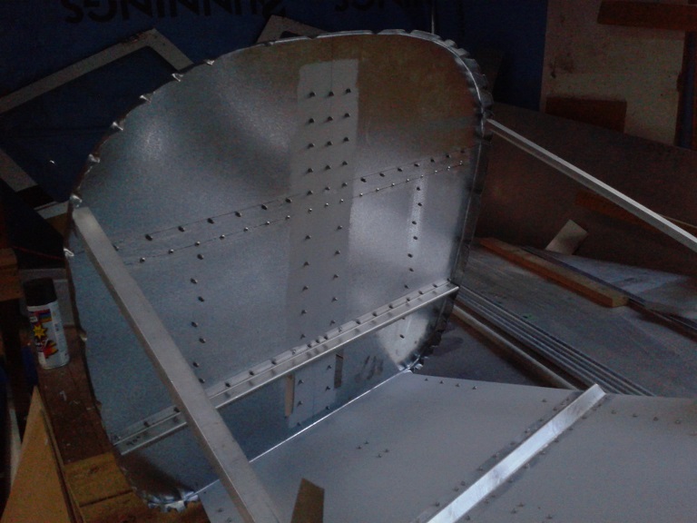

Marty_d Posted July 25, 2018 Author Posted July 25, 2018 Fuselage is together! (clecoed). My local metalworker came through with the welded cabin frame and noseleg. Due to a lot of renovations, then school holidays, today was the first time I got down to the shed for a decent session. It all seems to fit together pretty well so I'm chuffed! 5 1
eightyknots Posted July 25, 2018 Posted July 25, 2018 Fuselage is together! (clecoed).My local metalworker came through with the welded cabin frame and noseleg. Due to a lot of renovations, then school holidays, today was the first time I got down to the shed for a decent session. It all seems to fit together pretty well so I'm chuffed! [ATTACH=full]61253[/ATTACH] Go! Marty.
