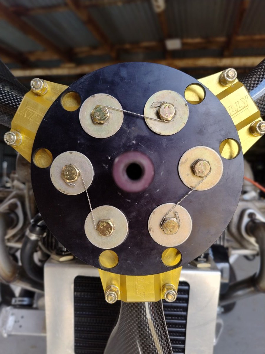

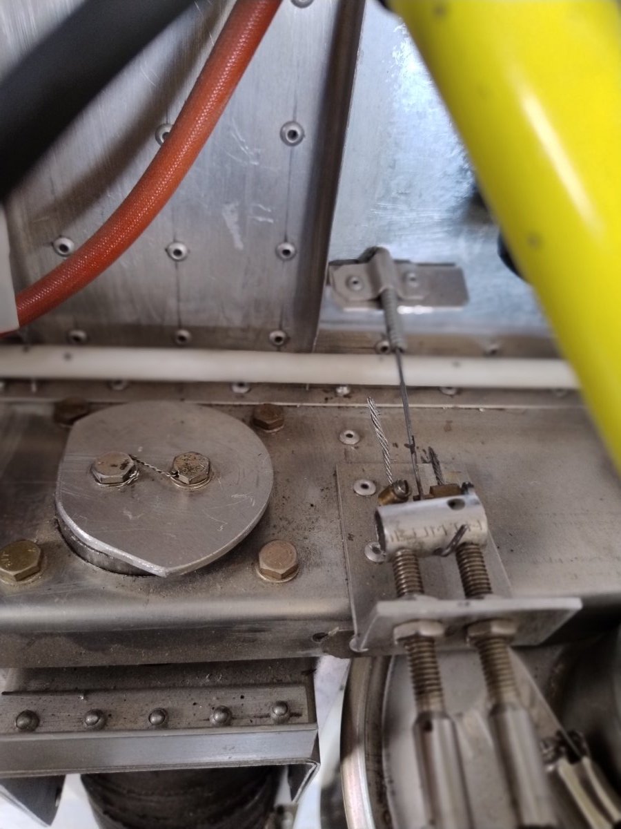

Marty_d Posted March 1 Author Posted March 1 First attempt at lock wiring today. The prop bolts are nice and accessible, not so much the ones at the top of the nose leg... 8 1

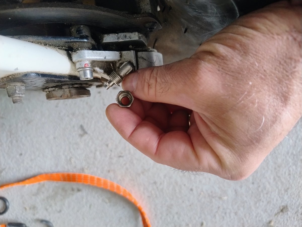

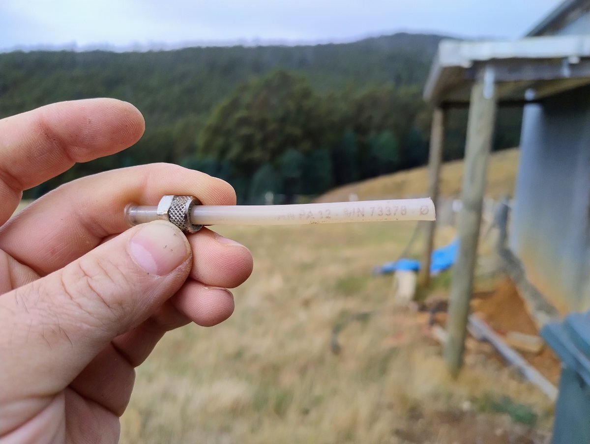

Marty_d Posted March 22 Author Posted March 22 Question for the brains trust. What type of tubing can be (or is generally) used for brake line - and where can I get it? As per the photos my U/c is off a Sav. There's a threaded fitting which looks to hold a tube about 6mm od, around 5mm I'd. Marking on the stub of tube I pulled off the cylinder says PA12 DIN 73378. It appears to have a flange at the end but I'm not sure if manufactured that way or formed by the clamping action. Been googling but no luck. Any thoughts? 1
Moneybox Posted March 22 Posted March 22 2 hours ago, Marty_d said: Question for the brains trust. What type of tubing can be (or is generally) used for brake line - and where can I get it? As per the photos my U/c is off a Sav. There's a threaded fitting which looks to hold a tube about 6mm od, around 5mm I'd. Marking on the stub of tube I pulled off the cylinder says PA12 DIN 73378. It appears to have a flange at the end but I'm not sure if manufactured that way or formed by the clamping action. Been googling but no luck. Any thoughts? Marty, I can't be sure but with this plastic hose it usually has a hollow ferrel up the inside to prevent it squeezing in and then an olive over the outside that compresses between the nut and the fitting it fastens to. Mine are tiny, 4mm OD tube so I bought original tube and fittings from Evektor in Europe just because I had other parts coming. If I need anything tubular air and hydraulic I think Coupler's in Malaga, WA are as good as any place to get this sort of thing. I just went there with the brake fittings off Ripper, my 1980 grader. IT took them about two hours to replicate the flexible hoses that were imperial thread and they supplied all the tube and tube nuts at the same time. Pretty much blew the budget but I got exactly what I needed. https://couplers.com.au/ 2
Thruster88 Posted March 22 Posted March 22 6 hours ago, Marty_d said: Question for the brains trust. What type of tubing can be (or is generally) used for brake line - and where can I get it? As per the photos my U/c is off a Sav. There's a threaded fitting which looks to hold a tube about 6mm od, around 5mm I'd. Marking on the stub of tube I pulled off the cylinder says PA12 DIN 73378. It appears to have a flange at the end but I'm not sure if manufactured that way or formed by the clamping action. Been googling but no luck. Any thoughts? It is important to get the correct tube, the wall thickness has to be right for the connector to work. The nut squeezes the tube against the inner piece on the caliper or master cylinders. Look up the type of brake system you have, Matco, etc, they should have the tube type listed in the parts. Also important to use the correct fluid for your system. Most aircraft use red hydraulic oil or ATF. Some use automotive brake fluid. The seals are not compatible with the wrong fluid. 2 2
IBob Posted March 22 Posted March 22 Marty, I believe it's exactly the same stuff that is commonly used for small industrial pneumatics. The offcut I have is a snug 4mm ID and 6mm OD. The way that fitting works is you push on the tube, then when you do up the nut, it squeezes the tube in such a way as to form the olive at the end. You may want to practise and count your tightening turns: it is easy to apply too many turns and if you do it tries to pull the olive off the end of the tube. And there is nor real 'feel' to it: if it finally starts to feel tighter, you've probably gone too far. 2
IBob Posted March 22 Posted March 22 PS as noted by Thruster88 you need to use the right oil. My Sav manual states that it must be mineral based oil NOT synthetic. 2 1

Moneybox Posted March 25 Posted March 25 On 22/03/2025 at 8:25 AM, Marty_d said: Question for the brains trust. What type of tubing can be (or is generally) used for brake line - and where can I get it? As per the photos my U/c is off a Sav. There's a threaded fitting which looks to hold a tube about 6mm od, around 5mm I'd. Marking on the stub of tube I pulled off the cylinder says PA12 DIN 73378. It appears to have a flange at the end but I'm not sure if manufactured that way or formed by the clamping action. Been googling but no luck. Any thoughts? Marty, Take a look at Page-33 in SP issue 111. HP Aviation hoses. 2
