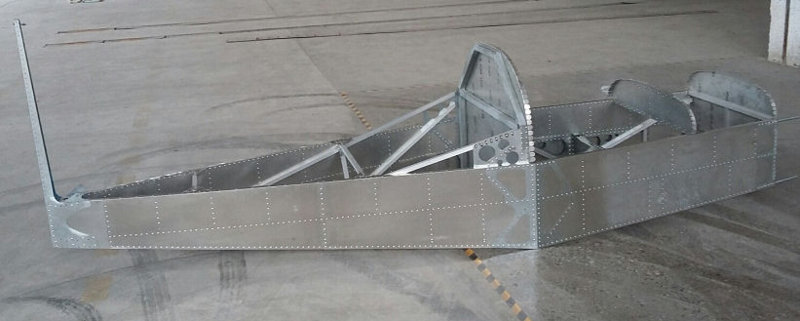

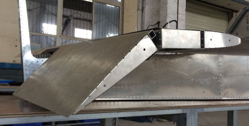

bexrbetter Posted February 15, 2017 Author Posted February 15, 2017 So I threw the sides on today, gearing up for a fuselage load test sometime soon ... 6 1

rgmwa Posted February 18, 2017 Posted February 18, 2017 [ATTACH=full]48530[/ATTACH]Over the next week you will get a better impression as more external panels get fitted.. Bex, I feel I should warn you that while your chief designer is a well known nuclear specialist, his credentials as an aircraft designer may be suspect. rgmwa 2

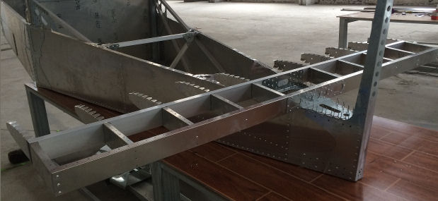

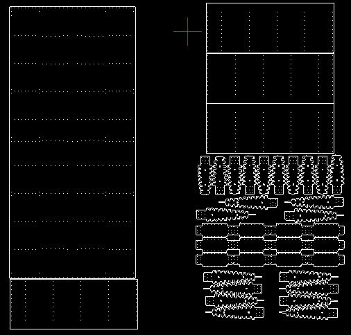

bexrbetter Posted February 20, 2017 Author Posted February 20, 2017 So just sitting around waiting for the rear wing (HS) to be lasered as we speak ... 2

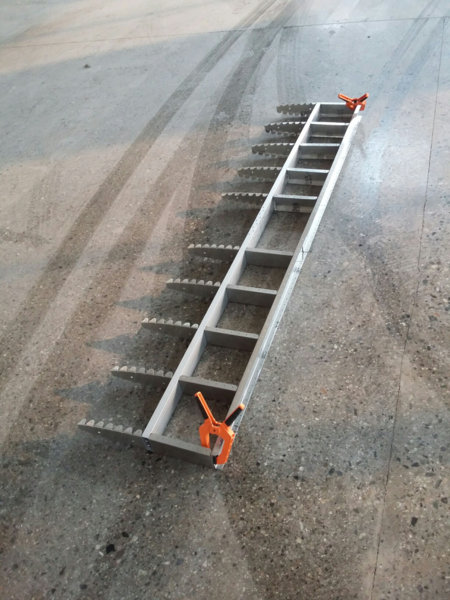

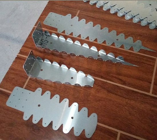

bexrbetter Posted February 20, 2017 Author Posted February 20, 2017 So got back to the shop with the parts. I also made dies to fold the ribs around and it worked better than I hoped first time out, wish it was always like that. 3

bexrbetter Posted February 20, 2017 Author Posted February 20, 2017 Got to love lasercutters What I love is if you change a part later, new design or damaged, you merely remove the old part and the new part fits perfectly back onto the old rivet holes such is the accuracy of the computer file and laser cut. Doesn't matter how good you think you are with measuring, a pinpunch and drill, you can't get close to the same accuracy. 2

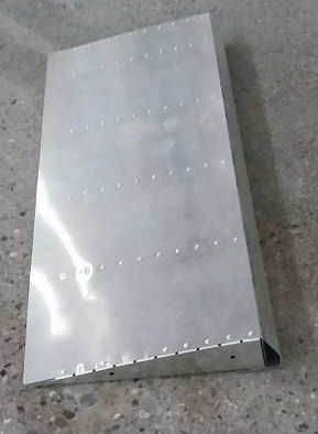

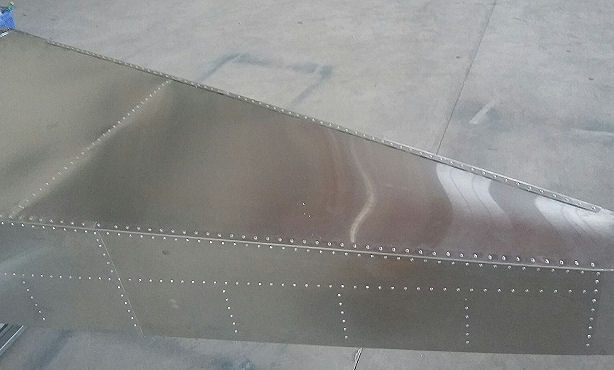

bexrbetter Posted February 20, 2017 Author Posted February 20, 2017 Laser cut and fitted the rear floor panel yesterday.Happy with the way I folded the tops and bottoms of the sides over the longerons so that the floor simply slips in between the lower longeron and the side. This also adds strength with negligible weight, and looks better on the corners. Took a quick snap of the fitted floor. There is only ever 3rd rivet in and no X braces yet, so a bit wavy still ... 4

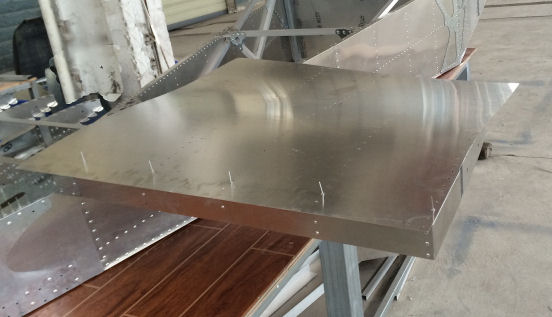

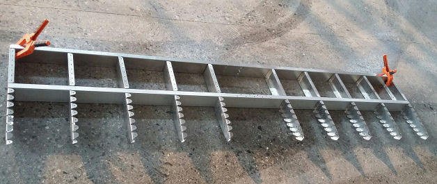

bexrbetter Posted February 23, 2017 Author Posted February 23, 2017 So getting the horizontal stab and elevator together these days, and another picture of the rear floor with a few more rivets in it ... 8 1

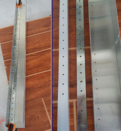

bexrbetter Posted February 24, 2017 Author Posted February 24, 2017 I keep a couple of lasered strips with pilt holes around for this purpose, clamp the strip on the part, or parts to be joined, drill the pilot holes then drill to whatever size you want and end up with a straight, evenly spaced rivet line ... 4

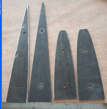

rgmwa Posted February 24, 2017 Posted February 24, 2017 I also made dies to fold the ribs around and it worked better than I hoped first time out, wish it was always like that. What did you make the dies our of Bex? rgmwa
bexrbetter Posted February 24, 2017 Author Posted February 24, 2017 What did you make the dies our of Bex?rgmwa 2 x 5mm steel plates (lasered, matching bolt holes with the rib) sanded a radius on the inner edge, works a treat. Plastic hammer, and Robert's your Uncle. 4 1

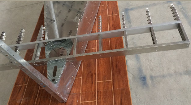

bexrbetter Posted February 25, 2017 Author Posted February 25, 2017 The HS is coming together bit by bit ... and the steel dies for the ribs I mentioned above .. 4

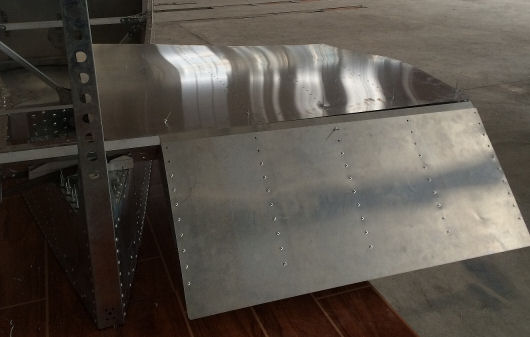

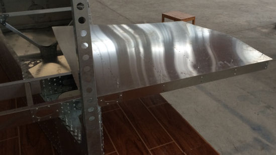

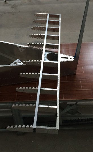

bexrbetter Posted February 26, 2017 Author Posted February 26, 2017 Sorting out the mounts, sheeting and elevator hinging, it's all just slapped together here and very NOT finished ... 6
