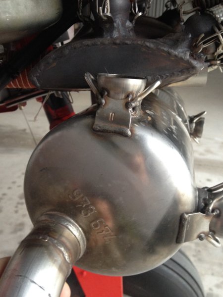

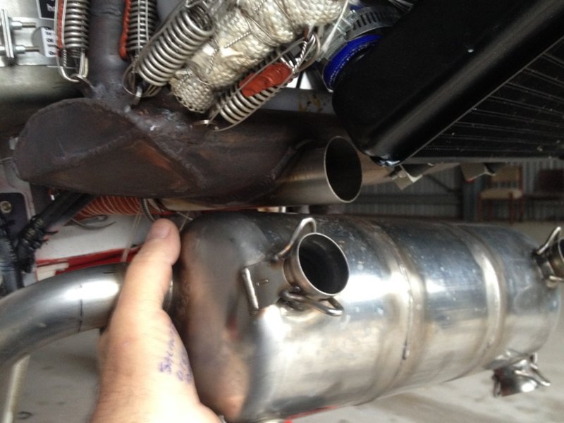

Kyle Communications Posted July 16, 2015 Author Posted July 16, 2015 Geoff13 kindly lent me his Rotax muffler and I did some prelim work at how I might fit it. I took a couple of pics to show the difference in size of the ICP one and the genuine Rotax one, you can see the massive size difference. The rear pilot side will be a bit of a issue trying to get the exhaust pipe down to the muffler the front ones will need a different shape but should be easy and the rear pax side should go straight on. I got some pricing on the net so I can make up new pipes...holy crap the fittings are expensive to go into the Rotax head and the muffler end then you get the pipe and bend it and weld the fittings how you need. Most complete standard kits will need modifying to put into the Sav and a full kit is about $1000 US I am thinking seriously now of trying the 2 into 1 pipe on each side of the engine and exhaust it under the floor it will be a easy try except as Cuz suggests that the engine will need to be rejetted in the carbs. I will look at it a bit more this weekend to see what will be the best way to approach it Mark

Geoff13 Posted July 16, 2015 Posted July 16, 2015 I have a doughnut and I think a couple of other bits you can have Mark. The muffler came with 2 but we only needed the one to make it work.

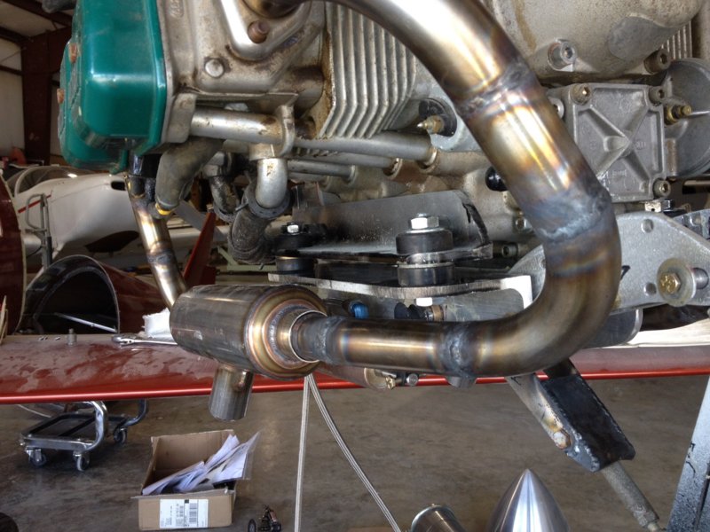

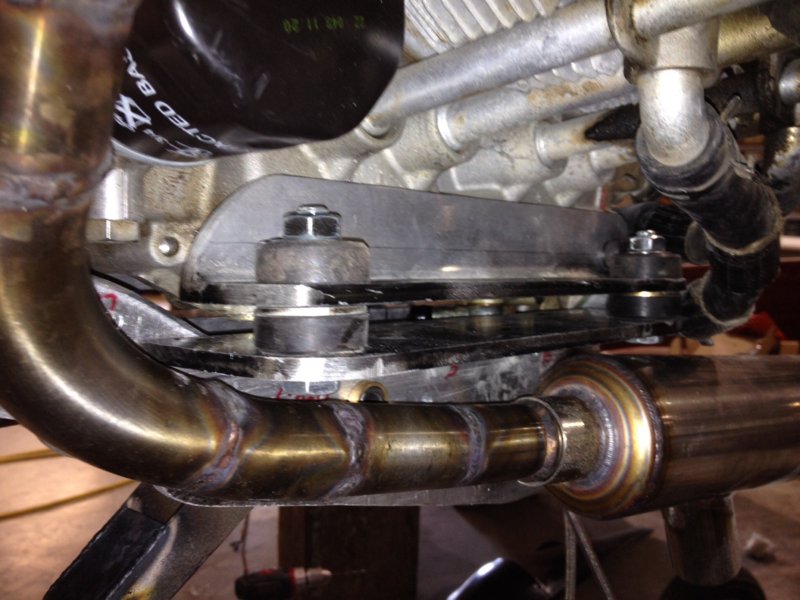

flyvulcan Posted July 17, 2015 Posted July 17, 2015 On our Lightning Bug fitted with a 912ULS, we have used the Downwind Technologies Toucan system. I cannot report on whether it has any effect on power because it is too early in our test flying phase to determine how the engine is really performing but it is certainly quiet. Here are some pics that might give you some ideas. The routing of the pipes is flexible. As you can see, we had to do a lot of cutting and welding to get our pipes to fit within the very tight engine bay of the Bug. Now that we know the routing for the pipes, we shall be able to get custom pipes fabricated to remove all the welds that are in the current system. Using the two smaller mufflers has given us more flexibility than using the single larger muffler which we simply didn't have space for.
