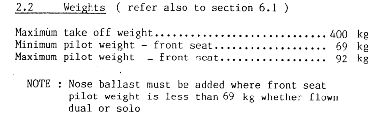

shafs64 Posted January 12, 2014 Posted January 12, 2014 just wanted to know what would be the maximan allowable weight of the front seat pilot. in a drifter
Guest Maj Millard Posted January 12, 2014 Posted January 12, 2014 Don't have the book in front of me , but from memory it's around 68-69 KGs .................Maj....

SDQDI Posted January 12, 2014 Posted January 12, 2014 Don't have the book in front of me , but from memory it's around 68-69 KGs .................Maj.... Are you talking max or minimum weight maj? I thought some drifters had a minimum weight of pilot
Guest Maj Millard Posted January 12, 2014 Posted January 12, 2014 I think the minimum is 60 something and the max is around 80 KGs, but don't have the book in front of me,so just guessing really.......I 'm about 69 Kg and I always carried a bit of weight in the front when I flew my 582 CB.....Maj
arielle Posted January 12, 2014 Posted January 12, 2014 Maj M aren't you thinking of the min weight? Let's just say I recall being told that I'd need quite a bit of ballast if I were to convert. Went looking and found a manual for a SB-582, min 65kg, max 95kg front seat, so my memory was not playing tricks.

skyfox1 Posted January 12, 2014 Posted January 12, 2014 My maximum weight is 92 kgsup front in my Drifter but saying that my friend weighs 130kgs and he flies his with no problems at that weight . cheers Geoff.

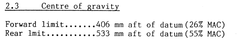

M61A1 Posted January 15, 2014 Posted January 15, 2014 Cut and paste from the SB582 book. FLIGHT CREW AND PASSENGER LIMITS Minimum flight crew One pilot Command seat Front seat Maximum permissible number of persons on board. 2 Minimum load front seat 65 kg Maximum load front seat 95 kg And from the A503- The CoG figure are not right as well, 533mm is not 55% MAC, it's around 33%. Most Drifters fly better with a bit more weight up front. Dunno what's the go with the bold, I turn it off and it comes back as soon as I type.
facthunter Posted January 15, 2014 Posted January 15, 2014 Skyfox at 130 Kgs there would have to be a big difference unless he has put weights down the rear, and I wouldn't dare to recommend it structurally. The plane is significantly altered at weights well below the figure you quote in the way it handles. It would be virtually impossible to stall and it would not be possible to 3 point it. You run out of "UP" elevator. Nev
shafs64 Posted January 15, 2014 Author Posted January 15, 2014 So if the front seat pilots weights say 125 kg. it could be way forward of the COG? what is the empty weight of a drifter. Cut and paste from the SB582 book.FLIGHT CREW AND PASSENGER LIMITS Minimum flight crew One pilot Command seat Front seat Maximum permissible number of persons on board. 2 Minimum load front seat 65 kg Maximum load front seat 95 kg And from the A503- [ATTACH=full]26880[/ATTACH] The CoG figure are not right as well, 533mm is not 55% MAC, it's around 33%. Most Drifters fly better with a bit more weight up front. Dunno what's the go with the bold, I turn it off and it comes back as soon as I type. [ATTACH=full]26881[/ATTACH]
