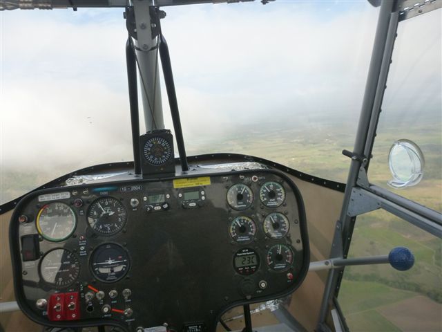

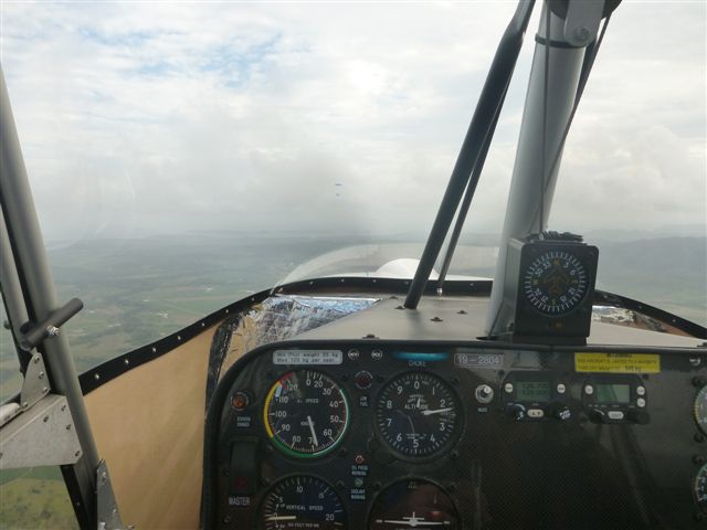

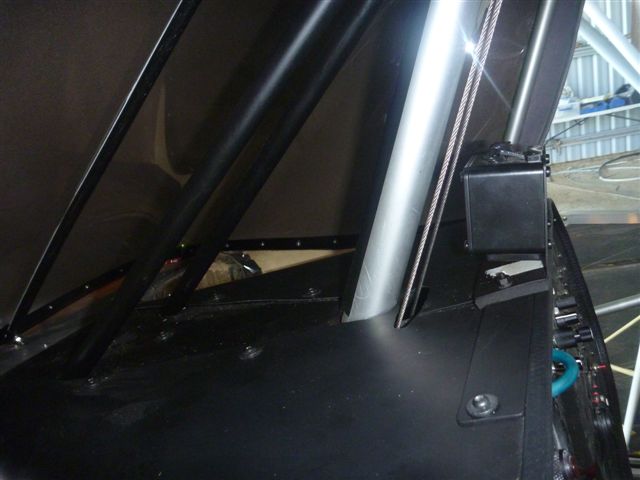

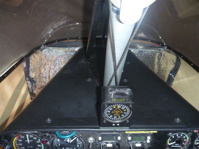

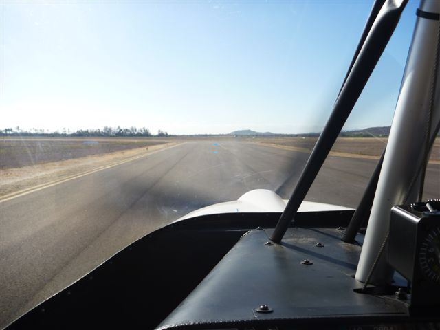

Hi Gary

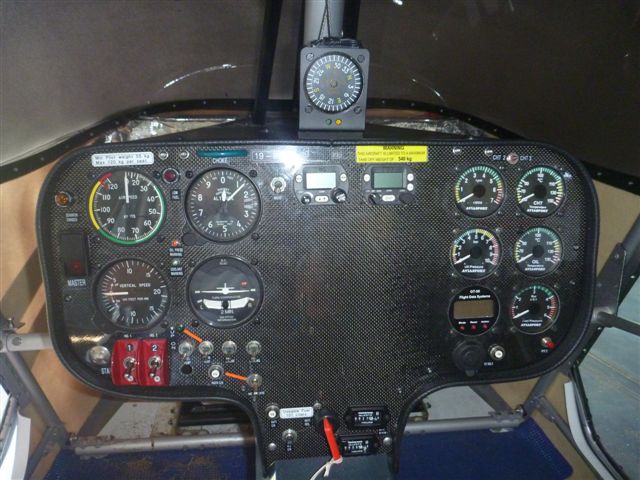

Attached are some better images of the compass installation.
Regards
Mike
Thanks Mike. Very useful.
So you've found that the compass is not being deviated at all by any of the panel electronics.

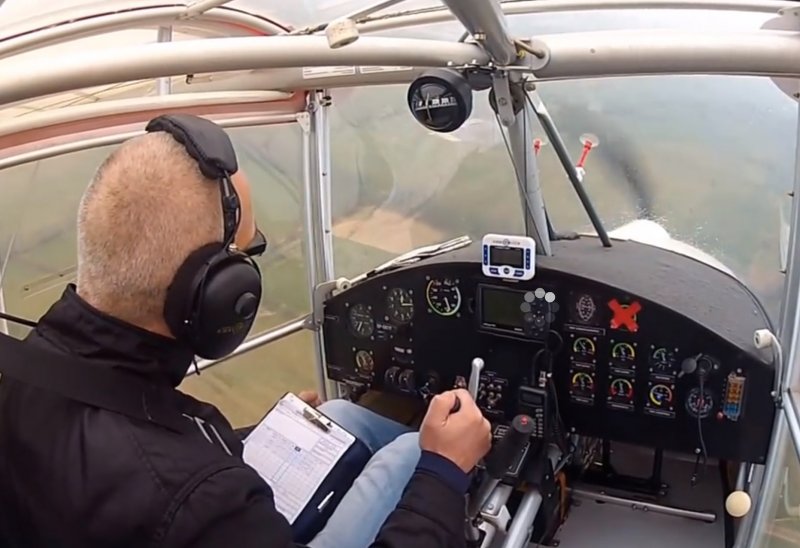

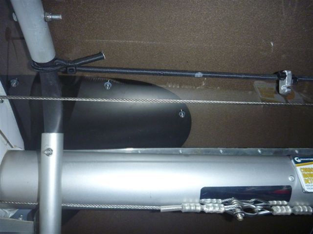

I see that some Skyranger folks place theirs up near the top aileron cable pulley. But that's more suitable for the spherical maritime models than the vertical card type you have.
Anyway your installation looks fantastic; so easily readable there; and the way the vertical ones operate in the 'correct' sense - just like a DG - is fantastic.
Plus, your being able to have total faith in its accuracy now makes it totally useful - as opposed to being the compulsory encumbrance that many are seen as these days.
Nice lay out Garfly.
I get no interferrence at its present location. The two dots under the card are the adjustment screws for the deviation magnets. The green one on the left is the North south orintation adjustment and the yellow on the right is the east west adjustment.

Hi Mike,
Sorry, I didn't make that clear. That's not my SKRA, it's just a pic I grabbed from the internet to illustrate what I was saying about some folks placing their compasses way up there.

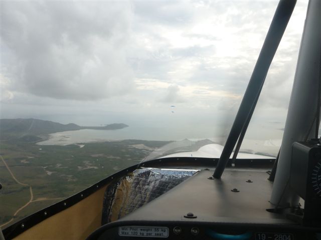

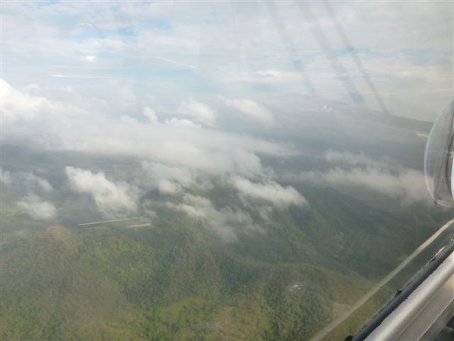

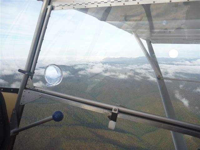

Hi 80Kts
These are some images from the last two flights last week.

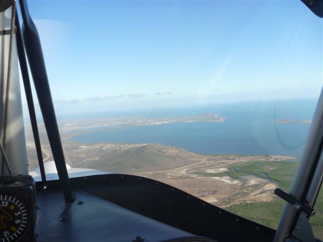

Hi Scott and everyone. Yesterday (Sunday) I fitted the aileron trim (did not have any need to use on the flight) and then D.I'd and took off for my solo nav to Bowen in the Nynja, 92 n/mls each way and set the cruise IAS speed at 80 kts up and 88 back with the head wind effect. (1.1 hrs up and 1.3 return) I could have flown quicker but there was no hurry, used 40 liters of fuel and had 86 liters in tanks. Had a pleasant flight to Bowen and a good run home with cloud building all the time. Some images attached to show what the area is like. I'm totally enjoying fliying the Nynja a great aircraft. Will get to some flyins and other meets next year.
