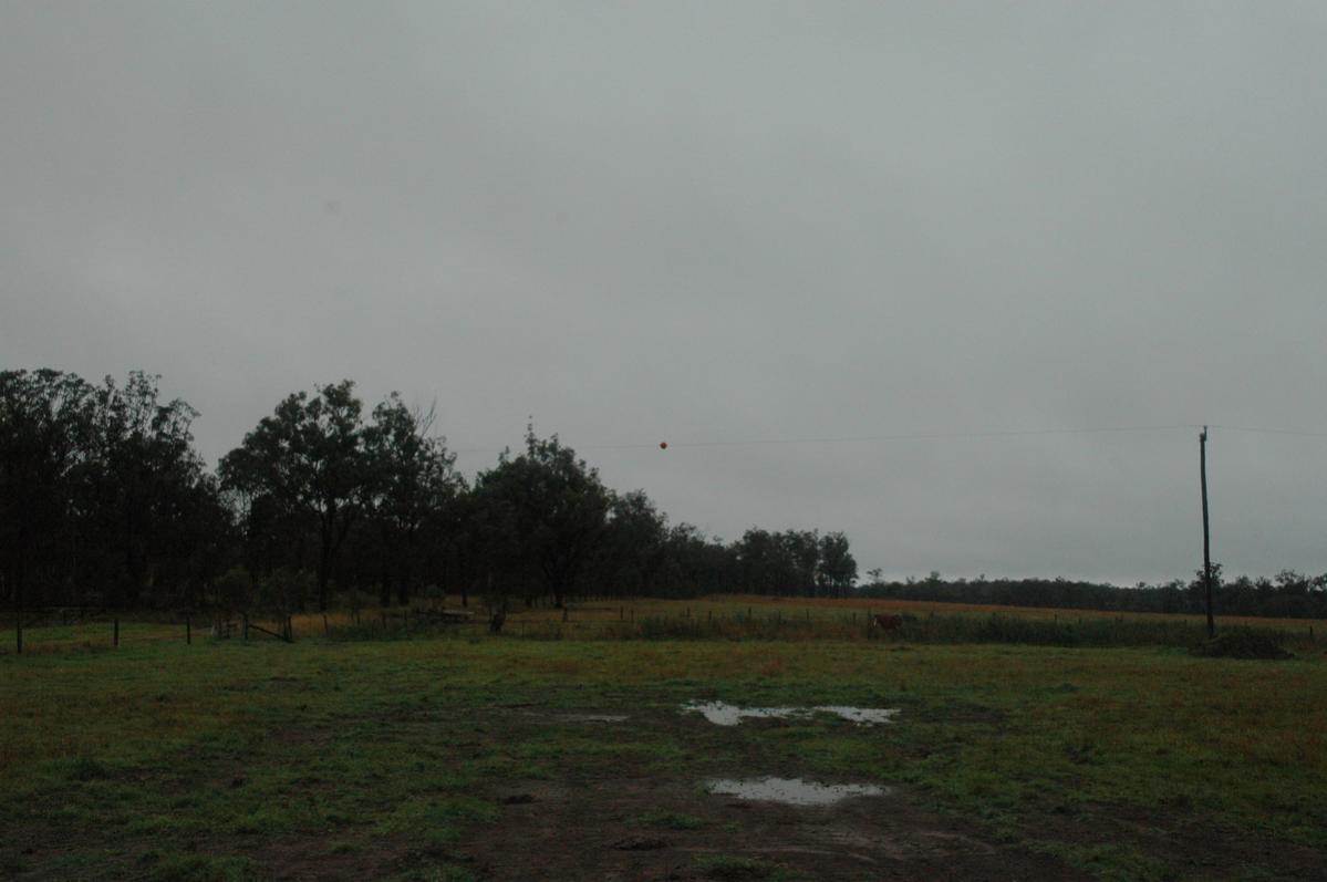

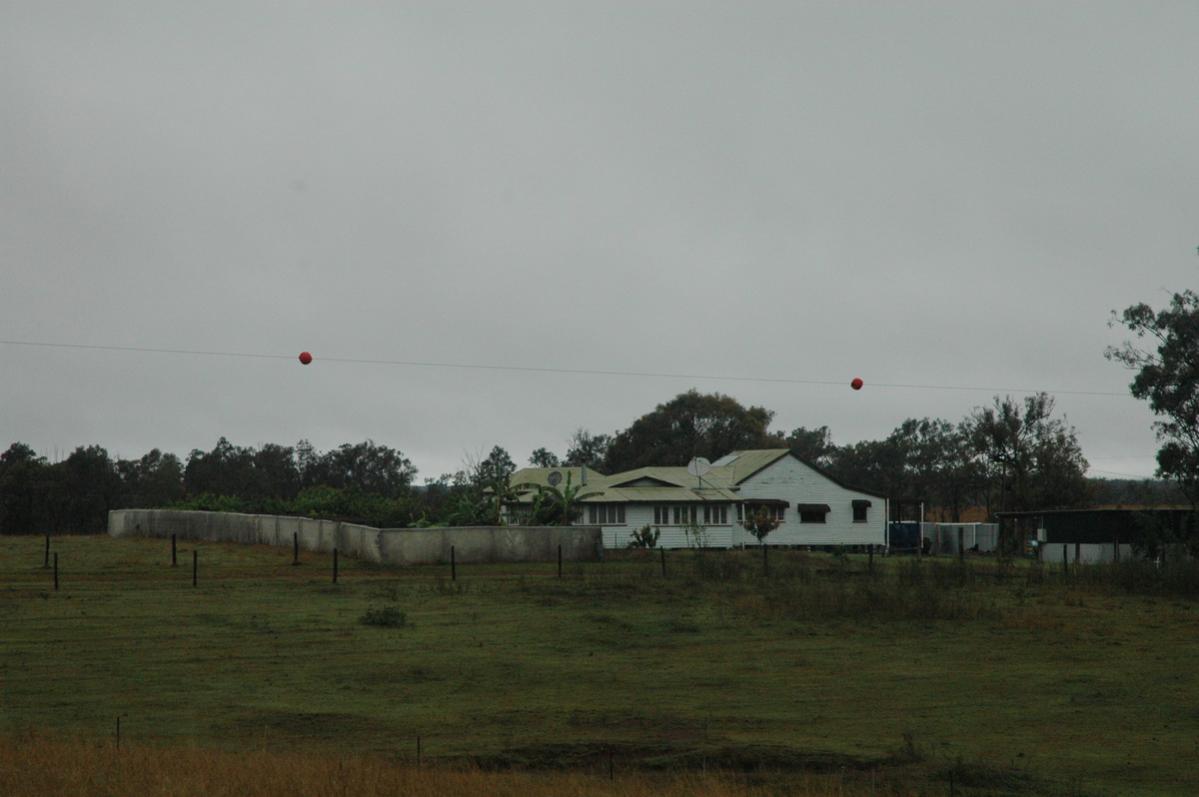

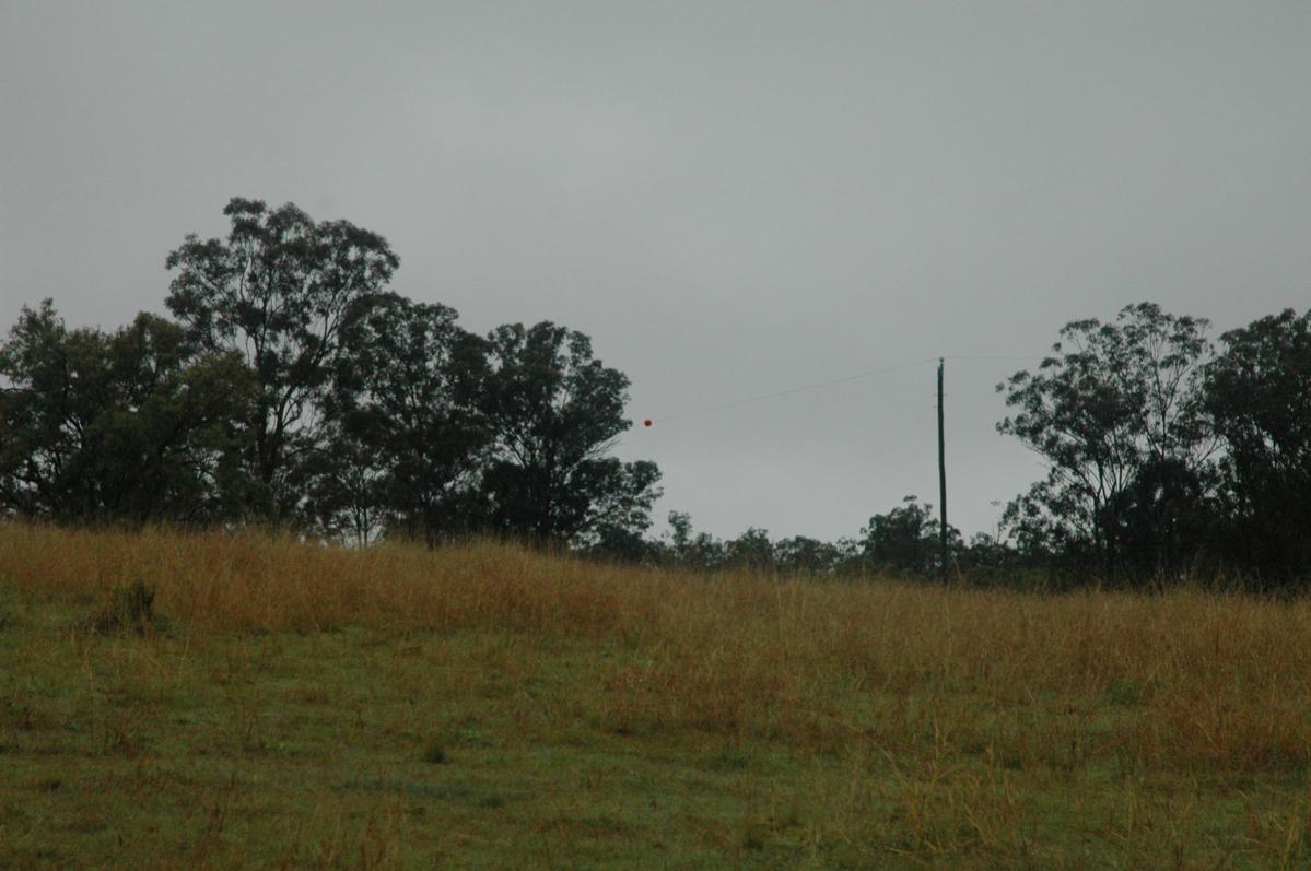

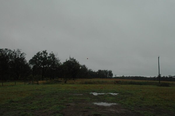

Kyle Communications Posted September 26, 2010 Posted September 26, 2010 WEll I have just gone through this saga. I put 2 of 400mtr long airstrips on my property up at Booyal. Ergon energy are the provider around there. I spent over 10 years working for the SEQEB now Energex as electrical fitter mechanic and the last 2 years I was doing network switching out in the field right up to 66,000 volts. I also did a lot of "linework" etc so I know how the system operated within these organisations. I rang Ergon to get a price on putting 3 balls along the SWER line at the southern end of my property which is about 100 mtrs from the end of my strips. I know where the lines are but others dont so I thought it very prudent to at least have the lines marked for safety and my peace of mind for others who may use the strips. The quote came back as labor $1242.88 Materials 532.13 Capital allowance$ 2175.22 Total inc gst $2392.00 After sending a few emails back and forth and me spewing about 600 bucks for 3 plastic 300mm red balls the job was finally completed some time the before last Monday. I emailed twice to find out when it would be done but got no answer..I waited around 2 months just for the quote from Ergon then its been at least another month but I had to go up to the property last Monday and when I got to the gate I noticed the balls had gone up..they were not there 2 weeks before here are a couple of pics..the angle I took the pics at dont quite show exactly where they are but there is one on my cross strip and the 2 together are on the main strip. My strip goes up and down with a hill in the middle and the house (next door) is about 100mtrs or so past the powerline. This line is quite low due to it being in the gully but I decided to put the balls on it any just to make sure it can be seen. The powerline is at the edge of my property fence. Pics were taken with a telephoto so objects look closer than they appear..you can see by one of the photos where my strip ends and how far away the next door neighbour is. Mark

Kyle Communications Posted September 27, 2010 Posted September 27, 2010 Hi Gibbo Well I can tell you around the Bundaberg Childers area ERGON don't talk anything about being free. As in my post it cost me to get some balls on the SWER line and there was no talk about any other type of markers to be put on the line. Mine is a 11kv swer line and was done by a "live line" crew basically its a insulated cherry picker and they do it with special insulated sticks. I wish they would have done it for free for me and as far as cost price goes $600.00 for 3 of red plastic 300mm balls is pretty steep. I know the line is there but I got it done just for other pilots and in case someone had a emergency and needed to put down on the strips to make sure it will be safe. To be honest I would have preferred the tiger tails spread along the mains but they are not the "approved" type for airstrip identification according to ERGON. They even have special forms for it which I had to fill out and provide distance measurement etc to where the balls had to be placed. I even have a mate who is very high up in the organisation and I had a whinge to him about it...knowing he probably couldn't do anything anyway but at least it made me feel better :)....even he said they charge for everything nowadays because their budgets are so tough they have to make money where ever they can Mark
