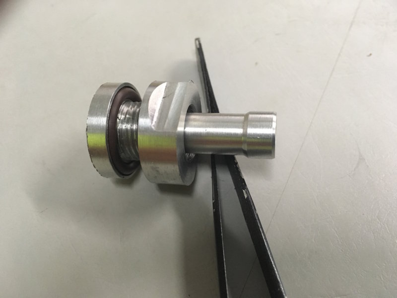

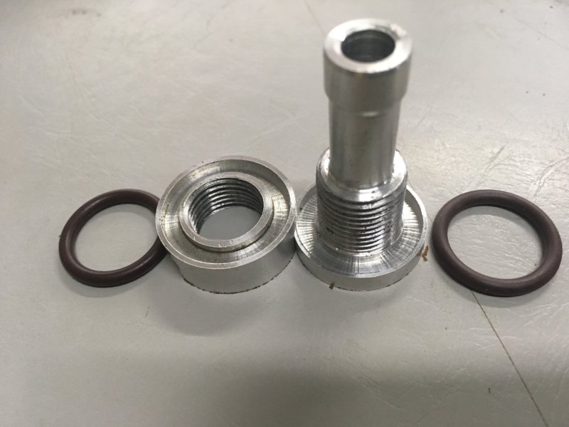

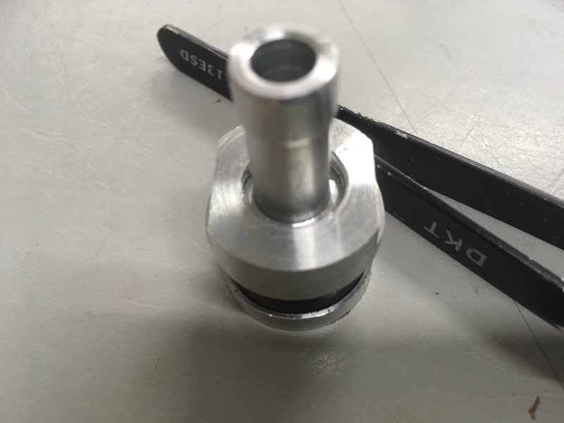

Kyle Communications Posted November 24, 2016 Author Posted November 24, 2016 Not a weakness...just crappy explanations. The inside wall of one of my tanks had a bigger round corner and the measurements they give in the manual which by the way worked reasonable for the other 3 tanks although I did modify them a little after finding this first tank issue. But because my tank was a little larger the fitting wouldnt pull up flush. So had big dramas. Elongated the hole...big mistake but Danny managed to grinding back the inside a little now so the hole has been opened up a little to make it rounder and I have made a fitting up that is now 14mm thread diameter and now I have a Oring either side which will seal off on the inner and outer surface. Oring groove machined into the machined fitting and the nut. Easy to do if you have a lathe. I love haing machinery...and the CNC was used to flycut the sides of the nut

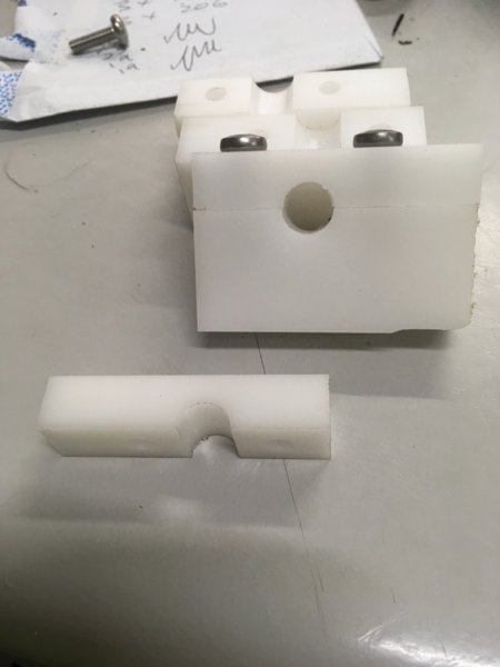

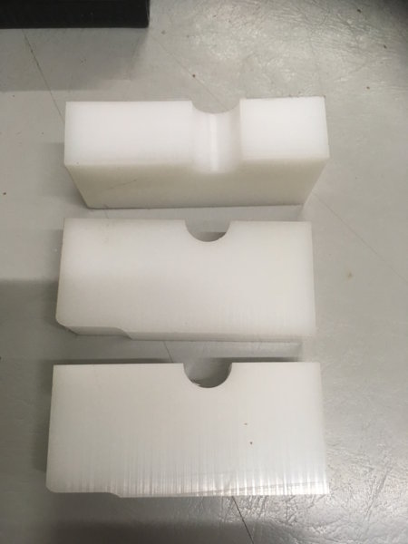

Kyle Communications Posted December 20, 2016 Author Posted December 20, 2016 Throttle blocks have been started. This is the first pass then they get drilled 2
Kyle Communications Posted December 22, 2016 Author Posted December 22, 2016 Got the top of the block machined and now also drilled both. I just need to trial fit to make sure it all fits correctly
IBob Posted December 22, 2016 Posted December 22, 2016 Got the top of the block machined and now also drilled both. I just need to trial fit to make sure it all fits correctly[ATTACH=full]47380[/ATTACH] We may have to set up an account with you over there if this goes on.............)

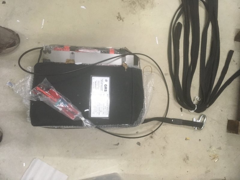

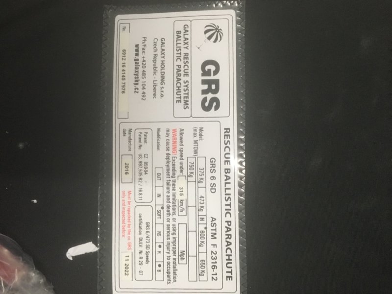

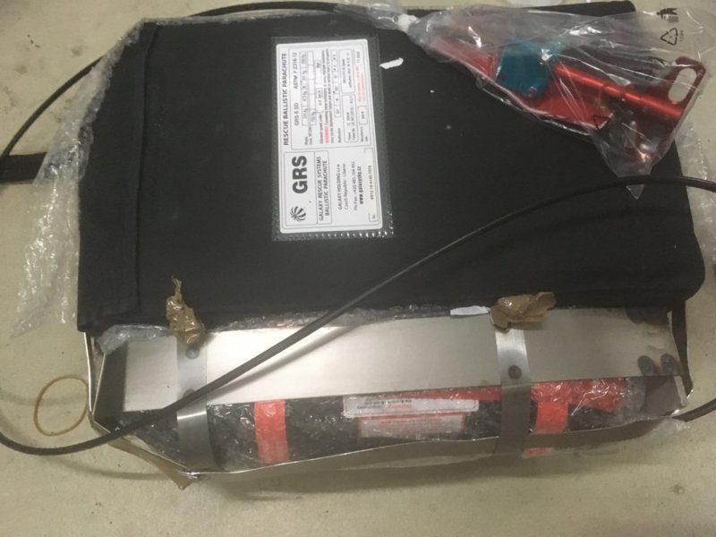

Kyle Communications Posted February 1, 2017 Author Posted February 1, 2017 Well the day has finally arrived. My parachute is here :) now got to fit it which will be interesting especially for my weight and balance. Its a bit of a mission getting "dangerous goods" from Europe to here but its now done and dusted and if I want another one I am much wiser and it will be a lot easier. 3
Marty_d Posted February 1, 2017 Posted February 1, 2017 Hey Mark, that's excellent! I plan to get a BRS for my 701 a little further in the build, so any hints or tips you have on getting one here, would be much appreciated.
Kyle Communications Posted February 1, 2017 Author Posted February 1, 2017 Its a mission but I got lucky too..I also know so much more now on how to do it and WHO can do it. There are special licences required and delivery sites and transport but it is do able if you know the right people now. I will probably leave this one in "the girlfriend" and get another for Mabel when the time comes. Getting 2 in at once and sharing the special freight requirements will save bucks as they can only be airfreighted. AND they can not be sent on any passenger aircraft they must come on air cargo only aircraft. Mine came on a Emirates cargo flight 1
